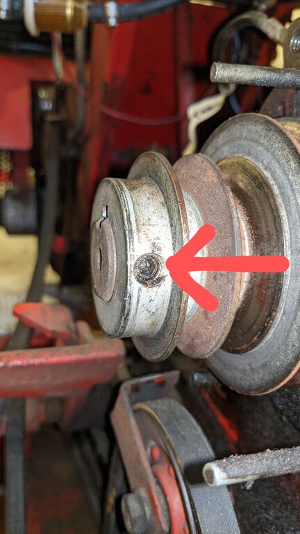

csvt99 173 #1 Posted August 7, 2022 I'm swapping out the 8hp K181 for one of Squonks rebuilt motors on my 877. I have the original motor ready to pull, I just need to remove the pulleys from the crank shaft. I removed the set screw on the outer pulley that aligns with the notch in the shaft. 90 degrees from that is another hex screw with what seems to be a Torx inside of it. Both of those were basically stripped and I couldn't move them. Any suggestions on how to remove? My dad was supposed to help but he got caught up in retirement and taking many vacations and now has COVID (mild fortunately) so I'm just going at it myself 🙂 Thanks! 2 Share this post Link to post Share on other sites

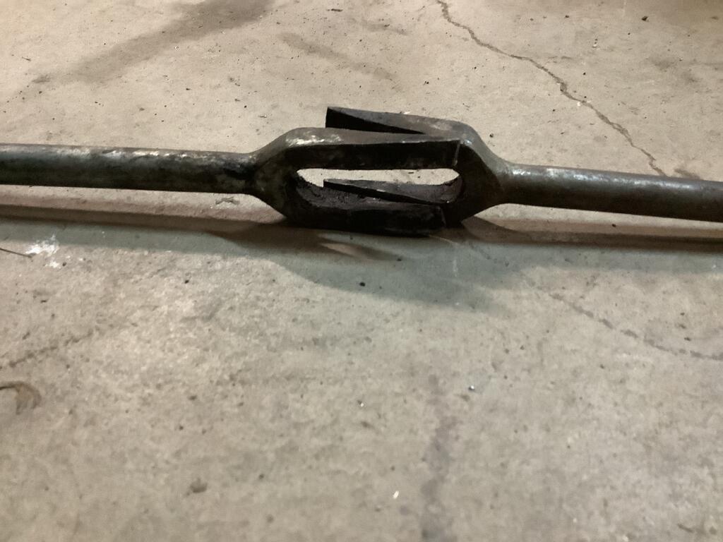

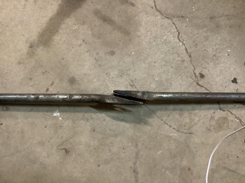

Pullstart 71,516 #5 Posted August 7, 2022 I’ve got these two ball joint pickle forks too. They tend to work wonders. They can usually fit over the crank snout and they become parallel too when stacked. I’ve even paired them with an open end wrench or two once the pulley moves away from the block far enough. Also, it doesn’t apply in your situation, but a strip of Emory paper to polish up the remaining crank snout helps to get it moving. And if I didn’t mention, penetrating oil! 2 Share this post Link to post Share on other sites

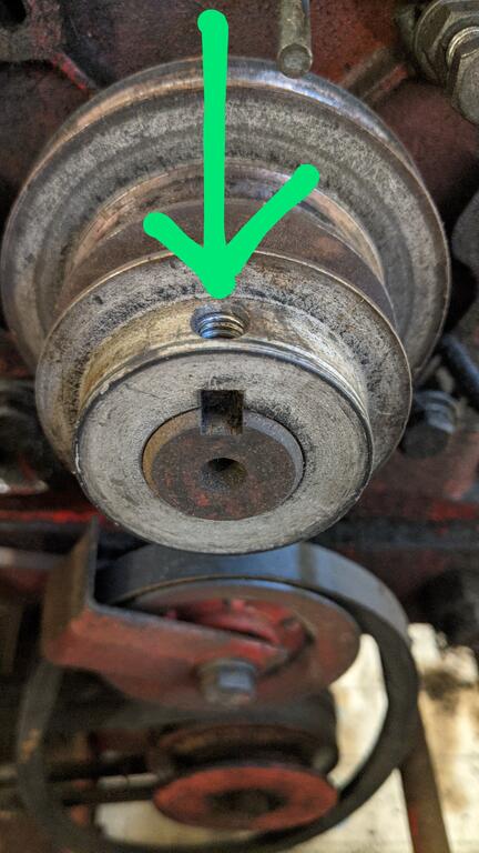

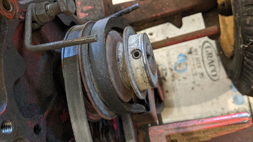

csvt99 173 #10 Posted August 7, 2022 11 minutes ago, squonk said: The pulley will drag that other screw along the crank when it's pulled. And the screw that is stuck won't damage the crank? The picture with the green arrow is the one I got out. The red arrow is the one that is stuck. Share this post Link to post Share on other sites
squonk 48,322 #11 Posted August 7, 2022 (edited) 7 minutes ago, csvt99 said: And the screw that is stuck won't damage the crank? The picture with the green arrow is the one I got out. The red arrow is the one that is stuck. A file and emery cloth will fix up the crank shaft. You can try some heat on that stuck screw if you allen wrench still grips it. Edited August 7, 2022 by squonk 1 Share this post Link to post Share on other sites
csvt99 173 #12 Posted August 7, 2022 Ok, I hit it with the penetrating oil and will try the heat as well. If that doesn't go as planned I will go the other route with the bearing separator and gear puller. I should be able to find what I need between my dad's shop, my farmer friend and the AutoZone down the street. 2 Share this post Link to post Share on other sites

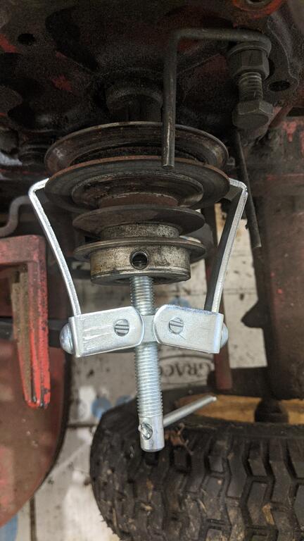

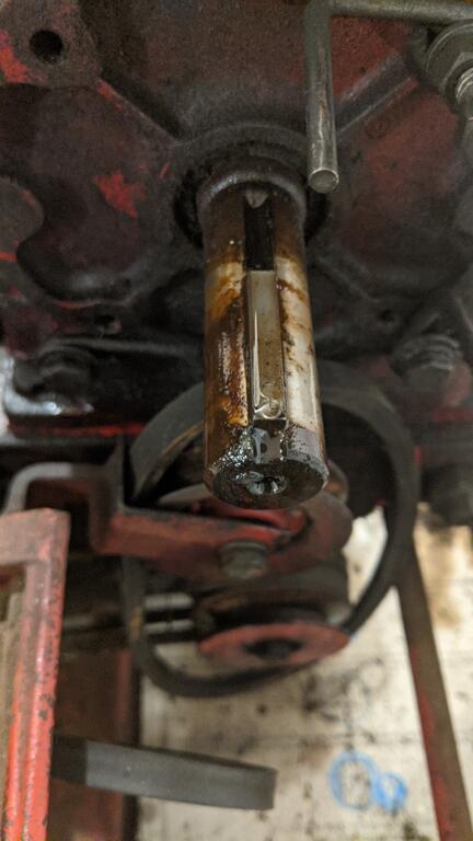

csvt99 173 #16 Posted August 9, 2022 Thanks to you all, I got er done! I let the oil soak, got the heat gun out, and used another hex wrench and was able to break it free pretty easily. Then I found this cheap gear puller I bought for some unknown reason a while ago, and it took the pulley right off. Is the key in there by friction only? Can I just pop it out with a punch? 1 Share this post Link to post Share on other sites
squonk 48,322 #17 Posted August 9, 2022 Key should come out with a punch. Soak it and put a little heat on it. Share this post Link to post Share on other sites
