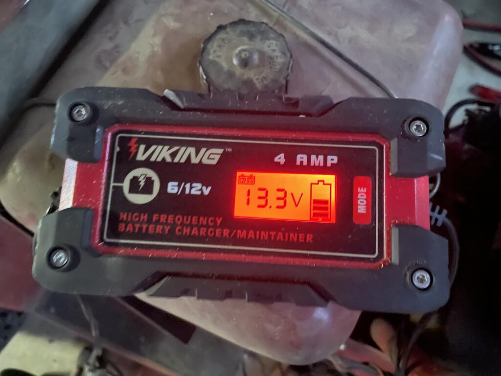

rnphila 5 #32 Posted August 7, 2022 23 minutes ago, squonk said: I would get that battery load tested. 9.5 is quite a drop with just turning the key on and the ignition unhooked. Stranger things have happened. I had a year old battery in a tractor with a battery tender connected. The light on the tender was doing all kinds of strange things. I thought my tender was shot. I bought a new one and it did the same thing. I finally tested the battery and it was bad. Interesting, I’ll check it at the shop where I got it. This gave me an idea, charging it is right now. Share this post Link to post Share on other sites
Handy Don 17,316 #33 Posted August 7, 2022 If the battery has at any time been heavily discharged, i.e. down to 5 or fewer volts, then it may no longer be able to take a full charge--this is regardless of age. It could well show 12v to a meter but as soon as it has a load put on it, even a small one, the voltage falls off a cliff. Have you tried using jumper cables to a car or truck direct to the battery and then try to start the tractor? 1 Share this post Link to post Share on other sites
