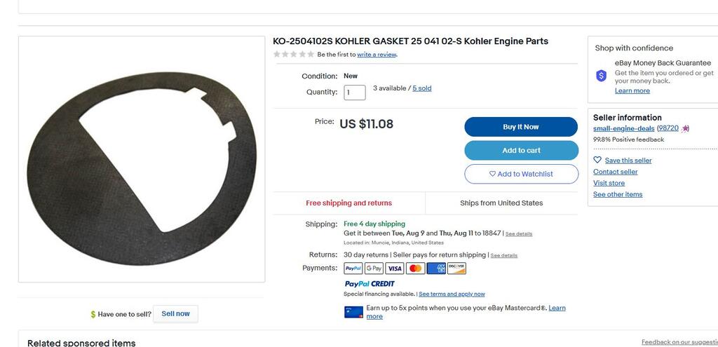

pfrederi 21,302 #1 Posted August 5, 2022 How important is the splash guard/gasket (2504102). They are not used in many Walbro carbs or in any Techy carbs. Reason I ask is cost. You can by the bowl gasket for $2-3. But the splash things costs $6-8 or more. Not a big deal for one but when you have 20 WHs.... 1 Share this post Link to post Share on other sites

Handy Don 17,671 #10 Posted August 6, 2022 I've used both Kohler OEM and off-brand carb kits--both with splash guards. The OEM was slightly thicker material. 4 Share this post Link to post Share on other sites
rmaynard 17,642 #11 Posted August 6, 2022 (edited) I always put in a splash guard for the reasons mentioned above. $5.00 (delivered) is a much more reasonable price. Edited August 6, 2022 by rmaynard 1 Share this post Link to post Share on other sites
formariz 12,381 #12 Posted August 7, 2022 From the Brian Miller site: FYI - The fuel baffle/splash shield prevents fuel inside the float bowl from traveling up through the atmospheric vent opening (air passageway into the float bowl) and into the throttle bore when the engine is "moving around" or "moving up and down" severely, such as on a go-kart, garden tiller or small all-terrain vehicle, which could cause the engine to momentarily run rich on fuel. 3 1 Share this post Link to post Share on other sites
