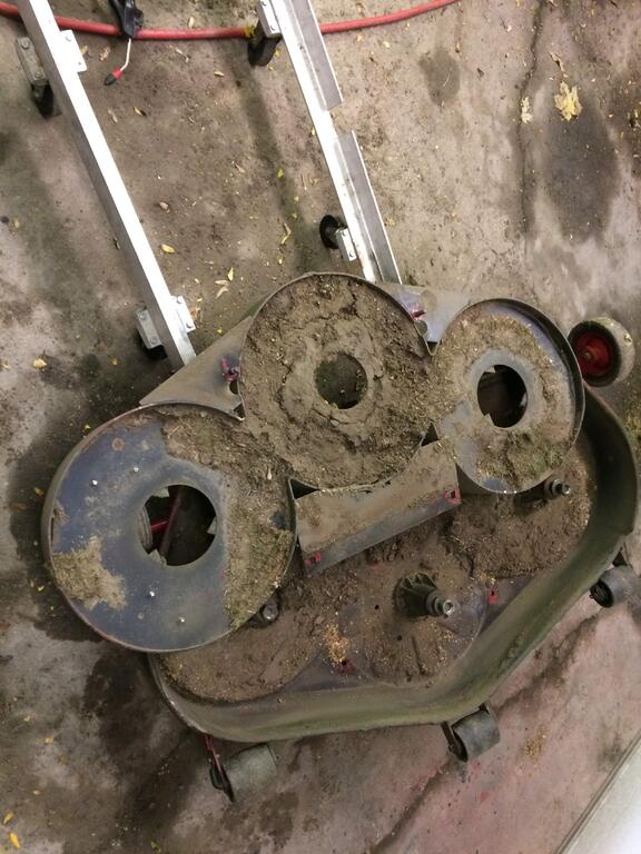

grinchsr 674 #1 Posted August 5, 2022 Just picked one up and was looking for opinions from anyone using one. Pros and cons and what is the value of these decks? I already removed the insert and cleaned the 5 pounds of clippings that was stuck up there. I am sure that is one of the cons. I may just use it as a RD deck 1 Share this post Link to post Share on other sites

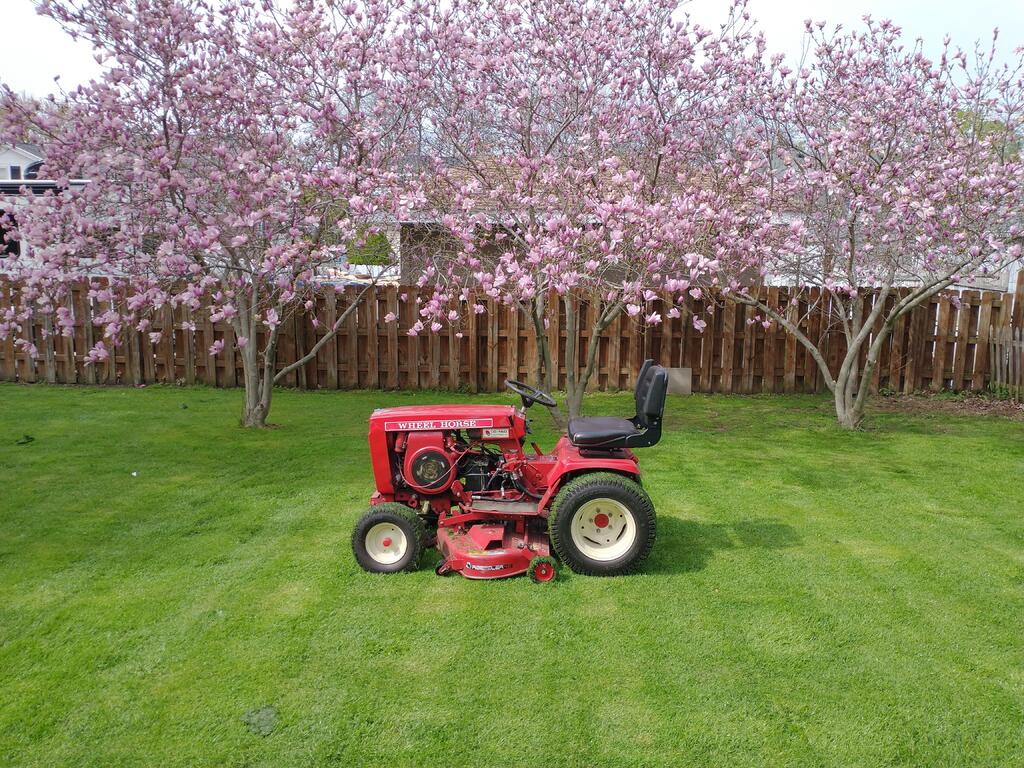

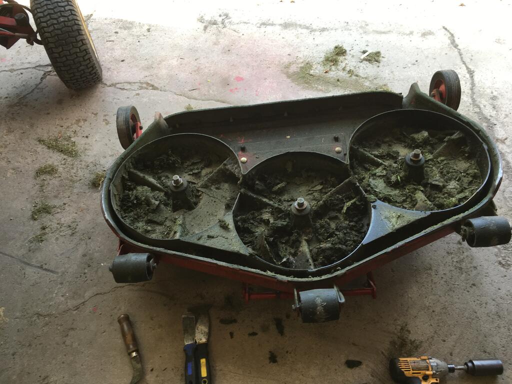

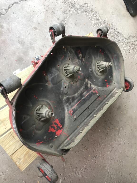

squonk 47,887 #3 Posted August 5, 2022 Love my recycler deck. Use it all year with the insert. Really depends on your grass. My front yard isn't thick so I can mow on the 2nd lowest setting. Back yard I have to raise it a notch or it will clump some like Nylyon said. Yes you have to take the insert out to clean behind it a couple of times a year but the insert protects the deck shell. I used to have a Beagle that would eat the grass clippings and get sick every time I mowed. I had to get the sweeper out every time. Once I got the recycler, No more sweeping! This is a normal buildup of grass Normal build up of grass between insert and deck I have owned this deck about 8 years. I treated the deck with bedliner when I bought it. This is what the deck still looks like. I haven't had to touch it until this spring (you can see the bedliner peeled away in a couple of spots) and no grass has ever stuck to it 1 Share this post Link to post Share on other sites

squonk 47,887 #5 Posted August 5, 2022 Every winter and spring I look at my back yard and all the mud. It gets torn up by to rambunctious hounds. I fear it will never come back. But it does greener and thicker every year. I do not do anything to it but mow it. I credit it to the recycler. Share this post Link to post Share on other sites
