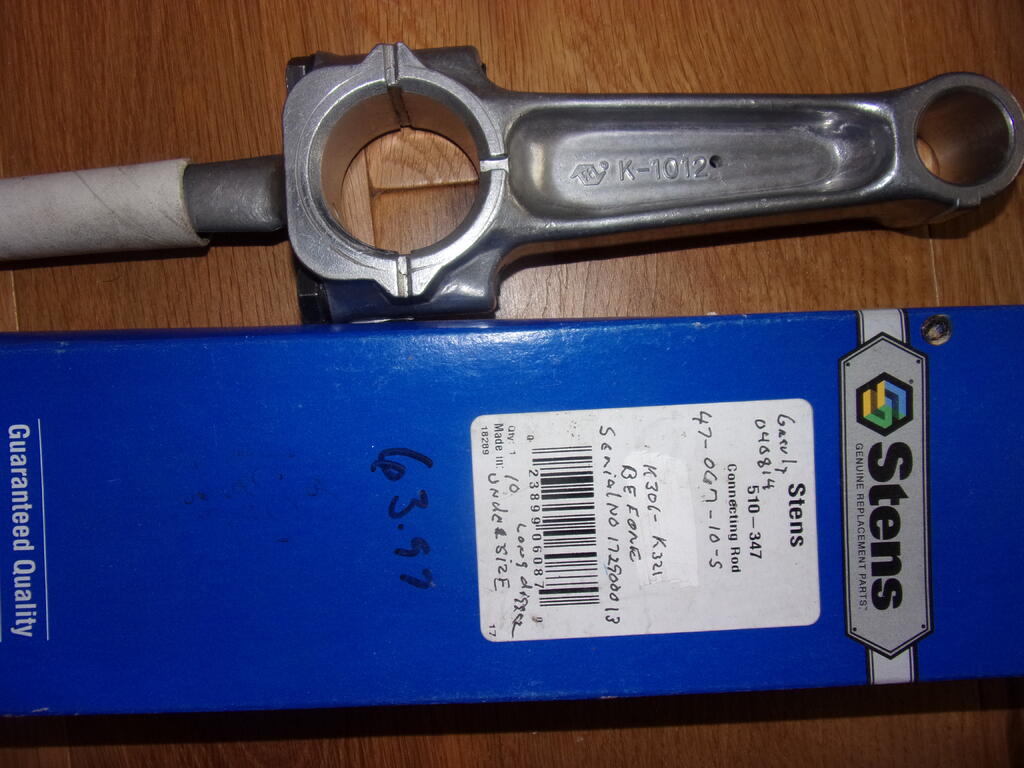

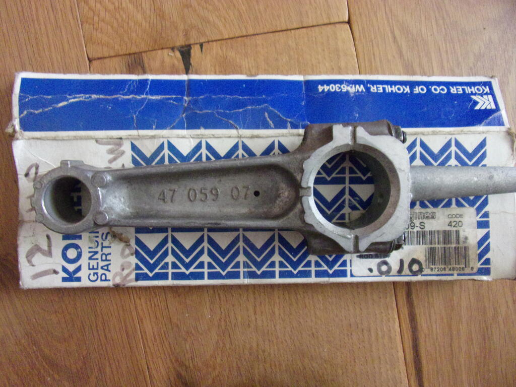

Ed Kennell 44,887 #6 Posted August 4, 2022 19 hours ago, 953 nut said: @Ed Kennell has a batch of NOS Kohler parts Here are the two NOS rods that I have. If interested, send me a PM for more info. @mrc 1 Share this post Link to post Share on other sites
