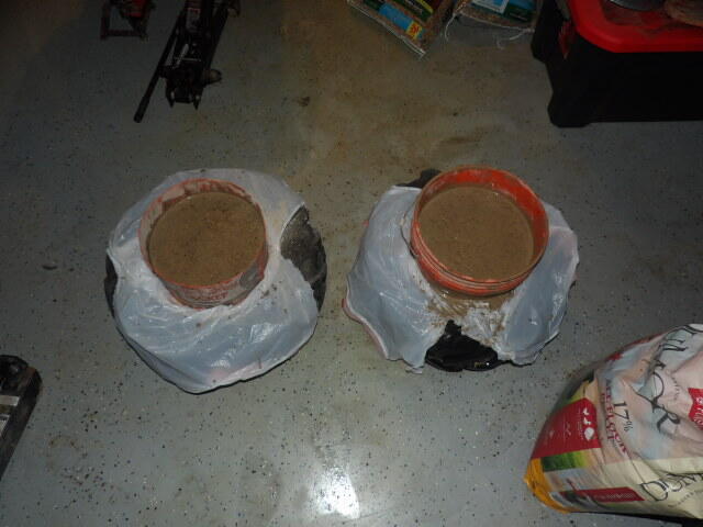

Jeff-C175 7,211 #1 Posted August 3, 2022 (edited) I had some left over brake parts from my VW and thought I could put them to use as wheel weights. A lot of recycling / re-using going on here! The buckets used to be recycling buckets from before the days of 'single stream' automated collection. BY THE WAY... for anyone thinking of doing this... You MUST leave some clearance between the bucket and the wheel. I used a strip of corrugated cardboard between the bucket and the wheel while I was fabricating. This gave me about 1/8" clearance. You don't want these so tight that they have to be forced in and out of the wheel. ALSO... I noticed that the buckets 'ovaled' a little bit after pouring the concrete. It's probably a good idea to add the 'fillings' while the bucket is still in the wheel WITH the cardboard spacer. ESPECIALLY if you are using the thinner 5 gallon pails as your casings. The buckets I used are quite a bit heavier duty than drywall compound or paint buckets so it didn't deform enough to cause a fitting problem. Started by cutting down some old plastic buckets. Added a bunch of pop rivets to hold on to the concrete later. There were also pop rivets in the bottom but didn't get a pic of that. Cut some 1/2" copper pipe for the bolts to pass through. Yeah, I know... could have gotten by with just two. Ran a bead of hot glue around the bottom (not shown in pic) to hold them in place until filled with 'crete. Bent up the handle from the bucket to embed in the 'crete. Make sure they're high enough to leave some knuckle room. Had to notch out the discs and drums I embedded in the 'crete in order to clear the bolt tubes. Easiest way I found to do this was to use cutoff wheel to make radial cuts and score the 'horizontal' part and whack it with a hammer to break out the notch. Drum went in on top of a bed of concrete. Hadn't poured the 'crete in this pic, still test fitting... Disc gets embedded on top with surface flush with top edge. Here it is shown for test fit purposes. And finally, the 'almost' finished product. Still need to cut the copper tubes flush with the top surface. Use a flat washer under the bolt in order to put the pressure on the brake disc rather than the end of the copper tube. I also added some more metal scrap inside between the drum and the disc since steel/iron weighs a bit more than concrete. They came in at 40 lb each. Adequate for my needs. The only money I spent was for the bag of concrete. Everything else was 'in stock', recycled / re-used. Not bad, 40 lb wheel weights for under 10 bucks! If I did this again, the only thing I would do differently is to make them 8" tall rather than 6". I could have gotten to at least 50 lb and added more scrap iron inside. But I'm happy with how they turned out. Edited August 3, 2022 by Jeff-C175 8 10 Share this post Link to post Share on other sites
