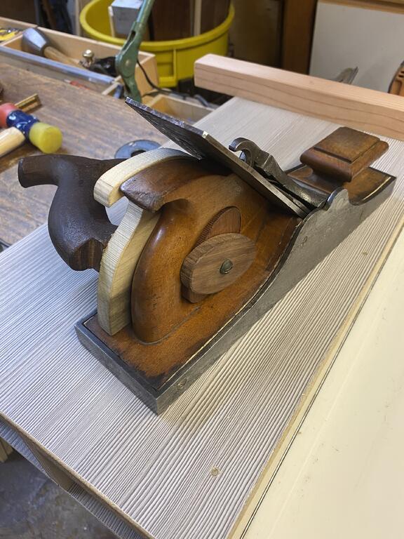

953 nut 68,201 #26 Posted August 3, 2022 1 hour ago, formariz said: You are warming up on the principle of it. No handsaw. Would it be used to hold a smoothing plane while on a vertical surface to reduce wrist fatigue? Share this post Link to post Share on other sites
formariz 12,381 #27 Posted August 3, 2022 14 minutes ago, 953 nut said: Would it be used to hold a smoothing plane while on a vertical surface to reduce wrist fatigue? Warmer , no smoothing , no vertical surfaces. Share this post Link to post Share on other sites
8ntruck 9,178 #28 Posted August 4, 2022 Some sort of miter box accessory? Share this post Link to post Share on other sites
formariz 12,381 #29 Posted August 4, 2022 (edited) 13 minutes ago, 8ntruck said: Some sort of miter box accessory? Not a miter box accessory. But it and it’s companions definitely could be used on something coming out of a miter box. Edited August 4, 2022 by formariz Share this post Link to post Share on other sites
8ntruck 9,178 #30 Posted August 4, 2022 Ok. Is it some sort of work piece holder/positioner? Does the hook work in conjunction with the oval stand off and turnkey thing? Share this post Link to post Share on other sites
formariz 12,381 #31 Posted August 4, 2022 3 minutes ago, 8ntruck said: Ok. Is it some sort of work piece holder/positioner? Does the hook work in conjunction with the oval stand off and turnkey thing? It is “some sort of holder” of something else. Hook is just “conveniently “ cosmetic. Hint—- notice similarity of piece containing “hook” to another part? Share this post Link to post Share on other sites
8ntruck 9,178 #32 Posted August 4, 2022 The hook kind of looks like the leftover from cutting out a saw handle. The oval fittings on the back kind of look like the hand hole in a saw handle. A fixture to aid the manufacture of a saw handle, perhaps? 1 Share this post Link to post Share on other sites
formariz 12,381 #33 Posted August 4, 2022 13 minutes ago, 8ntruck said: The hook kind of looks like the leftover from cutting out a saw handle. The oval fittings on the back kind of look like the hand hole in a saw handle. A fixture to aid the manufacture of a saw handle, perhaps? Getting there. No saws involved . Got to take piece and imagine where it goes . Remember “conveniently cosmetic” comment. Hint — end grain, adjustment ….. Share this post Link to post Share on other sites
SylvanLakeWH 32,020 #34 Posted August 4, 2022 A jig for holding a handsaw handle while you finish cut / sand / shape it while you are making it? Share this post Link to post Share on other sites
formariz 12,381 #35 Posted August 4, 2022 Let’s see so far what is certain. It does not involve a handsaw. It is an aid in pushing and pulling something else. It does have a handle on it. The other parts of it resemble a handle in a couple of different ways. It can be used in something coming out of a miter box Hints given towards end grain, adjustment. It has companions another hint— fixture 1 Share this post Link to post Share on other sites
squonk 47,791 #36 Posted August 4, 2022 I KNOW EXACTLY WHAT IT IS!!!!! I a doo-hingus to completely baffle the members of Red Square! 1 1 Share this post Link to post Share on other sites
John2189 599 #37 Posted August 4, 2022 Is it a fixture to hold a handle so the radius can be rounded over ? Share this post Link to post Share on other sites
formariz 12,381 #38 Posted August 4, 2022 11 minutes ago, John2189 said: Is it a fixture to hold a handle so the radius can be rounded over ? No. Fixture is used in precisely adjusting work piece coming out of another tool such a a miter box. Big hint here. Share this post Link to post Share on other sites

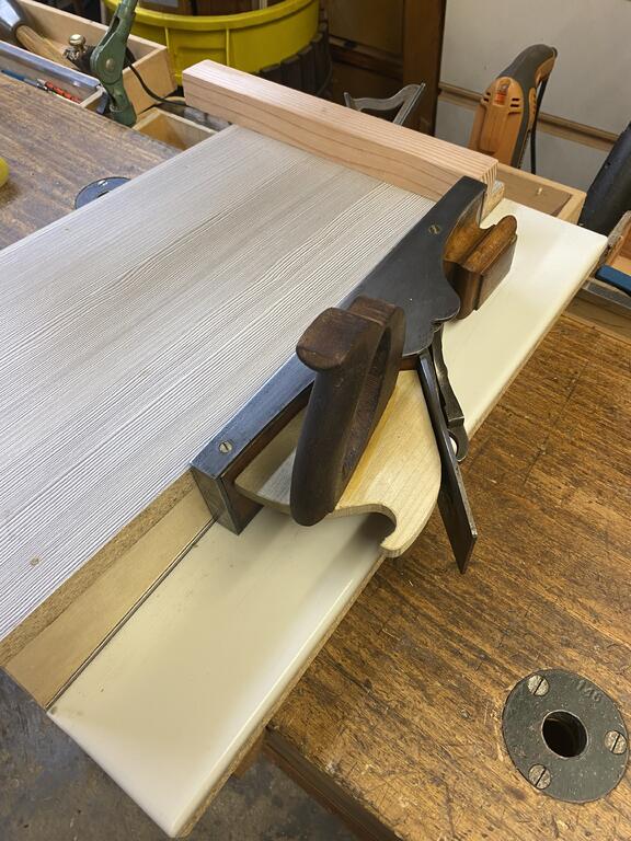

953 nut 68,201 #39 Posted August 4, 2022 1 hour ago, formariz said: Let’s see so far what is certain. It does not involve a handsaw. It is an aid in pushing and pulling something else. It does have a handle on it. The other parts of it resemble a handle in a couple of different ways. It can be used in something coming out of a miter box Hints given towards end grain, adjustment. It has companions another hint— fixture So it is used to square-up the mitered end grain of a board held securely in a forty-five degree shooting board while using a hand plane. 1 Share this post Link to post Share on other sites
formariz 12,381 #40 Posted August 4, 2022 5 minutes ago, 953 nut said: So it is used to square-up the mitered end grain of a board held securely in a forty-five degree shooting board while using a hand plane. Precisely. But what is the Gizmo used for? Share this post Link to post Share on other sites
953 nut 68,201 #41 Posted August 4, 2022 16 minutes ago, formariz said: Precisely. But what is the Gizmo used for? If you don't have a "SOOTING PLANE" (which I don't) the device would allow you push a plane on the shooting board with greater ease and control than using the method shown here. Share this post Link to post Share on other sites
formariz 12,381 #42 Posted August 4, 2022 Correct. It is conveniently adapted to existing plane’s handle without modifying it to allow easy use of it as a shooting plane . Without it , plane is hard and awkward to hold properly. The tilting of handle towards board helps putting pressure in the right direction., 6 1 Share this post Link to post Share on other sites
