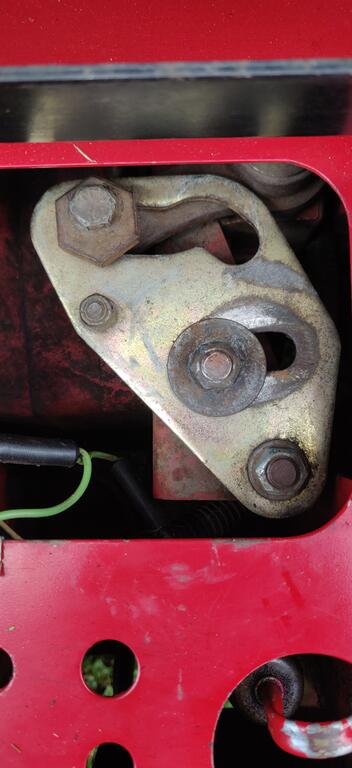

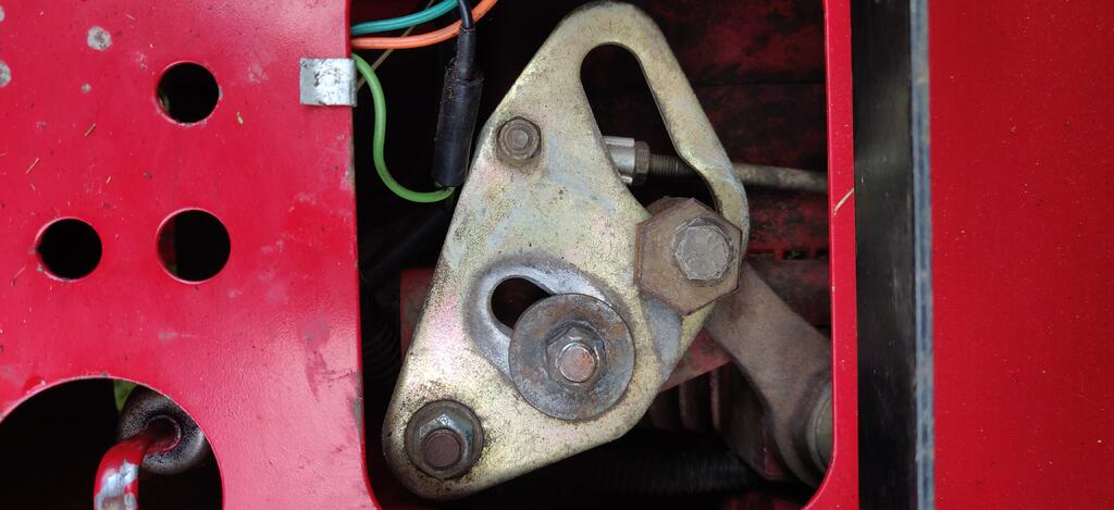

CountryRock 199 #2 Posted August 1, 2022 Here's a couple pictures of the motion cam plate on the transmission with the lever fully forward and reverse. Anything look worn? The video is of the heim joint ends on the motion control linkage. Are they supposed to wobble that much? VID_20220801_155618.mp4 Share this post Link to post Share on other sites
lynnmor 9,049 #3 Posted August 1, 2022 Perfectly normal, you only need to replace if there is play in the same direction as the rod pushes and pulls. I see you used some oil which is good, use it on every joint except the friction washer. Since you are experiencing what seems like an issue with the friction washers, disassemble that joint and remove the top and bottom washers, then clean with parts cleaner. The washers may be sanded flat of flipped to get a new surface. 1 Share this post Link to post Share on other sites
CountryRock 199 #4 Posted August 1, 2022 13 minutes ago, lynnmor said: Perfectly normal, you only need to replace if there is play in the same direction as the rod pushes and pulls. I see you used some oil which is good, use it on every joint except the friction washer. Since you are experiencing what seems like an issue with the friction washers, disassemble that joint and remove the top and bottom washers, then clean with parts cleaner. The washers may be sanded flat of flipped to get a new surface. The bolt that goes through the joints and connects them to the brake? linkage in the tunnel is supposed to be snug, right? It was a bit loose and gave me some slop in the lever. Share this post Link to post Share on other sites
lynnmor 9,049 #5 Posted August 1, 2022 All bolts need to be tight, the nut over the friction washers is just snug and is adjusted to suit. 1 Share this post Link to post Share on other sites
CountryRock 199 #6 Posted August 1, 2022 1 hour ago, lynnmor said: All bolts need to be tight, the nut over the friction washers is just snug and is adjusted to suit. Thanks. I think I got it straightened out now. Share this post Link to post Share on other sites
