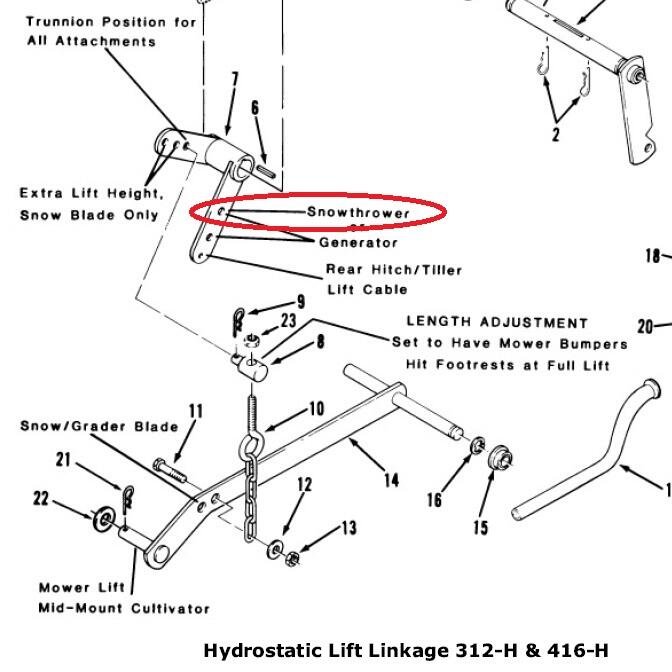

857lover 291 #1 Posted July 31, 2022 so have recently picked up a single stage snow blower and i have it hooked up to my 416on the attachomatic in the front but the tube rod seems to be to long to be attached to the bottom of the blower to hold it up so im wondering if i am attaching it the the lift handle in the wrong spot of if the rod is just too long because it came off of something like a d series tractor i really am not sure but the rod seems to have been made by hand because its a bright red and was freshly painted and the blower isnt or if this came off something with hydrualic lift any ideas? Share this post Link to post Share on other sites
gwest_ca-(File Mod) 12,450 #2 Posted July 31, 2022 1 Share this post Link to post Share on other sites
857lover 291 #3 Posted July 31, 2022 5 minutes ago, gwest_ca said: mine is a 8 speed but im sure it will still work i wil give this a try thanks! Share this post Link to post Share on other sites
