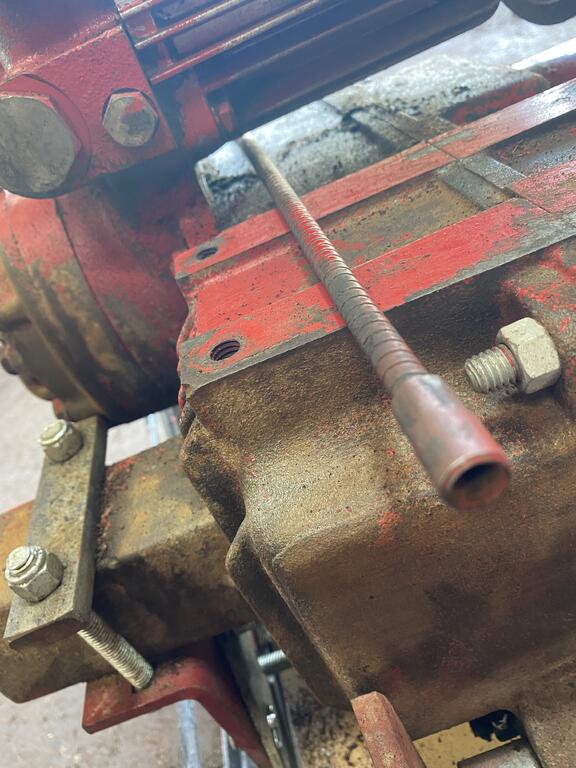

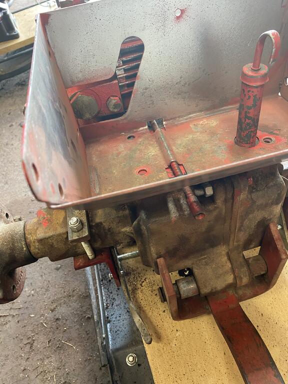

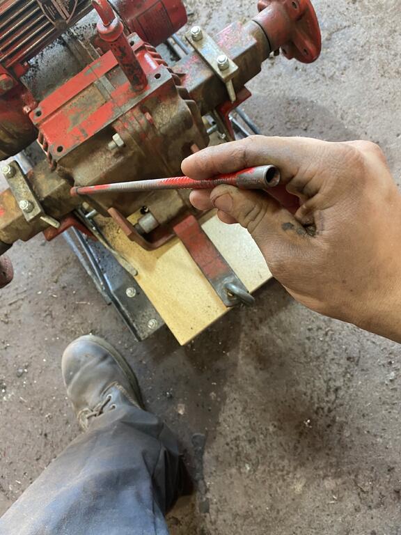

Thompson1276 257 #1 Posted July 30, 2022 I have a 1276 I’m fully restoring , and had it all apart in 4 hours. I found this rod that bends , but is also sealed not like a cable wire cover. it’s a original part I saw it in the 1276 owners manual on a picture on the side , you can’t take it out unless the toolbox is out and was not connected to anything, if anyone can tell me what this is that would be great , it has a manual lift btw not hydraulic. Share this post Link to post Share on other sites
Pullstart 69,787 #2 Posted July 30, 2022 That’s the sleeve for the lift cable. A 3/16” cable goes through that from the lift arm to the rear sleeve hitch. 2 1 1 Share this post Link to post Share on other sites
Jeff-C175 7,207 #3 Posted July 30, 2022 That looks like the 'tube' that the cable lift for rear mounted implements would travel. Piece of wire rope cable runs through it. 1 Share this post Link to post Share on other sites
Pullstart 69,787 #4 Posted July 30, 2022 This type of hitch… if you were using a solid draw bar, it’s not necessary. 1 1 Share this post Link to post Share on other sites
Handy Don 16,288 #5 Posted July 30, 2022 16 minutes ago, Pullstart said: That’s the sleeve for the lift cable. A 3/16” cable goes through that from the lift arm to the rear sleeve hitch. If you plan to use a rear slot or sleeve hitch (tiller, soil plow, cultivator, etc.) you'll need to replace that. They come as a complete unit with the cable, the housing, clevises, and ball-ends swaged onto cable to secure the clevises. About $35-40 (?) NOS from K&B Horse Parts, a supporting vendor of this site--there are a couple of different lengths so be sure to get the part number you need. I've seen member-made cables but, to me, it's worth getting the factory item to be really sure of the construction since they carry a lot of force. 2 1 Share this post Link to post Share on other sites
rjg854 12,964 #6 Posted July 30, 2022 Wheel horse parts and more carries them also, another of our vendors. 1 Share this post Link to post Share on other sites
