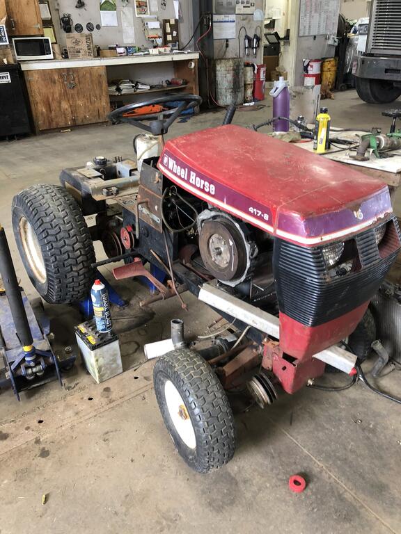

Botaswapedtratter 7 #1 Posted July 29, 2022 Hey all, just posting my wip horse, here’s a couple details on it did I overpay for the tractor? Yes was it worth it? Probably not does it smoke? A lil 😏 what have I done to it? Fixed tie rods made new clutch brackets Fixed snapped off clutch pedal Painted frame threw the KT17 in the dumpster (where it belongs) still working on getting the steering gears meshing right, almost have it custom motor mounts Put a kubota z482 in it made a quick swap drive pulley system clutch spring custom rad mounts Ran new coolant lines spaced the hood forwards and up i still have to add an alternator and another idler, it also is getting a hood stack once I have the whole hood situation figured out so far I think I’ve been working on it for three weeks, but almost every day for quite a few hours when she was still stock IMG_0020.MOV FullSizeRender.mov 2 1 1 Share this post Link to post Share on other sites

Pullstart 70,681 #4 Posted July 30, 2022 12 hours ago, littleredrider said: More pics!!!! I have a chance to buy same motor, but dunno how it would fit under the hood. It looks like it doesn’t In the first video I see a stack of spacers under the front. @Botaswapedtratter I too would enjoy more pictures! Share this post Link to post Share on other sites
Botaswapedtratter 7 #5 Posted July 30, 2022 4 hours ago, Pullstart said: It looks like it doesn’t In the first video I see a stack of spacers under the front. @Botaswapedtratter I too would enjoy more pictures! It doesn’t 😂 but here’s a yt video I put together of a lot of the pictures and videos of it 1 Share this post Link to post Share on other sites
