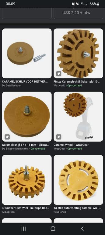

sjoemie himself 3,106 #5 Posted July 28, 2022 I've seen these been used to remove stubborn decals or stickers. Caramel wheels for use in a battery powered drill. 1 Share this post Link to post Share on other sites
