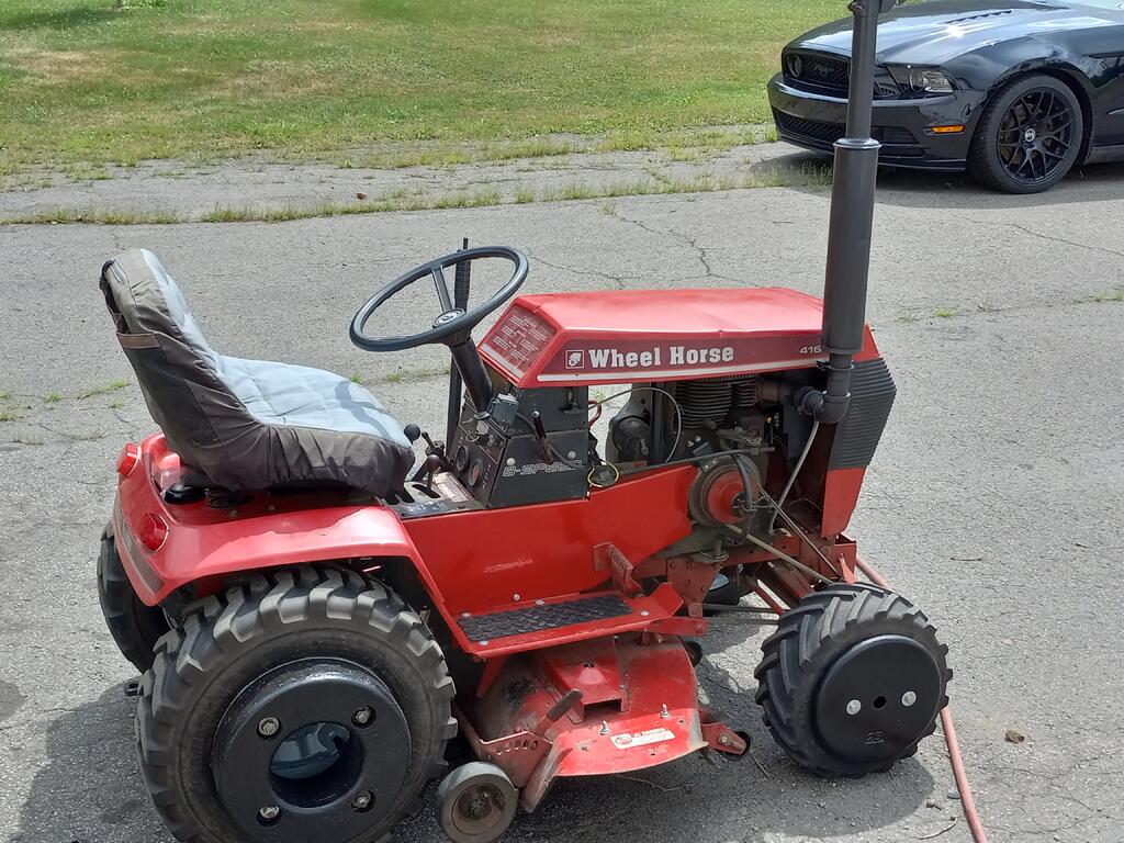

Panther416-8 342 #1 Posted July 28, 2022 Hello all, I've been a WH user/owner for most of my life and really enjoy the quality build and wide range of use of these machines. Previous models were 60s vintage but now I have a 416-8 with the Kohler magnum that I picked up about 14 years ago. Most of its chores have been lawn mowing, trailer hauling, pulling an Agrifab lawn vacuum and with a 48" snow plow that I use a winch on for lift. In the works is a new clevis hitch and rock shaft kit from WH and More to use the Brinly plow I picked up last week on CL. It is brand new, never used for $125. I have a couple of small hay fields that have never been plowed and hope the little guy can do it. 7 2 Share this post Link to post Share on other sites

Panther416-8 342 #9 Posted July 28, 2022 Thanks all for the welcome. The only major issue I had was with the transmission. Last year it started to take much more effort to move the shift lever and while mowing it actually broke off. It was like something from a movie. Here I was just holding the shift rod in my hand not connected to anything. Bought a new rod thinking that was the issue but something was wrong with the gears inside. I purchased a used tranny on ebay, cleaned it up, put some fresh gear lube and I was good to go. The only issue I have now is it isn't charging. I saw some threads on here and I checked wires coming out from the flywheel and have only 15 volts AC between them which may be part of the problem. I will post under the electrical issue section and see if I can get some resolution on this. Thanks 3 Share this post Link to post Share on other sites

Panther416-8 342 #13 Posted July 29, 2022 Thanks Pete. I think I have some of those alligator clips around, they are handy. I will check the grounds as you suggest. In my other post in the electrical section I found I'm getting 45VAC from the stator to the regulator but only the battery voltage (12.0) coming out of the regulator. One thing I think I need to do is find the model/sn tag on this machine. In all of the years working on this I don't ever remember seeing a metal tag or sticker on it anywhere. 2 Share this post Link to post Share on other sites
