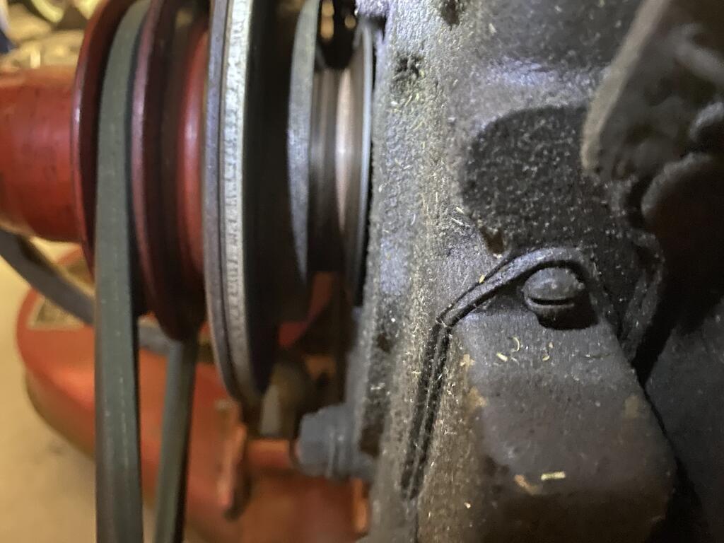

Ed Kennell 45,014 #2 Posted July 28, 2022 to the Can you post a picture of the engine drive pulleys? There should only be one drive pulley and two pulleys on the PTO bell. Share this post Link to post Share on other sites
953 nut 64,275 #3 Posted July 28, 2022 As Ed said the engine pulley should only have one "V" but the belt may be jumping up onto the small gap between the pulley and the PTO. There should be a couple of small round stock retainers bolted to the engine that hold the belt where it should be. If they are not properly placed the belt can come out of line. 1 Share this post Link to post Share on other sites

84c125 3 #6 Posted July 29, 2022 21 hours ago, Ed Kennell said: to the Can you post a picture of the engine drive pulleys? There should only be one drive pulley and two pulleys on the PTO bell. This is a picture looking toward the rear. On the left, you can see the belt going to the mower deck. On the right is the drive belt and it is up out of the groove on the pulley it is supposed to be on. 1 Share this post Link to post Share on other sites

Jeff-C175 7,207 #9 Posted July 29, 2022 3 minutes ago, 85c125 said: under the idler pulley and some show it going over I think it depends on whether it's an auto or manual trans. Which do you have? By the way, the deck belt should be in the groove closer to the engine. 2 Share this post Link to post Share on other sites
84c125 3 #10 Posted July 29, 2022 3 minutes ago, Jeff-C175 said: I think it depends on whether it's an auto or manual trans. Which do you have? By the way, the deck belt should be in the groove closer to the engine. It is an 8 speed manual. Thank you for that info on the mower deck. I've been having trouble with it flipping over as you can probably see in the picture. Share this post Link to post Share on other sites
wallfish 19,374 #11 Posted July 29, 2022 The idler pulley should be under the belt. Hydros use that idler on the top but they don't use a pedal to clutch. The belt guard should keep the belt from moving over. Is the guard installed? You can also make small rods that keep the belt in the groove 3 Share this post Link to post Share on other sites

Jeff-C175 7,207 #14 Posted July 29, 2022 (edited) 18 hours ago, wallfish said: You can also make small rods that keep the belt in the groove @84c125 Good point, probably missing on his manchine. These pics show the 'factory' ones. And, If I hadda guess I'd think the belt guard may not be there either. Edited July 29, 2022 by Jeff-C175 3 Share this post Link to post Share on other sites
