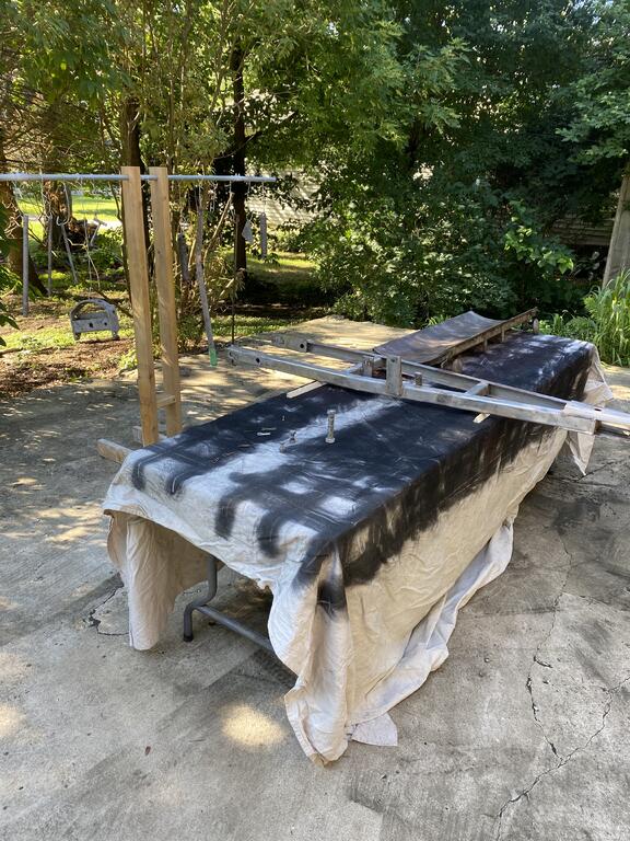

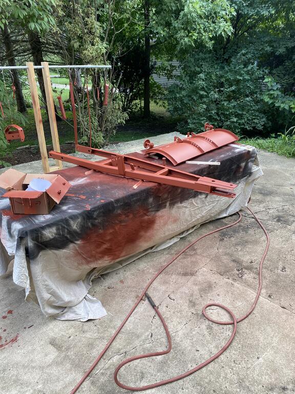

Heatingman 977 #14 Posted July 31, 2022 Well finally starting to make some progress. plow and all its hardware got a few coats of red oxide primer. Share this post Link to post Share on other sites

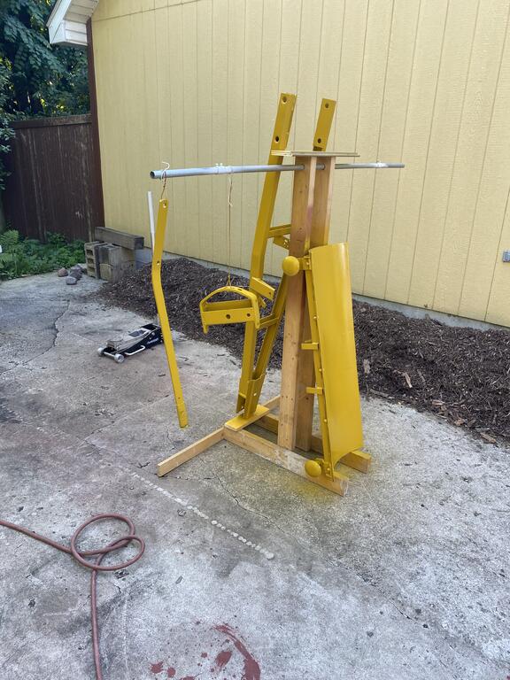

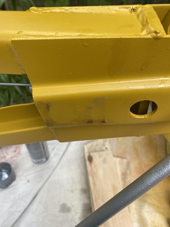

Heatingman 977 #22 Posted August 4, 2022 (edited) Not happy with the paint durability. sprayed the primer over the weekend, was pretty happy with that. sprayed the top coat Monday I think. Its been curing for a few days. started reassembly of the plow. Seems like if I look at the finish the wrong way it chips off. Either the hardener is not compatible with the Ace Rust stop paint, or its just garbage paint. Set it on a piece of wood today, and I mean gently set in order to get the blade elevated, and when I readjusted the position, paint came off. Im practically wearing kid gloves moving this around. One part touches another during reassembly, both get a chip. Primer is the same brand and series and made to be used with oil based. Back to the drawing board I guess. gonna have to make some test pieces and test durability / add in compatibility before I coat the rest of the pieces and strip down and recoat this one Edited August 4, 2022 by Heatingman 1 Share this post Link to post Share on other sites
Heatingman 977 #23 Posted August 4, 2022 Also what looks like runs in the paint in the above pic, its some oil I used to lubricate in that area, as thats where the plow pivot is. Maybe Im just too impatient, not sure. But I would think 4 1/2 days is plenty to cure enough to move gingerly without huge chunk removal. Maybe the pressure washer will take this off. Really not wanting to sandblast again outside the cabinet. Scrapping off real easy so far. Share this post Link to post Share on other sites

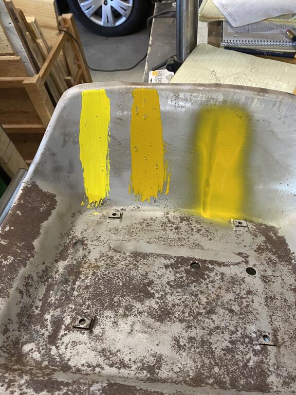

Heatingman 977 #24 Posted August 6, 2022 Did a little paint comparison testing. rusto implement paint I had on hand - happened to be JD yellow (I used for a chop saw cabinet) no additives the Ace rust stop oil based - equipment yellow no additives and the Ace rust stop enamel from a spray can. after a day - the spray can hardened fine to the finger nail, the others still not - to be expected. after 2 days the Rusto oil based passes the nail test. after 3 days the Ace still fails with ease. Either that paint just takes forever to cure, or its gone bad, or … Share this post Link to post Share on other sites
