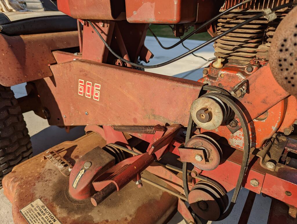

Jimmy66 47 #1 Posted July 24, 2022 Got my 606 started for the first time, and was eager to ride around to get the unidrive sludge cleaned up with some diesel. But, the belt wouldn't slacken up. I plan to adjust the position of the guard forward, and verify that the tab is not bent. Any advice on what areas to look at? Seems to be the proper 70" belt. Share this post Link to post Share on other sites

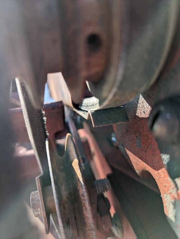

Jimmy66 47 #7 Posted July 25, 2022 Original HH60, and belt guard was mounted on our first attempt. All mounting holes seem slotted, so I wondered if there was room for back and forth adjustment, which could better position the guide tab (although I don't recall the engine bolt hole being slotted. Also wondering about common issues with the pulley, I saw somewhere someone resorting to sanding the channel down. Share this post Link to post Share on other sites
Handy Don 16,918 #8 Posted July 25, 2022 2 hours ago, Jimmy66 said: Original HH60, and belt guard was mounted on our first attempt. All mounting holes seem slotted, so I wondered if there was room for back and forth adjustment, which could better position the guide tab (although I don't recall the engine bolt hole being slotted. Also wondering about common issues with the pulley, I saw somewhere someone resorting to sanding the channel down. From the pictures, it looks like the guard is on correctly (there really isn't much, if any, adjustability). The tab may be a little far down. It should just barely clear the belt when the clutch is engaged and the belt has tension. A rusty pulley at the engine can thwart disengaging and ruin the belt quickly. I shoe-shine pulleys with a strip of very fine cloth-backed emory folded over a strip of rag to make it fill the groove. Share this post Link to post Share on other sites

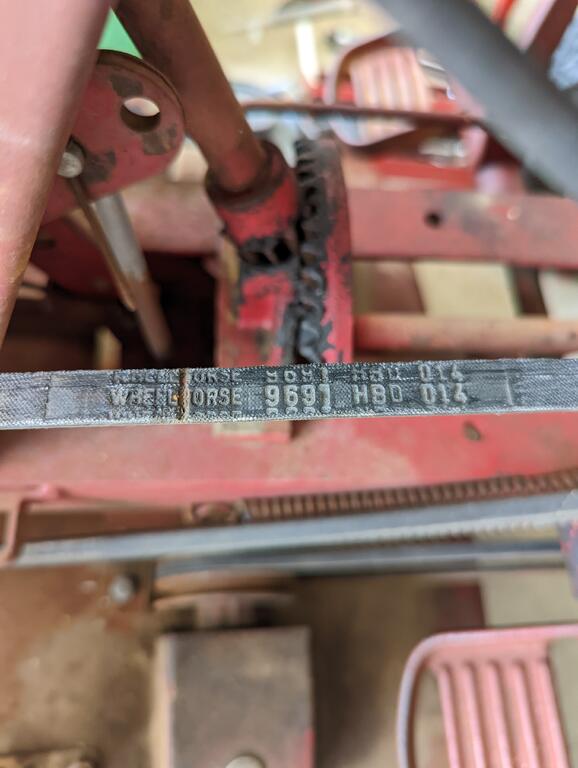

953 nut 67,284 #9 Posted July 25, 2022 I'm confused! Looking at your first picture I see the part number for the present belt is 9691 which is a 70" belt. The chart in our manuals section calls for a 8005 which is a 4L-720, a 72" belt. The owner's manual calls for a 1576 drive belt which crosses to a 9691 which you have. If you are getting some slack in your belt then going to a two inch longer belt is not the answer. The only other thing I can think of is the rust on your pulleys may be making them a bit grabby. Remove the belt and sand off the rust in each pulley so the belt has an opportunity to slip when it is slack. Share this post Link to post Share on other sites

Jimmy66 47 #11 Posted September 2, 2022 Finally got to work on the drivebelt today. I had enough slot to shift the cover towards the rear, achieving the slack needed to clutch. Put some kerosene in the gearbox and took her for a spin. All gears function! Third gear popped a wheelie! Left skidmarks in the driveway haha. I did notice a few leaks but maybe they'll go away once I put the gear oil in. 2 Share this post Link to post Share on other sites
