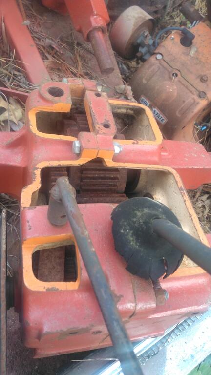

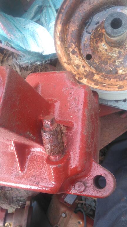

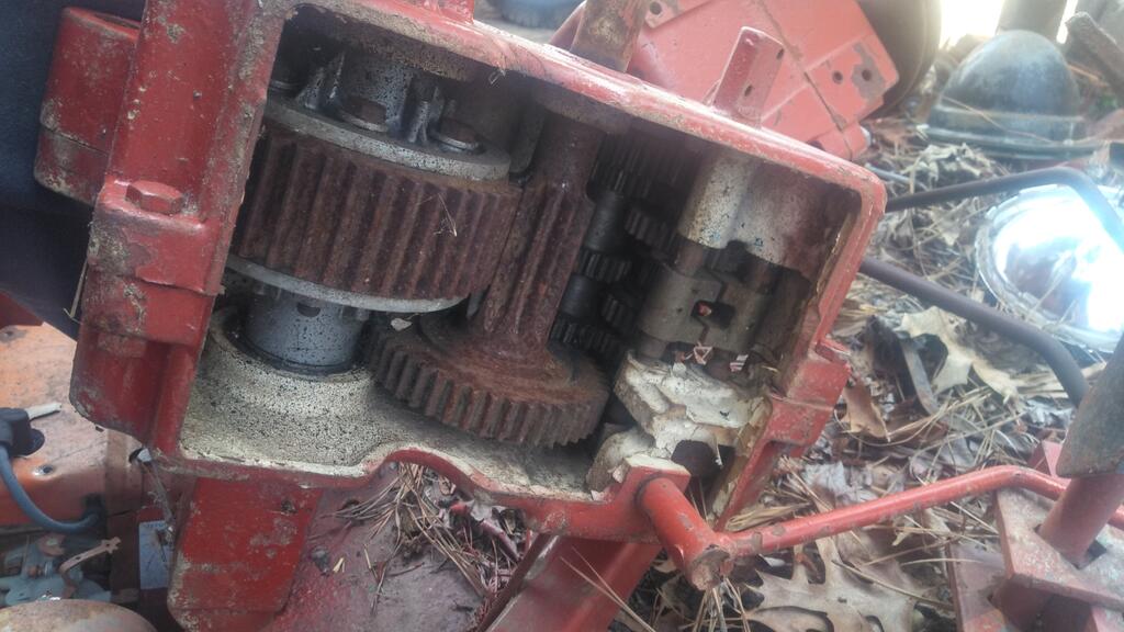

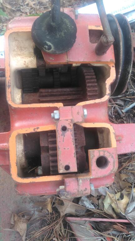

Wild Bill in VA 1,546 #10 Posted July 24, 2022 There will be a small tang the width of the belt that the belt will drag on and slow the belt on the belt guard. The axles and the input drive pulley should be at a stop to enable the gears to be selected. Here's some pictures of a factory Unidrive cut a way transmission. Wild Bill in Richmond VA Share this post Link to post Share on other sites
ri702bill 11,349 #11 Posted July 24, 2022 Too bad it is all rusted to Hades - there were many good usable parts in there - not anymore..... Share this post Link to post Share on other sites
sjoemie himself 3,106 #12 Posted July 24, 2022 Might not be too late @ri702bill @Wild Bill in VA Give her a bath of Evap-o-rust and I think you'll be surprised how well it cleans up. Might not be in running working condition again but surely much nicer to look at and use as an educational piece. 1 Share this post Link to post Share on other sites

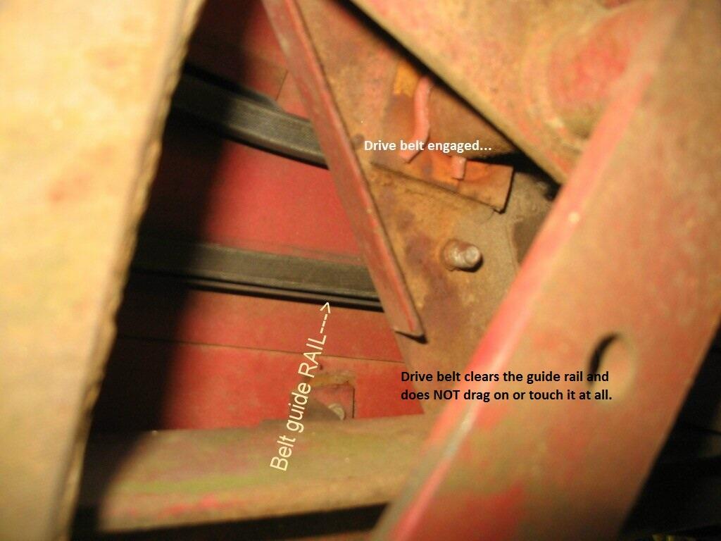

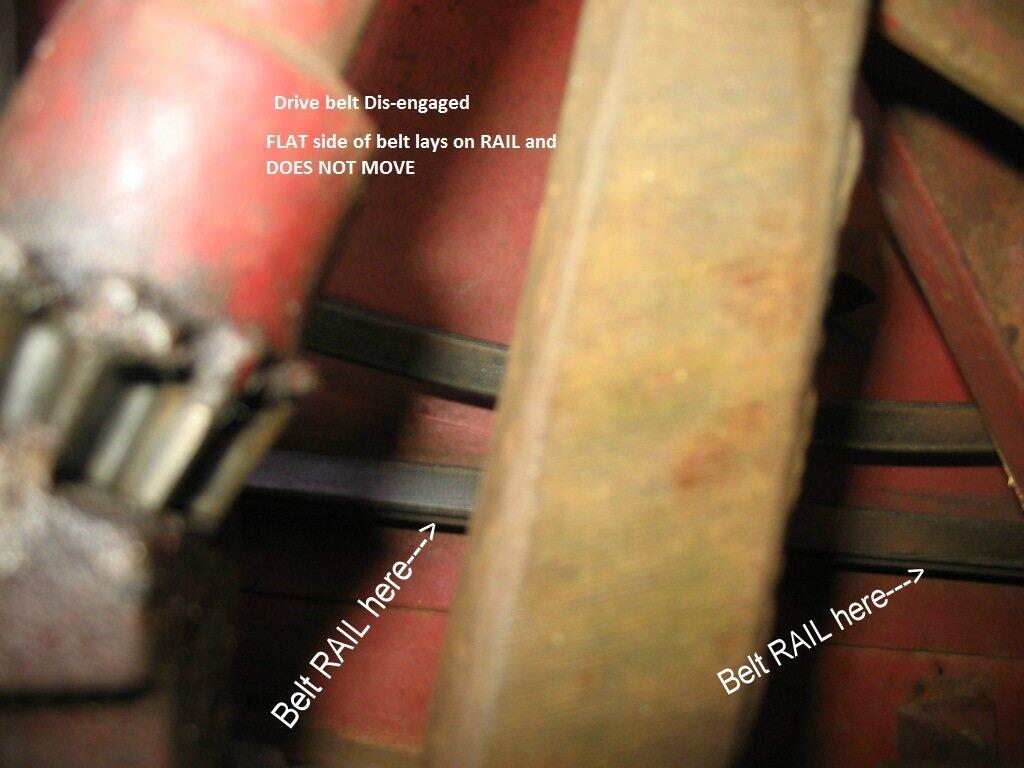

daveoman1966 3,882 #13 Posted July 24, 2022 2 hours ago, John2189 said: When I start it in neutral, i push the clutch in and hold it for a few seconds and it grinds going in to gear. This tells me that the BELT is not at STOP when you depress the clutch...and it MUST be at STOP. Otherwise, if the belt is still moving, it is turning the trans drive gear. PROBLEM: (1) wrong drive belt (2) belt guard MUST be on ...it 'catches' the slack when clutch is depressed. There is a 'RAIL' on the back side of the Belt GUARD that catches the slack which allows the belt to 'hover' over the engine crankshaft pulley. My pic of the C-160 I own: 1 Share this post Link to post Share on other sites
Wild Bill in VA 1,546 #14 Posted July 24, 2022 The factory cut a way Unidrive transmissions were training tools for Wheel Horse school. The early 6 speed Unidrive cut a way transmission were point of sale displays used by Wheel Horse dealerships. Here's a picture of an early cut a way, you tell this by the extended oil fill pipe that allowed the extra oil needed for 6 speed. The cut a way case was found in a dealership in Indiana ...... minus all the gears that were sold out of it.. I put some old gears and differential in the unit to make it a working display. Notice it should have the 10-pinion differential not the 8-piniopn I installed. Wild Bill in Richmond VA 3 Share this post Link to post Share on other sites
sjoemie himself 3,106 #15 Posted July 24, 2022 @Wild Bill in VA thanks for explaining! I am an absolute noob when it comes to things like this Still, a de-rusting bath would'nt hurt Share this post Link to post Share on other sites
