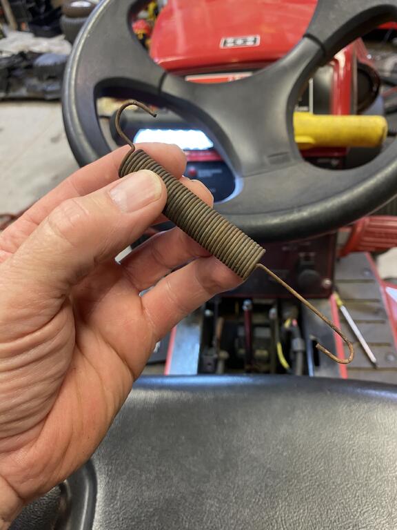

Sparky-(Admin) 24,664 #1 Posted July 22, 2022 And what’s it’s reason for being there? On my 315-8 there is a spring attached to the shifter. It pulls the shifter to the left (as your sitting on the machine) but why? I see there is some sorta safety switch there with no wires to it. It musta been related to that I suppose. I’m about to get rid of it as well as the clutch damper/shock thingy. But figured I would ask if the shift lever spring has any advantage. 1 Share this post Link to post Share on other sites
ebinmaine 77,508 #2 Posted July 22, 2022 We don't have any newer machines so I can't really answer but the question comes to mind... Is there enough tension on that spring to pull the shift lever back to the position furthest to the left? And if so, is that an advantage over the free-roaming shifters of the older tractors like I have.? 1 Share this post Link to post Share on other sites
squonk 45,591 #3 Posted July 22, 2022 Spring looks roached! 1 Share this post Link to post Share on other sites
gwest_ca-(File Mod) 12,014 #4 Posted July 22, 2022 It is part of the MNIR (No Mow In Reverse) system 3 1 Share this post Link to post Share on other sites
Sparky-(Admin) 24,664 #5 Posted July 22, 2022 10 minutes ago, gwest_ca said: It is part of the MNIR (No Mow In Reverse) system Got it. This machine mows in reverse so I guess NMIR has been disabled. The spring is outa here! 2 2 Share this post Link to post Share on other sites

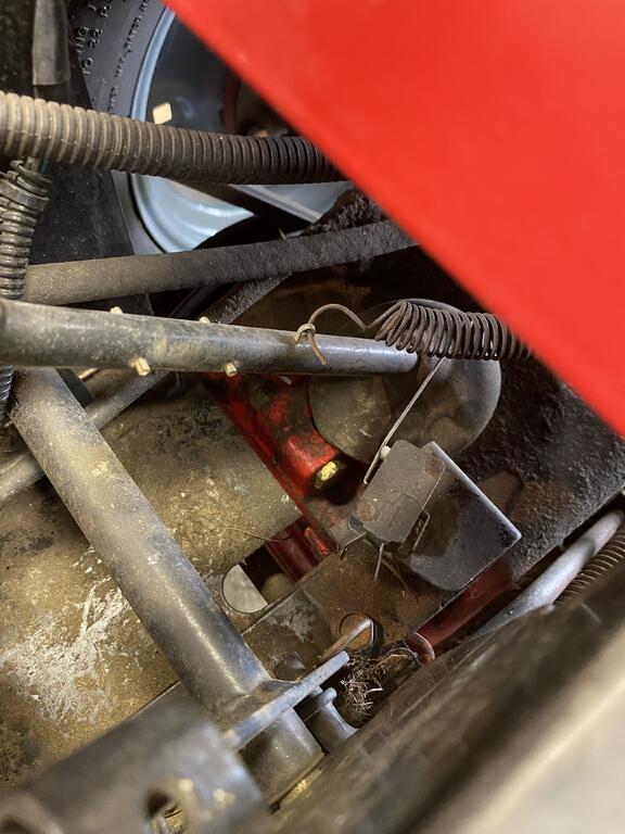

Pullstart 68,938 #6 Posted July 22, 2022 12 minutes ago, gwest_ca said: It is part of the MNIR (No Mow In Reverse) system Which looks fully functional…. 1 Share this post Link to post Share on other sites

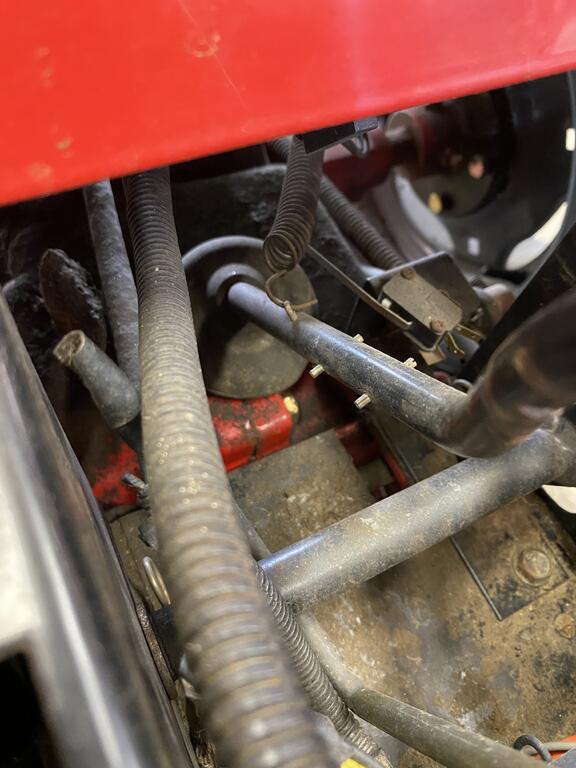

Pullstart 68,938 #7 Posted July 22, 2022 1 minute ago, Sparky said: 13 minutes ago, gwest_ca said: t of the MNIR (No Mow In Reverse) system Got it. This machine mows in reverse so I guess NMIR has been disabled. The spring is outa here! Looks like that switch down there lost it’s wires 1 Share this post Link to post Share on other sites
Sparky-(Admin) 24,664 #8 Posted July 22, 2022 15 minutes ago, Pullstart said: Looks like that switch down there lost it’s wires Yep….no wires on the safety switch so I guess I can’t make a You-tube video outa this ! Keep your eyes on the classified section for a used NMIR spring at a great price 3 Share this post Link to post Share on other sites

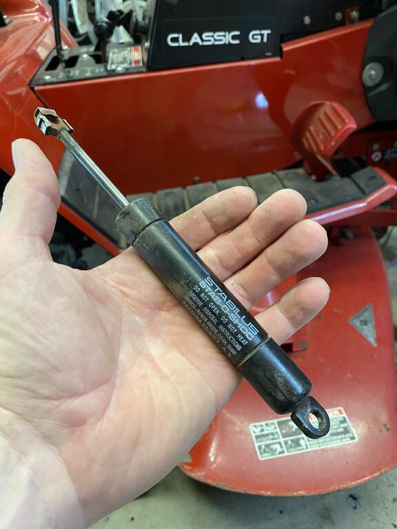

Sparky-(Admin) 24,664 #12 Posted July 22, 2022 And that pesky clutch damper is also gone! This 315-8 is gonna feel like a brand new rig 1 Share this post Link to post Share on other sites

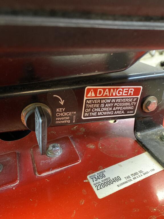

Sparky-(Admin) 24,664 #13 Posted July 22, 2022 26 minutes ago, ebinmaine said: I know somebody had to have a good reason for this at one time or another but.... Who doesn't want to mow in reverse????? Exactly! I sometimes mow in reverse, backing into the woods, with my RD decks to knock back the weird weeds and things that grow there. All the clipping and seeds get hurled into the woods and not my yard. There is a switch under the seat that you manually turn to mow in reverse but none of it on this machine is hooked up. 1 Share this post Link to post Share on other sites

Sparky-(Admin) 24,664 #15 Posted July 22, 2022 Update: 1) Much easier to shift into 1st and 2nd. I’ve actually had this machine pop outa 2nd gear and I was thinking it might have a tranny issue. But now I think that little spring was causing the problem! 2) Without that clutch damper/shock device it’s just like operating an older machine. Just ease the clutch back (don’t side step it) and away it goes all smooth like. There was already a clutch return spring on it just like the C, 300-400 series have so all I did was remove the damper. Once on my bench I closed and opened the damper but it stays wherever I leave it. So if I compress it back into the cylinder and let go it just stays on that position. I can manually pull it back but with some resistance. I’m thinking this thing was already “shot” before I got it. 2 Share this post Link to post Share on other sites
Handy Don 15,997 #16 Posted July 22, 2022 1 hour ago, Sparky said: Once on my bench I closed and opened the damper but it stays wherever I leave it. So if I compress it back into the cylinder and let go it just stays on that position. I can manually pull it back but with some resistance. I’m thinking this thing was already “shot” before I got it. I think this is actually the correct behavior of a damper--slow the motion in either direction but don't exhibit a bias toward any position. 2 Share this post Link to post Share on other sites

RED-Z06 2,718 #18 Posted July 23, 2022 (edited) 8 hours ago, ebinmaine said: I know somebody had to have a good reason for this at one time or another but.... Who doesn't want to mow in reverse????? Going back...heck, 24ish years, an idiot decided to mow with kids around, he backed over an infant. He sued the manufacturer on the grounds that they allowed it to mow in reverse. Immediately the broad reaction was to permanently disallow reverse mowing with an interlock that mechanically prevented it. Some mowers today, including Zero Turns, fully disable reverse mowing. But after many complaints and people disabling the defeats, manufacturers decided on a RIO switch that became "a contract" that by performing a particular action, you took on the liability of mowing in reverse. Toro used the seat switch that you had to get off, turn..and if you got off or sat up..defeated reverse mowing. MTD went with a button and key you turn the key back one click and push a button. Deere used either a stand alone button OR you pulled up on the PTO switch. Ayp/husky used a 4th position on the ignition switch. I personally will not disable the switches, if a mower comes in the shop with it disabled I will, if possible, reactivate it. With that said none of my mowers have it...i know to be aware of my surroundings and dont need nanny switches Edited July 23, 2022 by RED-Z06 4 Share this post Link to post Share on other sites
