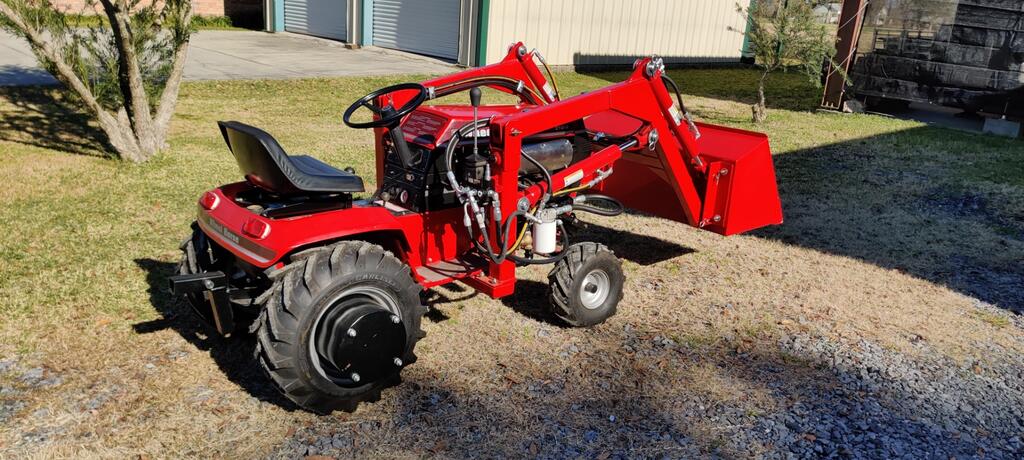

MXDPA 13 #1 Posted July 19, 2022 I have a front end loader on my 310-8. With no load steering is easy, however with a load, it is almost impossible to turn the wheel. I'm afraid I will break something trying to turn. Is there a modification that would remedy this? 3 1 Share this post Link to post Share on other sites

The Freightliner Guy 1,363 #9 Posted July 19, 2022 and nice tractor paint looks perfect the loader part almost looks factory it’s so great looking 1 Share this post Link to post Share on other sites

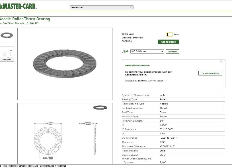

Handy Don 14,263 #10 Posted July 20, 2022 All good info. 11 hours ago, pfrederi said: Thrust bearing and washers on the bottom of you r spindles may help a little. I added them to a 520-H that already had reduction steering and went from "nice" to "wow". Just bought a set to put on the 312-H we've already upgraded with 8" turfs and short spindles. Share this post Link to post Share on other sites

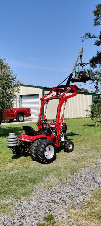

MXDPA 13 #11 Posted July 20, 2022 WOW! Thank you all for the quick replies and great advice! I bought the lug tires because they can hold a lot more weight than lawn mower tires. But now I understand that they dig in and contribute to the hard steering. Changing to 8" trailer tires & wheels will be the first thing I will do to remedy the issue along with the thrust bearings & washers. I'm not familiar with the reduction steering from a 520 tractor, but that sounds like something I could use - if I can find one. The photo I attached didn't include the counter weight I use with the loader. I also now have dual rear wheels. I fabricated the loader from drawings by P.F. Engineering. I can't say enough great things about this project. Paul with P.F. Engineering gave me support whenever I had a question. I would recommend them to anyone that would want to undergo such a project. As the photo shows, I also fabricated a boom to lift things. Since I took this photo, I added a 12v winch to make it work like a cherry picker. I also modified the way the bucket & boom attaches to the lifting arms. They hook on top with 2 pins on the bottom. 1 5 2 Share this post Link to post Share on other sites
sjoemie himself 3,101 #12 Posted July 20, 2022 @MXDPA you did a great job building that loader. By the looks of it you added some of your own touches to Paul's design. Came out good Share this post Link to post Share on other sites

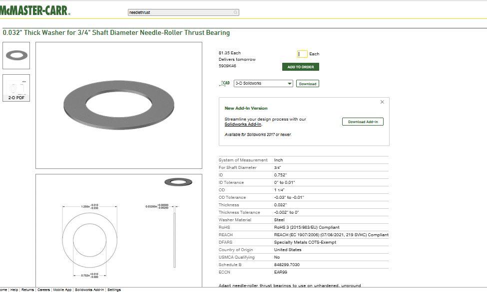

wallfish 18,428 #13 Posted July 20, 2022 4 hours ago, MXDPA said: Changing to 8" trailer tires & wheels will be the first thing I will do to remedy the issue The spindles for those 6" wheels are extended down to keep the tractor level with the smaller wheels, so it might be a good idea to get 8" wheel spindles too. along with the thrust bearings & washers. The thrust washers will take up space on the pin so you will need to remove some material off of the axle so the clip will fit back on I'm not familiar with the reduction steering from a 520 tractor, but that sounds like something I could use - if I can find one. They come up for sale every so often. $300-$350. Keep an eye out for a 520 roller tractor too. The photo I attached didn't include the counter weight I use with the loader. I also now have dual rear wheels. Be careful with dual rears on a loader tractor. The outside tires should have very little air pressure to allow some give on uneven terrain. They definitely provide some stability but the big con is the risk of snapping an axle. That extra tire adds quite a bit of leverage on to that short axle. I snapped a 1 1/8" axle with duals on the loader. That 310 trans has smaller 1" axles Nice job on the loader build! I did Paul's backhoe for a loader tractor I 1 Share this post Link to post Share on other sites
Wild Bill 633 877 #14 Posted July 20, 2022 (edited) Another option that helps is to fill the rear tires with fluid. Very nice looking tractor you have! Edited July 20, 2022 by Bill633 Share this post Link to post Share on other sites
953 nut 60,980 #15 Posted July 20, 2022 9 minutes ago, Bill633 said: fill the rear tires with fluid. Liquid filled tires will add traction and stability but will do nothing to ease the steering effort. For that the weight needs to be behind the rear axle. 1 Share this post Link to post Share on other sites
953 nut 60,980 #16 Posted July 20, 2022 1 hour ago, wallfish said: The thrust washers will take up space on the pin so you will need to remove some material off of the axle so the clip will fit back on When I added thrust washers and bearings to my loader I cut material off the top of the axle where tte spindles come through so the bottom would remain smooth. 2 Share this post Link to post Share on other sites
Handy Don 14,263 #17 Posted July 20, 2022 4 hours ago, 953 nut said: When I added thrust washers and bearings to my loader I cut material off the top of the axle where tte spindles come through so the bottom would remain smooth. Also the precision of the material removal isn't so critical at the top. You only need room to get the clip on and not have the spindle fall out when you lift the front of the tractor (or go off the ski jump). 1 Share this post Link to post Share on other sites
wallfish 18,428 #18 Posted July 20, 2022 Those bottom surfaces aren't exactly squared up and true to each other either but I've done some removing material from the top for the clip to go on. Those thin thrust bearings have some flex to them. 2 Share this post Link to post Share on other sites
Handy Don 14,263 #19 Posted July 21, 2022 2 hours ago, wallfish said: Those bottom surfaces aren't exactly squared up and true to each other either but I've done some removing material from the top for the clip to go on. Those thin thrust bearings have some flex to them. I'll keep this in mind! Thanks. And yes, @peter lena those bearing will get red n'tackied! Just got an order of cartridges in today. 1 Share this post Link to post Share on other sites
