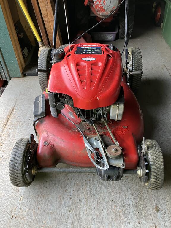

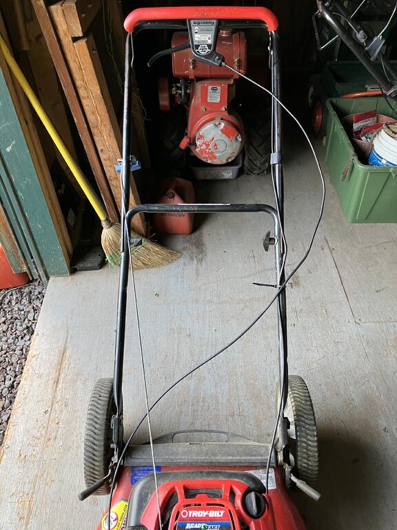

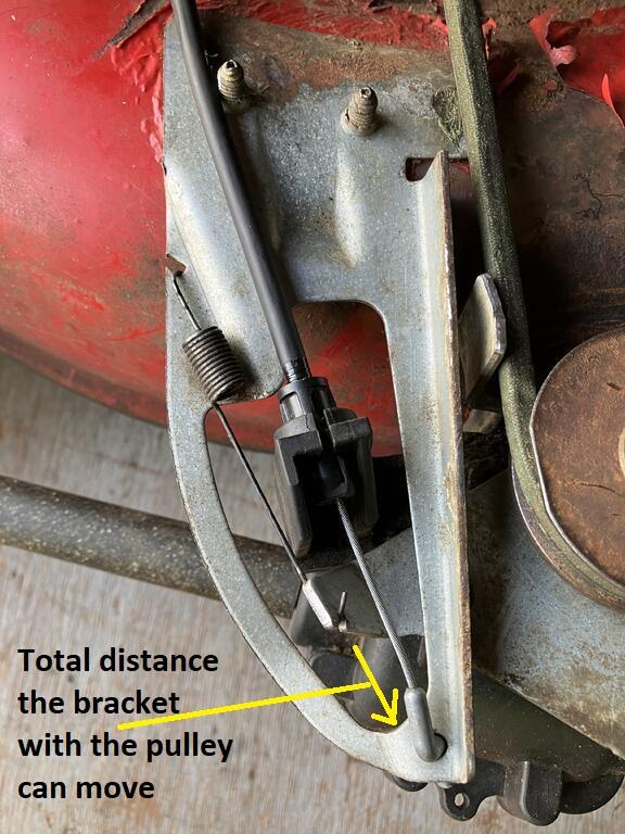

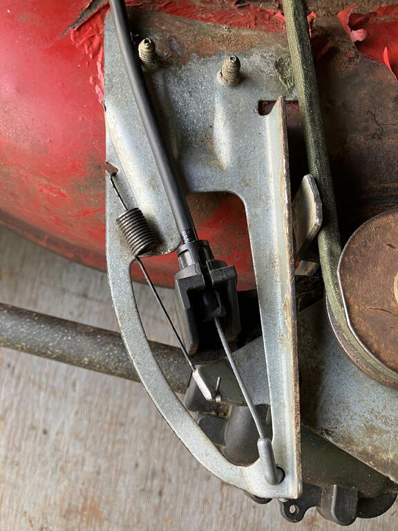

tunahead72 2,640 #1 Posted July 17, 2022 I have a 2005 Troy-Bilt self-propelled mower that has served us well over the years. I'd like to hold on to it, but it isn't self-propelling at the moment, and my body is complaining. With the engine running, if I raise the front of the mower and squeeze the handle, the front wheels will turn and I can adjust how fast they turn with the little knob at the handle, but there's no forward motion when I lower the mower to the ground. I could use some advice.... I think my problem is with the cable, because the gear box isn't rotating forward and tightening the belt like it's supposed to. Thinking it's probably stretched over the years, I measured it and found that it's about an inch longer than the current Stens replacement. I was able to adjust the cable a fraction of an inch yesterday, by unthreading the caps at each end, effectively "lengthening" the cable housing and "shortening" the cable itself. It didn't help, the gear box still isn't rotating forward, and the belt still isn't tightening. The clutch lever on top of the gear box does move like I think it's supposed to when I pull the handle, but nothing else happens. I cleaned all the grass from the entire mower earlier. The handle assembly works fine. The wheel assemblies and spur gears seem okay, a little loose and wobbly, but not bad -- there's very little wear that I can see on the gears or the inside of the wheels. The belt is only about a year old and looks good. I would just replace the cable, but I wonder if there might be something wrong with the transmission. The cable slides easily inside its housing, but I did notice today that one end is just starting to fray a tiny bit. I should mention that this self-propelled mechanism has never worked as well as I hoped, even when it was new. And now it's acting much like nearly dead weight, and practically begging to be removed completely. I hope it doesn't come to that. Here's some photos, any thoughts? Share this post Link to post Share on other sites
SylvanLakeWH 32,020 #2 Posted July 17, 2022 Maybe put a spacer on the black plastic doohickey that moves/hits the box? Take up some of that space so it is snug? May do the trick. Just a thought. 3 1 Share this post Link to post Share on other sites
wallfish 20,388 #3 Posted July 17, 2022 Verify the gearbox is good and working by spinning that pulley. Maybe by the nut on top of the pulley with a socket and a drill. Try and add some load to the wheels to verify it's not slipping gears and can move the mower. If the gear box doesn't work then belts and cables don't mean a thing. If the gearbox is good then a shorter belt may be the solve because that bracket can only move so far to tighten the belt. (or at least it appears that way in the pic) If the tab with the spring attached to it is bottoming out where the end of the cable attaches, then it may not be moving enough to fully tighten the long belt. 1 Share this post Link to post Share on other sites

The Freightliner Guy 1,364 #17 Posted July 29, 2022 What the heck is that front drive system I’ve never seen something like that Share this post Link to post Share on other sites
tunahead72 2,640 #18 Posted July 30, 2022 I'm not sure how to answer your question exactly. It's similar to others I've seen elsewhere, I've just never had to look at one closely enough to try to make it work better. There is a plastic cover that I removed for the photos, maybe that's throwing you off. That's where the mice like to party, it's a good idea to take that cover off every once in a while and clean up their mess. Share this post Link to post Share on other sites
