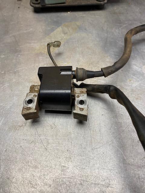

lynnmor 8,827 #3 Posted July 14, 2022 (edited) 1 hour ago, Calvin Jones said: Mower ID # 32-120E01, 11812 0075 with a Toro Power Plus ONAN engine (E125V-N/10964B S/N A903645964) I have not tested the ignition module under the fly wheel. My guess is that the module became heat sensitive. Do your hot coil test before spending money on a module, just be ready to immediately test the coil upon shutdown. Are you sure that there is a module under the flywheel? Can you post a photo of the coil? Edited July 14, 2022 by lynnmor Share this post Link to post Share on other sites

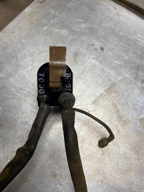

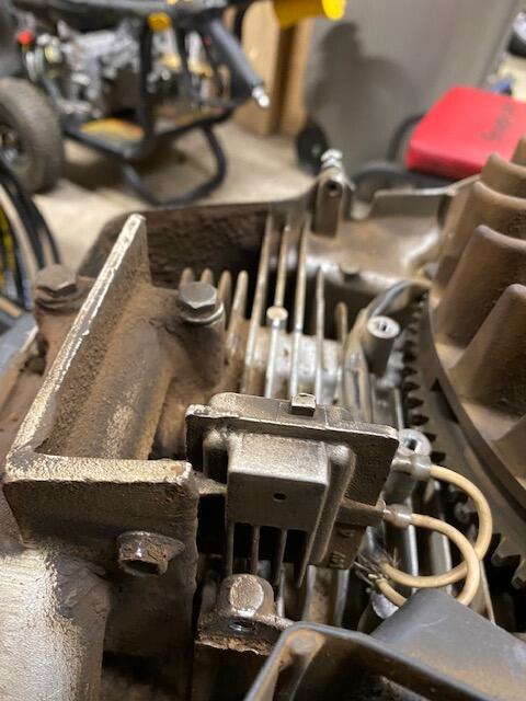

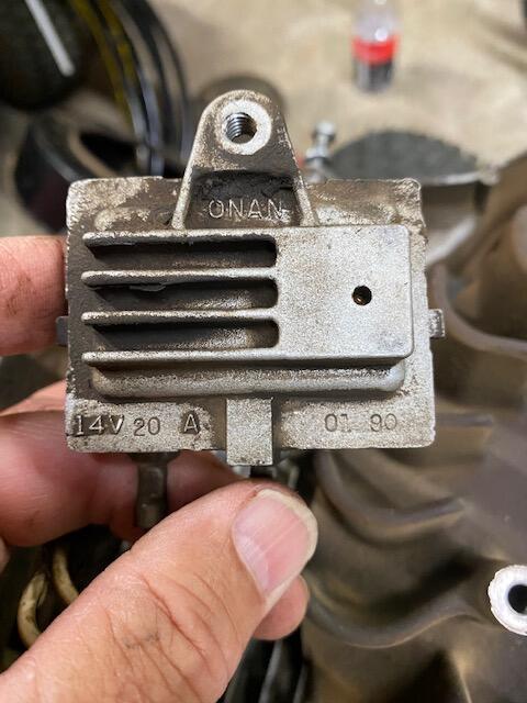

Calvin Jones 4 #5 Posted July 15, 2022 I would like to start this update by thanking, "The Wheelhorse Master" and the, "Wheelhorse Pro" for your prompt response and willingness to help this newby to the forum. Also, thanks to Roadapples (RedSquare Expert) for the warm welcome. The documents provided by Wheelhorse Master have been very helpful in my troubleshooting efforts. Also, I need to clarify my misunderstanding of this ONAN engine. I looked at the Master Parts Viewer incorrectly. The voltage regulator is beside the flywheel, not under. Pics of the voltage regulator and coil module are attached. I know the numbers aren't very clear in the pic. The first one is, "BN35" or "BN85". I can't distinguish between the 8 and 5. The other number is 709G. I disconnected the dark blue wire going to the coil as suggested. Engine started fine when cold, but would not shut off by turning the key. I had to pull the plug wire. I believe that is normal because that's part off the kill circuit, right? I tested the voltage regulator using test 1 and 2 if the Troubleshooting guide. Test 1 with engine off battery reads 12.82 vdc. Test 2 with engine running the voltage is 14.05 vdc. I ran test 2 when the engine was cold and again when hot. Voltage just climbed to 14.06. Both test 1 and 2 results are in specification so it appears the regulator is ok. Coil test results this time were different than I initially reported. With coil cold the primary resistance (1P to coil core) read 2.0 Ohm. The spec is 1.0 according to provided TS guide. When hot the primary resistance increased to 3 Ohm. Now the strange thing.....the secondary resistance should be 9.5K Ohm from spark plug cable to coil core. Both with coil cold or hot the secondary resistance was max (an open). I must be doing something wrong or my meter was reading incorrectly. That can't be right because the engine ran fine upon cold start up until I shut it off after about 20 minutes. It would not restart (as usual). Since the primary resistance increased when hot, I suspect the coil is the problem. If my digital voltmeter is off a bit that would account for 2 ohm reading, vice 1 ohm on the primary. Any thoughts? Can the spark plug lead be removed from this coil? It has a separate part number (NN10729) so I suspect it can. I fiddled with it a bit because I wanted to take it off to test separately, but I couldn't get it off with minimal force. According to Jack's Small Engines, that spark plug lead has been discontinued. Is there any additional testing I should do? Thanks a lot for all of the help Share this post Link to post Share on other sites

lynnmor 8,827 #8 Posted July 16, 2022 Maybe this coil will work. Share this post Link to post Share on other sites

lynnmor 8,827 #13 Posted July 17, 2022 The coil I showed was mentioned on another tractor site where it was said to be a substitute, I have no clue if it will work. I see that the laminations are exposed in the center, unlike the original. Perhaps there is a terminal for the kill wire hidden from view. Share this post Link to post Share on other sites
