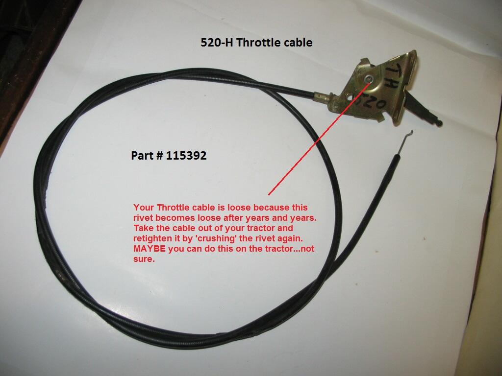

1978c81 385 #1 Posted July 14, 2022 My 97 520 will not stay at full throttle. The cable will move on its own from full throttle to half throttle. I tried tightening the nut but still no good. Just want to make sure its the cable as it's not cheap. Thank you. Any ideas? Share this post Link to post Share on other sites
daveoman1966 3,884 #2 Posted July 14, 2022 You'll have to tighten the rivet in the mounting bracket. Here is the best pic I ahve. 4 Share this post Link to post Share on other sites

roadapples 6,987 #5 Posted July 14, 2022 Some of us have drilled out that rivet and replaced it with a small bolt and nylock nut. Then you can adjust tension... 3 Share this post Link to post Share on other sites
Handy Don 17,463 #6 Posted July 14, 2022 3 hours ago, roadapples said: Some of us have drilled out that rivet and replaced it with a small bolt and nylock nut. Then you can adjust tension... This works well. Note that there are a number of washers and spacers in that assembly--be sure to put them back in the same order. Also, put the nut on the side toward the battery so you can easily access both the head and the nut for tension adjustments later on! 1 1 Share this post Link to post Share on other sites
1978c81 385 #7 Posted July 15, 2022 Thank you for those who the took the time to respond. I tried at first to compress the rivet with plyers. It didn't help. I ended up putting the throttle side in the vise and it worked well. 3 Share this post Link to post Share on other sites
tunahead72 2,662 #8 Posted July 15, 2022 17 hours ago, 1978c81 said: ... I tried at first to compress the rivet with plyers. It didn't help... For future reference, vise grips work well for this. You can start with a light bit of pressure, test the throttle, increase pressure if necessary and continue from there. I can't say for sure on the 520, but I've always been able to tighten mine on the tractor, without removing the cable. 2 Share this post Link to post Share on other sites
