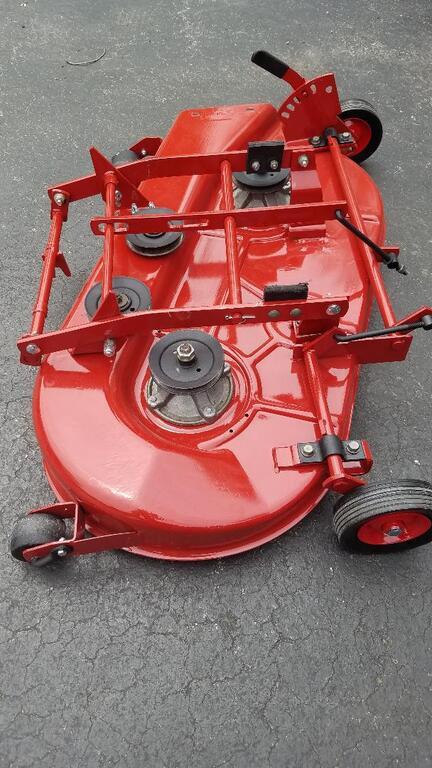

kpinnc 18,884 #2 Posted July 13, 2022 (edited) The best cut you'll find for a 310 or 312 is the 37 side discharge. The 6 inch front wheels on those machines are there specifically for use with the 37 inch deck. A tractor with 8 inch front wheels will make contact with the 37 inch deck. The other option is a 42 side discharge. A properly maintained 42 side discharge gives a decent cut, just not as nice as the 37. The 37 side discharge has two blades that are longer than the three blades on a 42, so the tip speed is higher for the same RPM, and the deck design of the 37 is high lift as well. If your 36 rear discharge clumps, then any rear discharge will give the same results. Rear discharge decks have a beautiful cut, but only if you cut regularly when there is very little growth from the previous cut. Side discharge distributes clippings better. Not my pic, but the one below is a 37 SD. Edited July 13, 2022 by kpinnc 2 Share this post Link to post Share on other sites

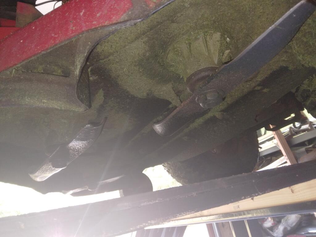

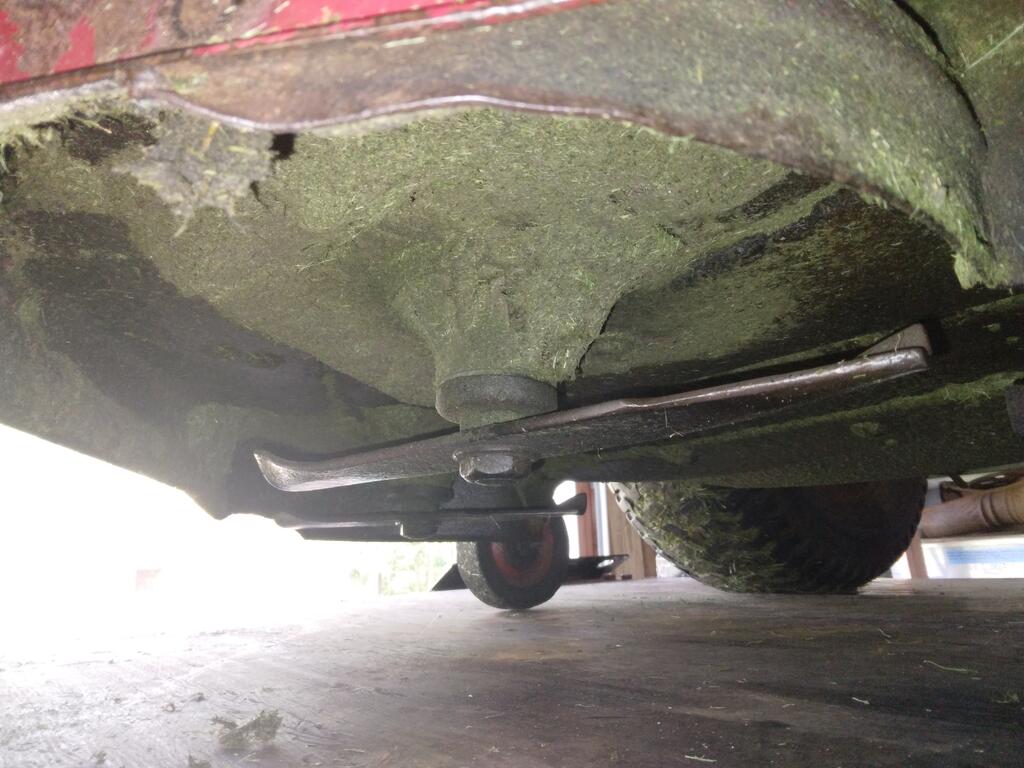

squonk 47,887 #6 Posted July 14, 2022 Lets see a pic of the deck and blades that are giving you the bad cut Share this post Link to post Share on other sites

matt monte 232 #8 Posted July 14, 2022 thank you everyone for your input. its alot to take in. Other than sharpen blades, ive done nothing to this basically free deck. i bought mule drive off someone, he threw in this rusted out deck. Assuming rear tires are not stock cause when i used to back this into my shed, which doesnt have a steep ramp, tires used to bind up into rear of deck. only cause deck is shot i made some "custom" cuts to remedy this issue. now that i think of it i have no idea how much slack should be in belt to mule drive. im aware im expecting landscaper quality results out of 25yr old equipment that was cobbled together. Now i narrowed my hunt for a deck at least. So use the 312 to mow and keep 308 for snow plow use and yard trailer stuff? Ok Share this post Link to post Share on other sites

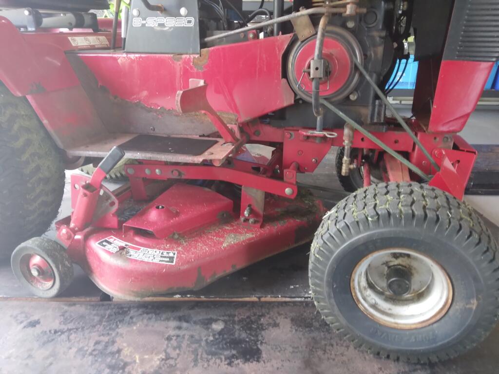

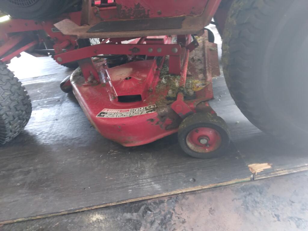

Handy Don 17,316 #10 Posted July 14, 2022 1 hour ago, matt monte said: This might be a "decent" deck. Those are stock wheels (though it looks like the grease zerks haven't been used since their factory installation) and don't look bad. The blades look ok (should be tested for balance and straightness, of course). The whole deck looks a bit crooked to me, as though it ran into something on the left front. I don't see a lot of rustthrough but the matted grass may be hiding some sins! The deck is definitely NOT leveled properly (the front anti-scalp wheel should NOT be touching the ground with the deck lowered on a flat surface. As for the backing up, usually it's best to lift the deck when navigating any ramps or obstructions. Download the deck manual from this site to guide your investigation. Search using the model number on the deck's info sticker. If the deck is (or can be) straightened and adjusted and the spindles are good, it may be worth restoring. Share this post Link to post Share on other sites
