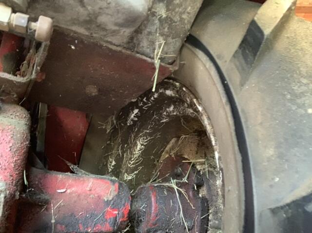

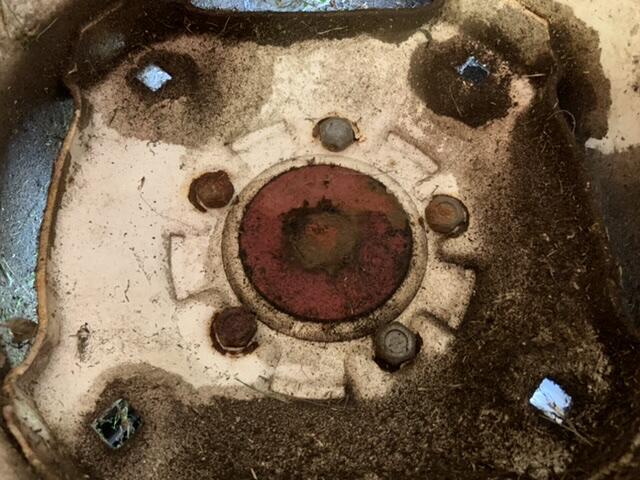

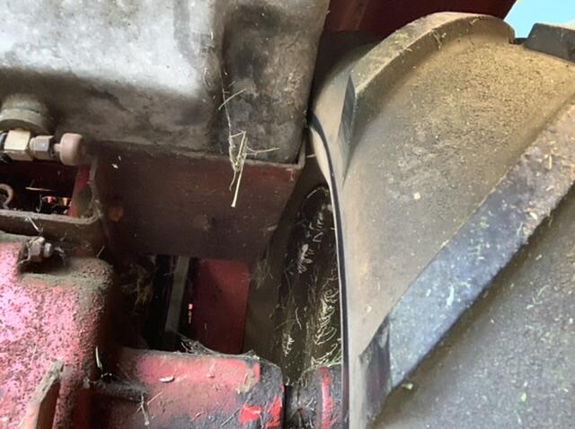

John2189 594 #1 Posted July 11, 2022 Ok the right tire is rubbing on the inside. The hub is flush with the axle. The other side seems to be ok. The tire size is 23-10.5-12 What could be wrong? Could the axle move sideways on the frame? Can I move the hub out a bit? it was this way when I got it last year, just never used it much until now. Share this post Link to post Share on other sites
OutdoorEnvy 1,816 #2 Posted July 11, 2022 Is the tire mounted backwards on the rim? The rim has an offset so if they put the tire on wrong it would sit closer and possibly rub like yours is. Moving the hub out a little would work. But if it matches the other side I would think that’s not the issue. this is half the fun of getting a new “used” rig. Sorting out all the “ what the heck did all the PO’s do to this thing” issues. Share this post Link to post Share on other sites
Achto 32,095 #3 Posted July 11, 2022 Looks to me like you may have the wrong rims. 1 hour ago, John2189 said: The center plate of the rim should be closer to the inside. 1 1 Share this post Link to post Share on other sites
pacer 3,180 #4 Posted July 11, 2022 Seems that your pics are of both sides, correct? If so comparing the space between the case and hub is quite a difference. The one hub seems to have less space between the case and hub and the other having about an inch space.... Been to long since I went into a tranny so I dont remember if the axle could move internally, but somehow it looks like yours may have? Share this post Link to post Share on other sites
John2189 594 #5 Posted July 11, 2022 32 minutes ago, pacer said: Seems that your pics are of both sides, correct? If so comparing the space between the case and hub is quite a difference. The one hub seems to have less space between the case and hub and the other having about an inch space.... Been to long since I went into a tranny so I dont remember if the axle could move internally, but somehow it looks like yours may have? Yes both sides. They measure the same from the housing. Everything looks like it should. Share this post Link to post Share on other sites

Handy Don 16,942 #8 Posted July 11, 2022 The distance from the center hub plate to the inner edge of the rim is called "backset" and yours is too deep. I suspect those are not WH wheels. There is no way to move the axle outward and it is correct to have the outer surface of the hub flush to the end of the axle. 3 Share this post Link to post Share on other sites
John2189 594 #9 Posted July 11, 2022 17 minutes ago, Handy Don said: The distance from the center hub plate to the inner edge of the rim is called "backset" and yours is too deep. I suspect those are not WH wheels. There is no way to move the axle outward and it is correct to have the outer surface of the hub flush to the end of the axle. Ok so best way to fix it would be spacers. I know some tractors you have to add spacers to run tire chains. or let it rub. Does not look like it is doing any damage other than the mark on the tire Share this post Link to post Share on other sites
roadapples 6,987 #10 Posted July 11, 2022 Agree with Achto. Definitely not wheel horse wheels. Back space should be 1 3/8".... 1 Share this post Link to post Share on other sites
Achto 32,095 #11 Posted July 11, 2022 56 minutes ago, John2189 said: Ok so best way to fix it would be spacers This would be one way to fix the issue and nothing wrong with this idea. Other fix would be to find correct rims. 3 Share this post Link to post Share on other sites
John2189 594 #12 Posted July 11, 2022 6 hours ago, John2189 said: Ok the right tire is rubbing on the inside. The hub is flush with the axle. The other side seems to be ok. The tire size is 23-10.5-12 What could be wrong? Could the axle move sideways on the frame? Can I move the hub out a bit? it was this way when I got it last year, just never used it much until now. Tractor Data says the tire size should be 23-9.50-12. It has 23-10.5-12. Could the tire be too big? john 1 1 Share this post Link to post Share on other sites
rjg854 13,180 #13 Posted July 11, 2022 Yes that may also be part of the problem. 1 Share this post Link to post Share on other sites

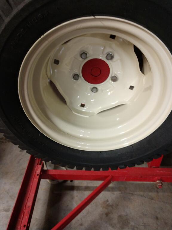

kpinnc 18,744 #14 Posted July 11, 2022 6 hours ago, Achto said: Looks to me like you may have the wrong rims. Agreed. The "dish" is backwards on those wheels. Common on other brands, but not Wheel Horse. Should look more like thie pic below. 1 Share this post Link to post Share on other sites
John2189 594 #15 Posted July 12, 2022 19 hours ago, kpinnc said: Agreed. The "dish" is backwards on those wheels. Common on other brands, but not Wheel Horse. Should look more like thie pic below. Best that I can see is my rims look like yours , just not as pretty Share this post Link to post Share on other sites
pfrederi 20,867 #16 Posted July 12, 2022 Most all WH rims have a 1-3/8 backset ...many other brands used 2-3/8. Lay a straight edge across the rim measure down to the bolt holes... Share this post Link to post Share on other sites
Jeff-C175 7,209 #17 Posted July 12, 2022 24 minutes ago, John2189 said: look like Sure... they may 'look like', but if the backspace is greater, you can have issues such as you are experiencing. Measure the backspace on your wheels. This is a 'standard' WH wheel. Tire is mounted and straight edge is not flush to the wheel rim as shown in second photo so you need to subtract that measurement from the first. This is the BACK side of the wheel, not the front. These measurements are not 'perfect' there may be a bit of flex in the straightedge I used (a broken tape measure), but it shows approximately the 1-3/8" backspace that the WH wheels have. If you've got more than that, they aren't the correct wheels. Share this post Link to post Share on other sites
wallfish 20,219 #18 Posted July 12, 2022 Loosen the hub set screws and slide them out 1/4"- 1/2", lock'm back down and be done with it. Unless you're using it to move 20,000 lbs RV trailers or jumping like Evil Knevil it'll be fine. Highly doubtful you could damage anything even if you tried. Simple way to solve a simple problem. Not necessarily the correct way of correct rims or correct tires but it corrects the problem. Change them when you need new tires Share this post Link to post Share on other sites
John2189 594 #19 Posted July 12, 2022 19 minutes ago, wallfish said: Loosen the hub set screws and slide them out 1/4"- 1/2", lock'm back down and be done with it. Unless you're using it to move 20,000 lbs RV trailers or jumping like Evil Knevil it'll be fine. Highly doubtful you could damage anything even if you tried. Simple way to solve a simple problem. Not necessarily the correct way of correct rims or correct tires but it corrects the problem. Change them when you need new tires I will try that. If they move Share this post Link to post Share on other sites
wallfish 20,219 #20 Posted July 12, 2022 1 minute ago, John2189 said: If they move Yeah, that's the fun part. Soak'm if they're stuck. Driving around with the set screw loose can help too Share this post Link to post Share on other sites
Jeff-C175 7,209 #21 Posted July 12, 2022 49 minutes ago, wallfish said: lock'm back down And they should be 25-30 ft-lbs of torque. You won't achieve that with a combination wrench. You'll need an 8 point socket and a ratchet handle. 1 Share this post Link to post Share on other sites
