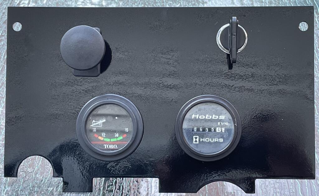

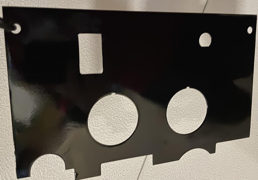

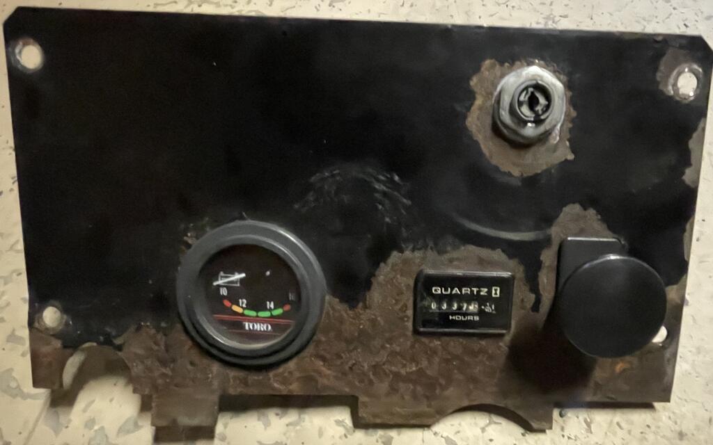

RustyGold 88 #1 Posted July 10, 2022 (edited) The 315-8 Existing control panel was rusted through. A New or used 315-8 panel is impossible to find because the hole layout is rare . My solution…. I used a 312-8 panel. I upgraded from the rectangle to the round hour meter, cut a rectangular hole for my oem electric PTO switch. Then sanded , prime , & 4 coats of paint . Came out nice . I like the (2) matching round meters better & the new PTO switch location ! Edited July 10, 2022 by RustyGold . 3 8 Share this post Link to post Share on other sites

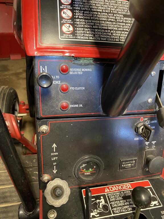

Sparky-(Admin) 26,621 #4 Posted July 10, 2022 Doesn’t your 315-8 dash have 3 indicator lights for PTO clutch, oil and something else (can’t recall what it is) ? Share this post Link to post Share on other sites
Sparky-(Admin) 26,621 #5 Posted July 10, 2022 21 minutes ago, Sparky said: Doesn’t your 315-8 dash have 3 indicator lights for PTO clutch, oil and something else (can’t recall what it is) ? Never mind…I made a rookie mistake. Took the long walk to the shed to look at mine and realized the indicator lights are in the upper piece. Share this post Link to post Share on other sites
RustyGold 88 #6 Posted July 10, 2022 31 minutes ago, Sparky said: Never mind…I made a rookie mistake. Took the long walk to the shed to look at mine and realized the indicator lights are in the upper piece. Nice machine 👍. The 315-8 are a rare beast . Very hard to find model specific parts 1 Share this post Link to post Share on other sites
