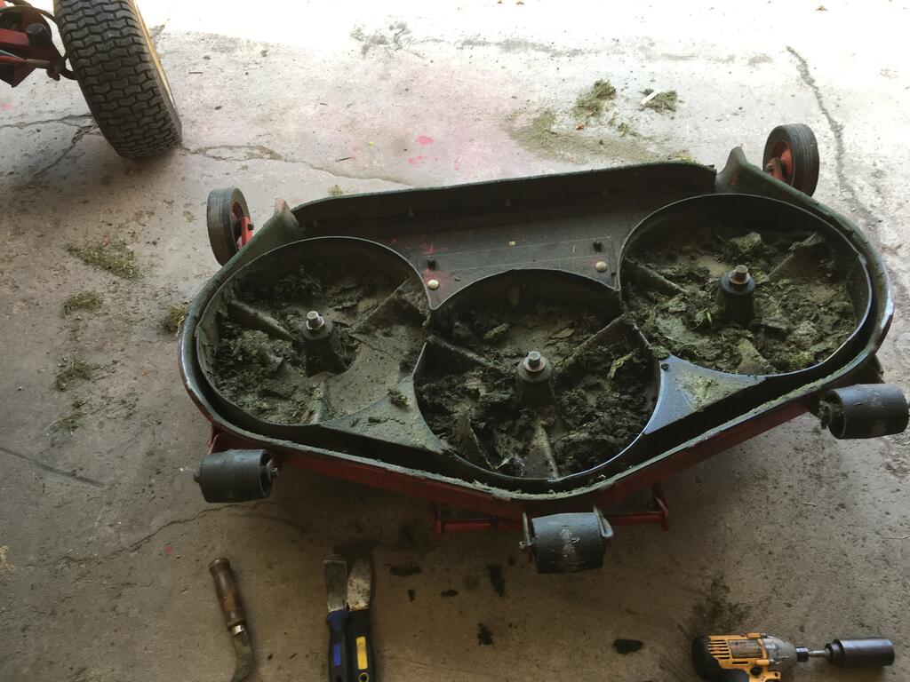

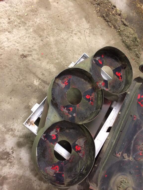

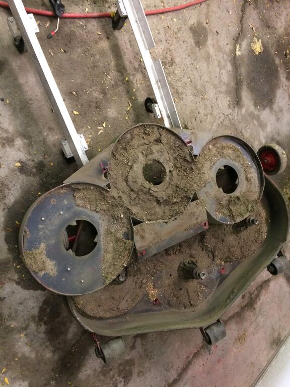

squonk 45,616 #5 Posted July 10, 2022 I love my recycler deck. But it takes a lot more maintenance and it weighs almost twice as much as a regular deck. This is a normal grass buildup: Taking the insert out you can see how much grass/powder gets in between: 2 Share this post Link to post Share on other sites

squonk 45,616 #9 Posted July 10, 2022 1 hour ago, EB-80/8inPA said: @squonkHow often do you have to give that a thorough cleaning? Depends on how the grass is growing. In the spring when it's growing fast I raise the tractor and scrape out the deck every other mow. After the Big Show I do a "Summer Service" on the tractor and yank the deck apart. What you see in the pictures is typical of a couple of mows and what's between the deck and insert is typical for half a season. what's between the deck and insert is green powder. I haven't had to touch the actual inside of the deck in 6 years. 2 1 Share this post Link to post Share on other sites
