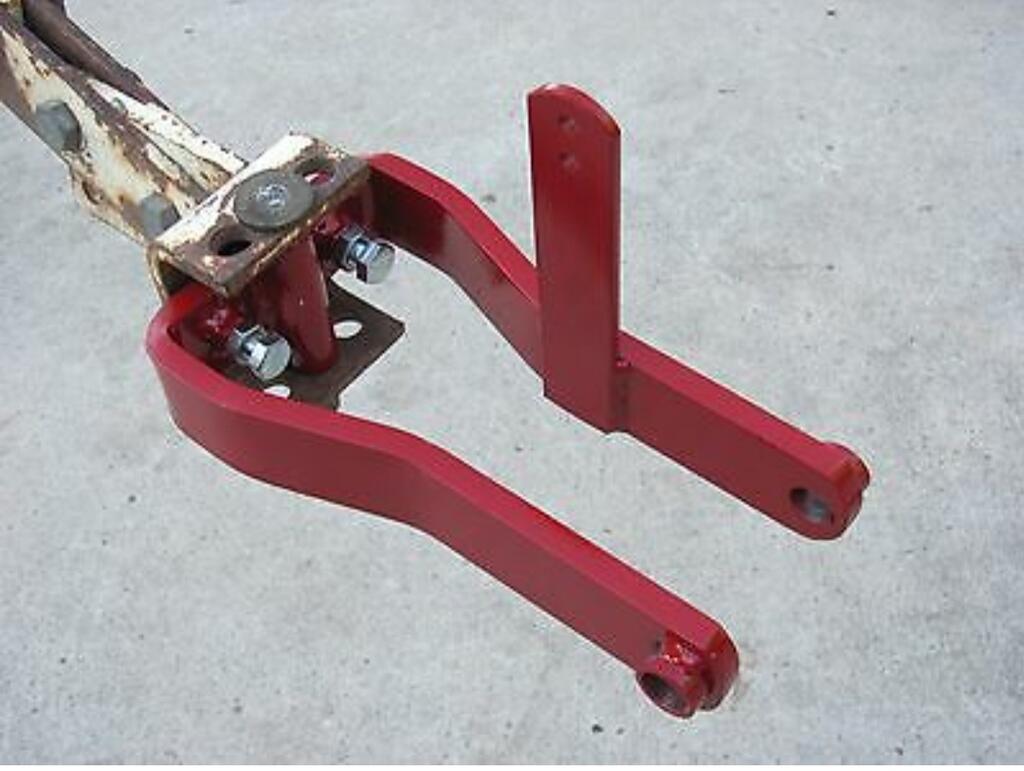

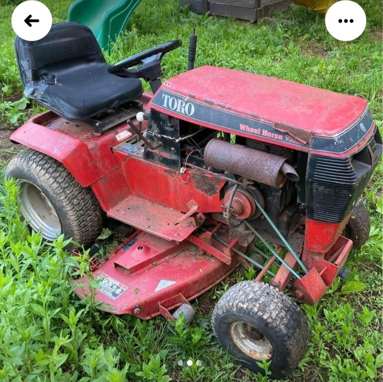

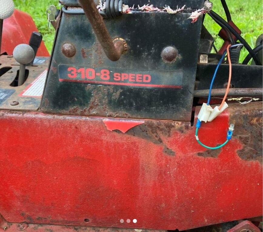

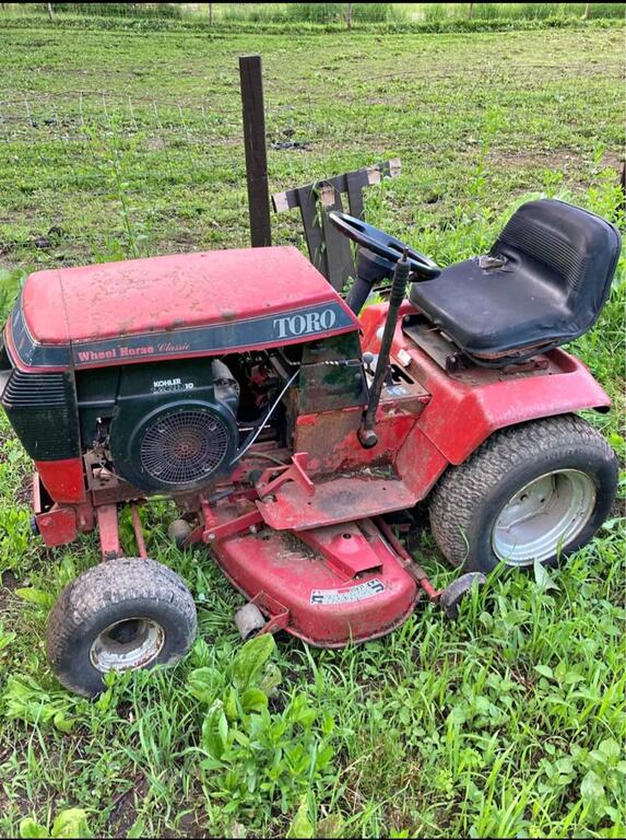

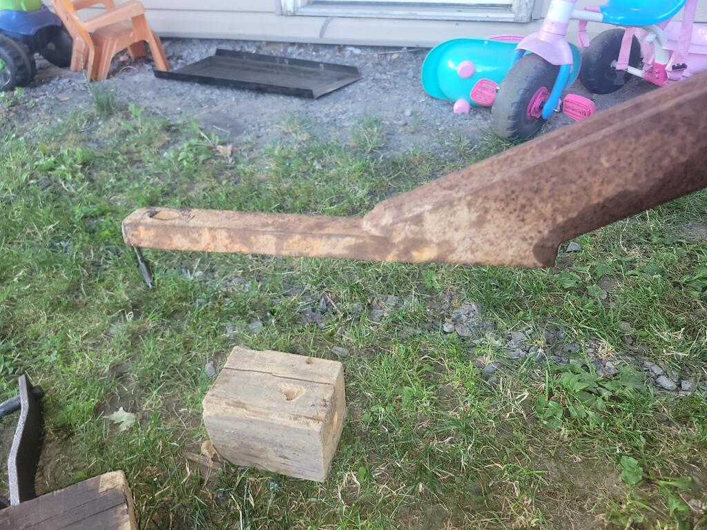

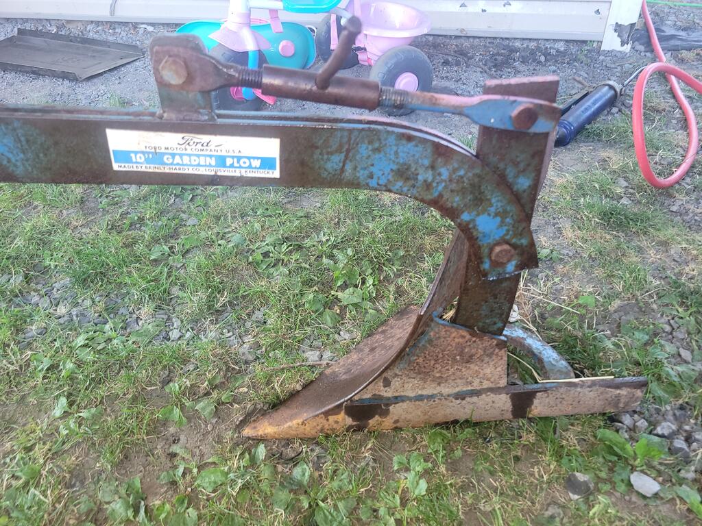

Mattryan624 24 #1 Posted July 9, 2022 (edited) Hello, Couple more questions, do the newer toro 310-8s made in I'm guessing the 90s and the older wheel horse branded 310-8s still use the same deck? I've attached a picture of the tractor I'm talking about. If it fits going to buy the whole tractor. Not sure of the differences between it and my 85 besides the engine. I also got this plow for free and wondering if it will fit on a clevis hitch. If I have to I can have the hitch altered to be like the newer brinley one. I bought a almost brand new cultivator and he had this as well. Pictures below Edited July 9, 2022 by Mattryan624 2 Share this post Link to post Share on other sites
gwest_ca-(File Mod) 12,256 #2 Posted July 10, 2022 Attachments for 1973 and later up to the last in 2012 all fit. The pictures are of a 1990 model or later. 3 Share this post Link to post Share on other sites

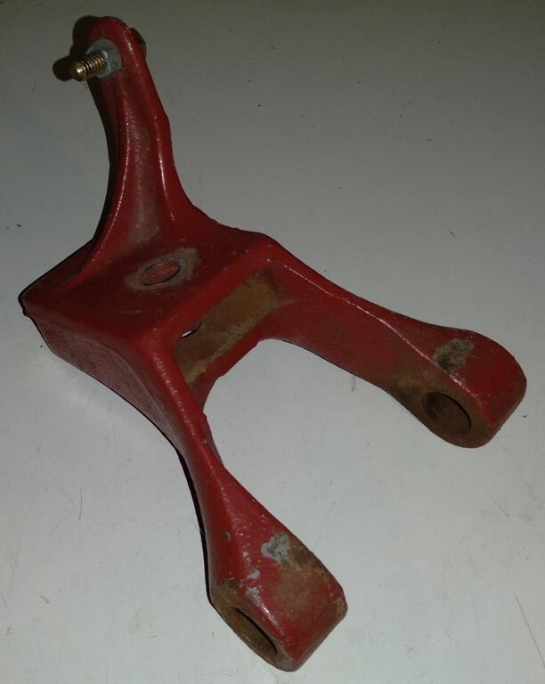

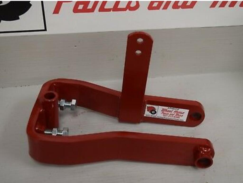

Mattryan624 24 #3 Posted July 10, 2022 Anybody know anything about the plow. Looking at it I don't think it will work. I bought the hitch pictured below. Anyone have this hitch? Should have looked closer before I decided to take it home. It was free so just have to give it to someone. I got the deck and it works and is in good shape. It does need a rebuild. Share this post Link to post Share on other sites
Rick3478 454 #4 Posted July 10, 2022 15 minutes ago, Mattryan624 said: Anybody know anything about the plow. Looking at it I don't think it will work. Plow does not fit that hitch, but might fit the 3926 slot hitch, if it is 2" wide 5/8" thick or less, and the 3926 will fit your 310. 1 Share this post Link to post Share on other sites
Mattryan624 24 #5 Posted July 11, 2022 11 hours ago, Rick3478 said: Plow does not fit that hitch, but might fit the 3926 slot hitch, if it is 2" wide 5/8" thick or less, and the 3926 will fit your 310. Thank you! Share this post Link to post Share on other sites
