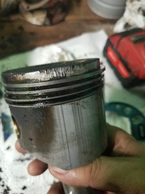

tntatro 184 #6 Posted July 10, 2022 I'm taking apart the engine that was originally on the tractor and the piston has some damage but it is still within the wear limits. Does this piston look okay to use? The ring end gaps are outside the wear limits so it needs new rings. The bore looks good except the very top where the piston damage was has carbon that's a little harder to hone out. I'm guessing that area above the top ring area is flared out of the limits a little but the main area of the bore is within wear limits. This engine had good power and didn't knock at all but used oil bad. Share this post Link to post Share on other sites
oliver2-44 11,694 #7 Posted July 10, 2022 I would not reuse that piston with the wear at the top 1 Share this post Link to post Share on other sites
squonk 47,890 #8 Posted July 10, 2022 Piston is junk. What tools are you using to measure the bore ect. Share this post Link to post Share on other sites
tntatro 184 #9 Posted July 10, 2022 14 minutes ago, squonk said: Piston is junk. What tools are you using to measure the bore ect. I have a micrometer set and bore gauge. Looking closer at the bore I see light scoring and I have a new .010" piston so I decided to bore it. I don't have money for a new piston. I'll see what I can do tomorrow. Share this post Link to post Share on other sites

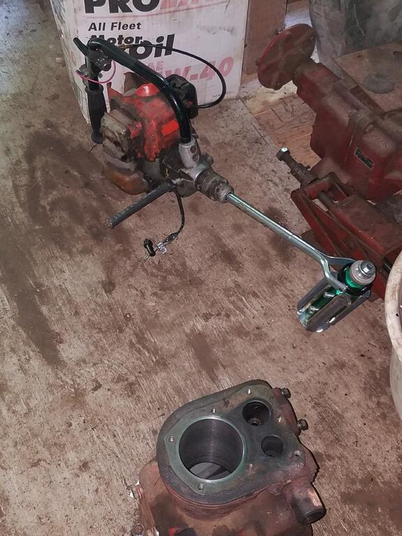

tntatro 184 #12 Posted July 14, 2022 I just tried running 92 octane and it didn't stop the knocking but it seems to run really well otherwise. I guess I'll have to take it apart and re check all the specs. I have the other engine half bored out. My 2 cycle drill malfunctioned just as I was going to re tighten the stones and as I had the hinge bent 90 degrees it let loose and went full throttle on me and cut my finger as it flopped around. Luckily there wasn't any damage to the hone or bore. I just have to let my cut heal a little before I can finish. Share this post Link to post Share on other sites
tntatro 184 #13 Posted July 14, 2022 Here's the drill I'm using. I actually have two, this one isn't the one that malfunctioned. That's a Lisle hone, I also have a Sunnen AN but my stones need to be trued. I started honing with the coarse stone and it was tapering the bore so I switched to the Lisle which has new stones. Share this post Link to post Share on other sites

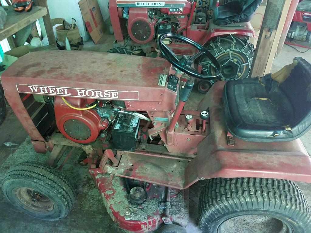

tntatro 184 #14 Posted July 14, 2022 Here's the B-80 8 speed. I also had to take the transmission apart and replace some bearings. The reduction gear shaft is pitted and the reduction gear bearings were froze up so I put good bearings in it but it still makes a noise when I drive. I got lucky and found a new shaft on Ebay so I'll have to put it in after I get the engine figured out. When I bought it I was hoping to be able to put little time and money into it to make it functional and sell it for a small profit. That didn't happen. Share this post Link to post Share on other sites
