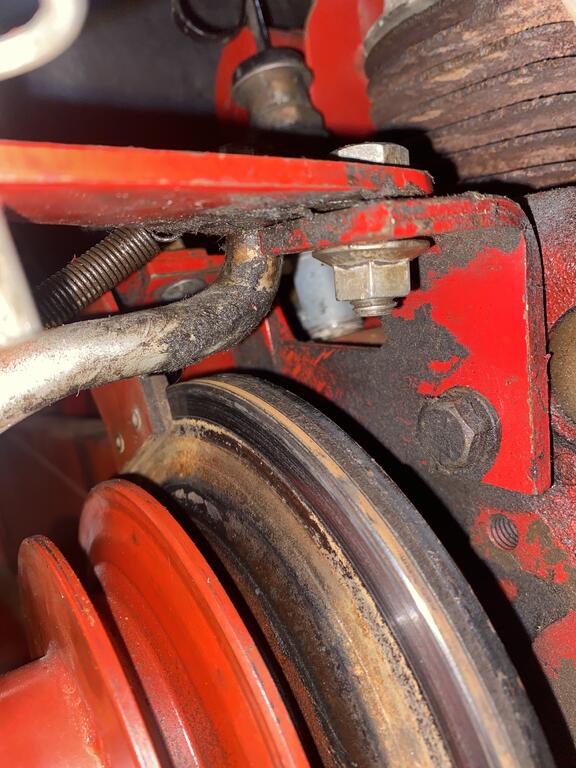

Heatingman 977 #1 Posted July 9, 2022 KS181 motor - B80 tractor What is here is just a bolt with a center bushing through the linkage plate (likely the wrong term) to the stationary mount bracket on the motor. There is a fair amount of slop in the movement. Its functional, but seems incorrect. Overtime I can see the bolt working loose just from use. And if overtightened, I would think the linkage would be bound. Share this post Link to post Share on other sites
Jeff-C175 7,207 #2 Posted July 9, 2022 Every machine I've ever seen has a fair amount of slop at that point but it really doesn't matter, that's just a pivot point. The nut should be an 'interference' type of lock nut and won't loosen, but as I recall there is a bushing in there also, so the nut will be tight and clamp the bushing. Never had one loosen up. 2 Share this post Link to post Share on other sites
ri702bill 11,256 #3 Posted July 9, 2022 Heeding the advise from @peter lena, I was able to minimize the play by adding a nylon washer and a thin (.015 or so) washer on the other side on my C81. 1 Share this post Link to post Share on other sites
gwest_ca-(File Mod) 12,000 #4 Posted July 9, 2022 https://www.partstree.com/models/61-08k803-b-80-toro-lawn-tractor-1976/14-050-manual-p-t-o-fig-14b-16/ Share this post Link to post Share on other sites
Ed Kennell 44,878 #5 Posted July 9, 2022 8 hours ago, Heatingman said: Overtime I can see the bolt working loose just from use. And if overtightened, I would think the linkage would be bound. The bushing is thicker than the base plate so the bushing should be tightly clamped to the swing arm with the bolt and flanged nut. The bushing will still be free to turn in the base plate and will not bind up and the nut will not work loose. 2 Share this post Link to post Share on other sites
Heatingman 977 #6 Posted July 9, 2022 Maybe thats the issue. Bushing a bit worn out. I’ll see if I can find/make a better bushing. 1 Share this post Link to post Share on other sites
peter lena 9,764 #7 Posted July 9, 2022 @Heatingman typically found that linkage / lever points on the horses were not the best , and very often totally neglected , for maintenance , and zero lubrication . H/W store , pullout drawer section , for small bronze bushings . even went to related pto lever end with added HEIM joint . also eliminated the , bearing cone brake pad , use lucas h/d hi temp grease on the inner needle bearing ,eliminate the issue . that area is a gold mine for improvements , helped me go rogue , greasy pete Share this post Link to post Share on other sites
