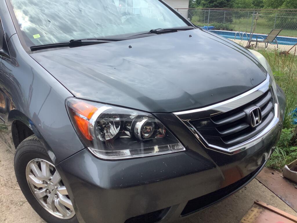

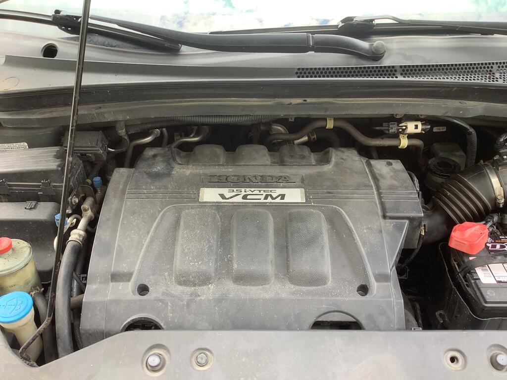

Pullstart 68,700 #1 Posted July 8, 2022 Ever watch those things? Customer states: I did my own brakes… Customer states: I hear a grinding noise… Today’s “Customer States” for Pullstart Stables Auto Shop Bonanza? 2010 Honda Oddesey, 3.5L V6, 134,300 miles. Check engine light on. Shop next to their work says misfire in #2. “We get these all the time. You need new heads, the valve seats are coming loose.” It came here for a second opinion. I was skeptical that it needed any head work done. I pulled the intake, injectors, cleaned ‘em, put it back together, changed out $18 a piece spark plugs and there’s your head job. One of the plugs had a broken ceramic and a couple others were just due for a replacin’ I feel good about charging them $400 for a good Ole fashioned tune up and they don’t have to finance a repair bill! 1 10 Share this post Link to post Share on other sites

wh500special 2,370 #6 Posted July 8, 2022 Unless it has been done, at 134k that engine is also overdue for a timing belt, tensioner, water pump, and valve lash adjustment. I think Honda sells the the first three of those items as a kit. My 105k Odyssey is due and it's $1100 at the local independent. I didn't check with the dealer. I looked at doing it myself and it's beyond my patience level as there is a lot of overburden to get out of the way first. I am convinced very few owners actually bother with the timing belt service and that the belt's recommended service life is wildly conservative. But they are interference engines so it's a roll of the dice. A coworker has that same engine in a Pilot and he's at 12 years old and 235k and still on the original belt and valve lash. As reliable as Hondas are, their engines - like that one - with the Variable Cylinder Management (VCM) have a reputation for consuming oil and needing new piston rings on the cylinders that shut down intermittently to save fuel. This often first manifests in a check engine lamp with the code for a cylinder misfire. If you checked the oil and found it low you might want to look deeper. This isn't a unique Honda problem. Variable displacement in most of its iterations across manufacturers has its limits. FYI. Steve 2 Share this post Link to post Share on other sites
