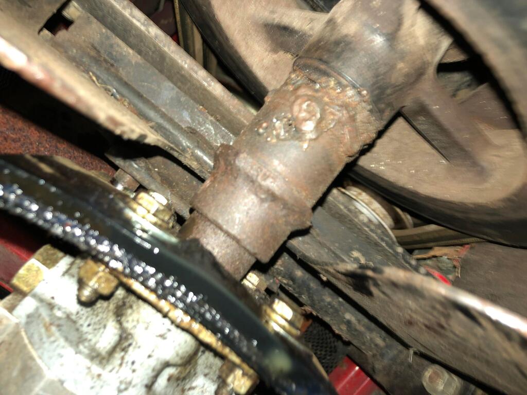

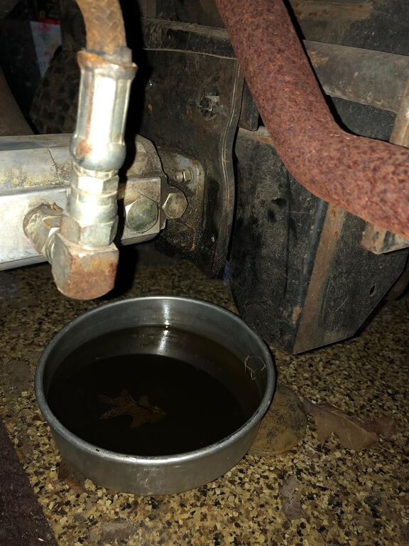

1957allis 9 #28 Posted February 20, 2023 Hello S416-8... Just picked up the Troybilt version of your Bolens... and trying to rework the loader pump as it currently has a leaking log splitter pump (quart per week) welded to the PTO shaft and a little too much "re-engineering". Found the proper pump, coupler and have an extra PTO assembly for it... Was wondering if you have any pictures of the rubber mounting plate that pump mounts too or if you know the thickness... I think I am going to have to make it.. I was looking at baler belting 3/16 (too thin) and then found conveyor belting (minimum 15 feet) but 13/32... so still thinking Thank-you for your time, Tom in Michigan 1 Share this post Link to post Share on other sites

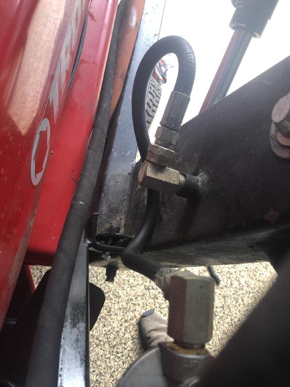

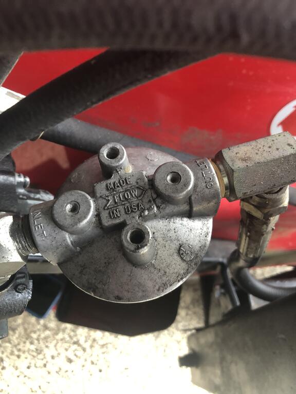

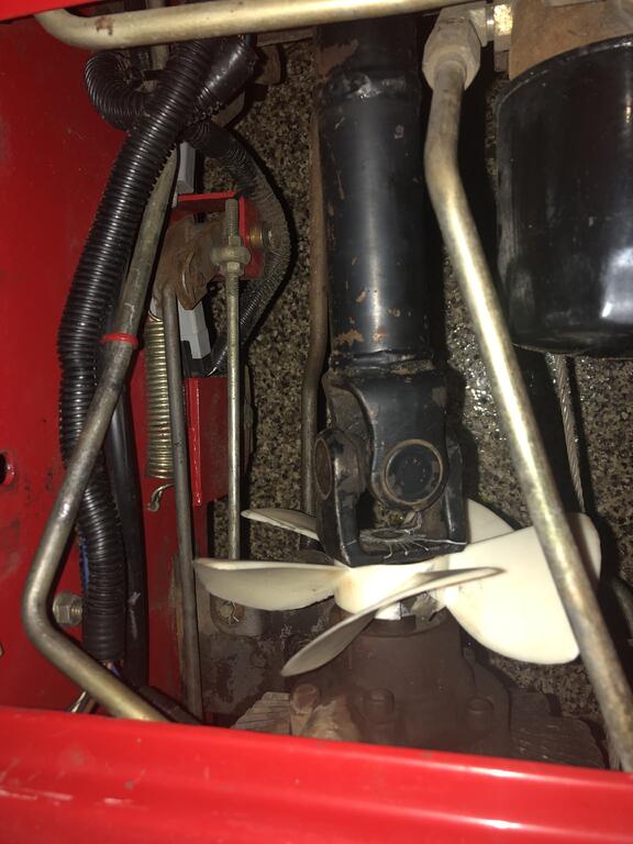

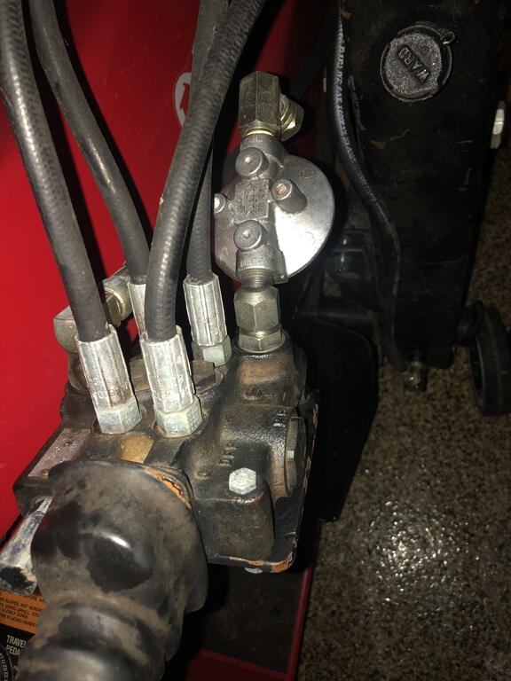

1957allis 9 #48 Posted March 25, 2023 Good Morning S416-8... Finally getting back into the tractor... seems like everybody has gotten sick in our house recently. My engine fan is okay, it was the transmission fan that needed to be replaced and completed the dash changed over.. steering wheel did not like coming off, although the drive shaft came off surprisingly easier then I expected. Now on to the pump / hoses, etc. I was looking at your pictures and noticed my return line was routed to the wrong place.. so corrected that and the hose "likes" the proper routing better. Going to work on getting the old pump off this weekend... since the adapter is welded to shaft. 1. Curious how did you cut the belting material? Plan on using a hole saw to cut the large hole and was thinking maybe a hack saw.. but that may take a while. 2. Also I notice they do not sell the hydraulic filter any more.. Do you happen to know what filter number you have on your tractor? Previous owner had a car oil filter that seemed to leak and was mostly empty so not sure if anything was evening going into it, not even sure if it is the right "head" at this point with so many other mods to the tractor. Sorry for so many questions and any insight is appreciated.. I guess if I ever get if done I will know a lot about it and it should be "right". Tom 1 Share this post Link to post Share on other sites
S416-8 399 #49 Posted March 25, 2023 GM and I can get you the filter numbers. I brought the old one to NAPA, they ran the cross references and got me the one that works. I used a razor knife to cut that belt to size (actually worked out great), a hole saw for the main hole and a drill bit for the others. Share this post Link to post Share on other sites
