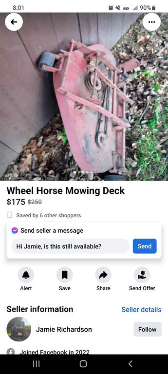

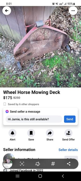

Mattryan624 24 #1 Posted July 7, 2022 (edited) Hello, Would this deck fit a 310-8. It looks like an attach a matic deck but I'm not sure. Thanks, Matt Edited July 7, 2022 by Mattryan624 Share this post Link to post Share on other sites
OutdoorEnvy 1,816 #2 Posted July 7, 2022 That should fit. Share this post Link to post Share on other sites
Rick3478 454 #3 Posted July 7, 2022 Yeah 36" rear discharge. I assume you already have a mule drive (two pulleys with long belt on front of tractor). If not you'll need to find one of those, too. 1 Share this post Link to post Share on other sites
Mattryan624 24 #4 Posted July 7, 2022 I have a mule drive just need the belt. Thanks guys. 1 Share this post Link to post Share on other sites
Mattryan624 24 #5 Posted July 7, 2022 Do any of you guys know if the rebuild parts are available for this? New blades? Thanks. Share this post Link to post Share on other sites
peter lena 9,942 #6 Posted July 7, 2022 @Mattryan624 if you get that deck , scrap down ,would start an immediate aerosol lubrication soaking on that to , help feed that starved metal, would also leave it upside down in the sun , to heat up and assist that metal soak , measure your blades , available at many sources . lubricate topside and spindles , belt tension slide tension area , probably replace belt , oil / grease deck wheels . recovering any deck can be a learning experience . hope it works out for you , pete @ mattur 2 Share this post Link to post Share on other sites
