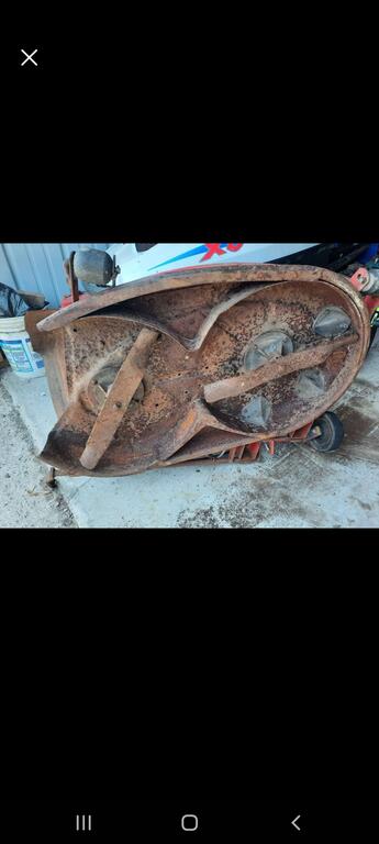

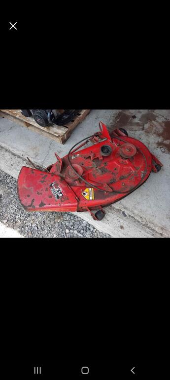

Mattryan624 24 #12 Posted July 6, 2022 He says it's 42 looks smaller to me, anyway maybe you guys could tell of it's missing anything. It definitely needs some work, hopefully I can get parts to fix what needs to be fixed or replace what is missing. Share this post Link to post Share on other sites
Sparky-(Admin) 26,322 #13 Posted July 6, 2022 Oh boy…that’s not the correct style deck for your tractor. Hope you didn’t buy it already! 1 Share this post Link to post Share on other sites
Mattryan624 24 #14 Posted July 6, 2022 (edited) 35 minutes ago, Sparky said: Oh boy…that’s not the correct style deck for your tractor. Hope you didn’t buy it already! Nope not yet. Thank you. I told him never mind. Now just to find one. Any chance you know what wheel horse that deck fits. The guy is saying someone told him it was off a 414-8 which Is why I thought it would fit mine. Thank you! Edited July 6, 2022 by Mattryan624 Share this post Link to post Share on other sites
Jeff-C175 7,211 #15 Posted July 6, 2022 1 hour ago, Mattryan624 said: needs some work Understatement of the year! Looks almost beyond repair from here. Welcome to the forum! 1 1 Share this post Link to post Share on other sites
Jayzauto 89 #16 Posted July 6, 2022 That deck looks to be from the 260 SERIES Toro/WheelHorse. Looks to be missing quite a few parts..... Very rough...... The Flap is about the onl thing worthwhile on that.... IF it's original to the deck.... GLuck, Jay 1 Share this post Link to post Share on other sites
Sparky-(Admin) 26,322 #17 Posted July 6, 2022 1 hour ago, Mattryan624 said: Now just to find one. Try posting a wanted ad in the classifieds right here on Red Square and mention your location. Share this post Link to post Share on other sites

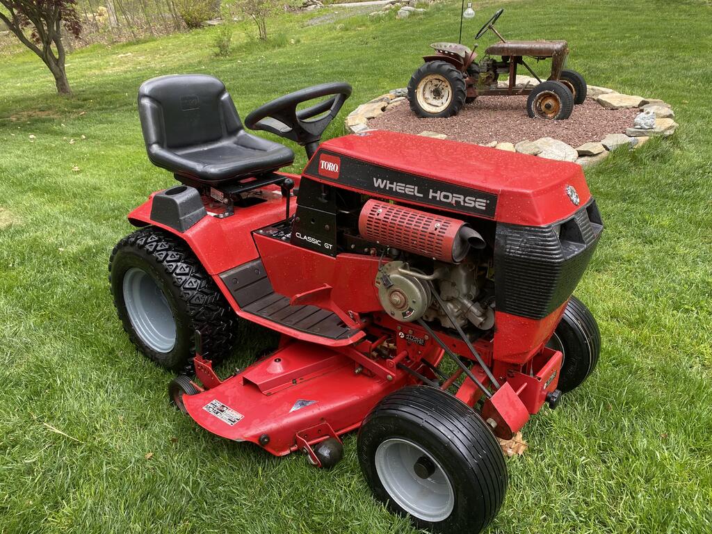

Lee1977 7,764 #18 Posted July 6, 2022 This is not the best picture but this is the type of 42" deck that will fit your tractor. Check the deck at the height lever as this is where the 42" decks crack and rust out. They can be fixed but may get you a cheaper price. Share this post Link to post Share on other sites
Mattryan624 24 #19 Posted July 6, 2022 1 hour ago, Jeff-C175 said: Understatement of the year! Looks almost beyond repair from here. Welcome to the forum! Lol thank you, guess I dodged a bullet. Have a feeling finding a deck for this that's not a pile of rust is going to be a challenge. Share this post Link to post Share on other sites
Sparky-(Admin) 26,322 #20 Posted July 6, 2022 I don’t think it’s a challenge…the deck you need is referred to as the Attach-A-Matic style deck which were made from 1973 to the end of production of the classic garden tractor, which I think was 2007. Plus you don’t live where Wheel Horses are scarce such as the west cost. I would think you could find one in NY. We have plenty of members in NY as well so maybe one of them has a deck. Most of us who have been bitten by the “bug” have piles of mowing decks. I personally have at least 6 Attach-A-Matic style decks Share this post Link to post Share on other sites

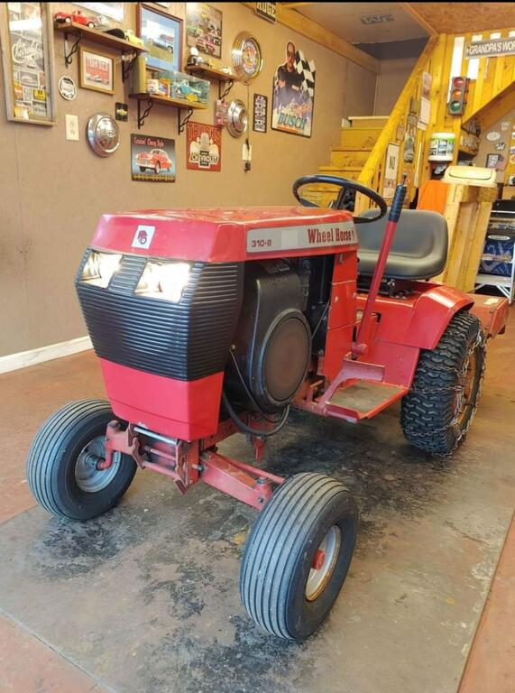

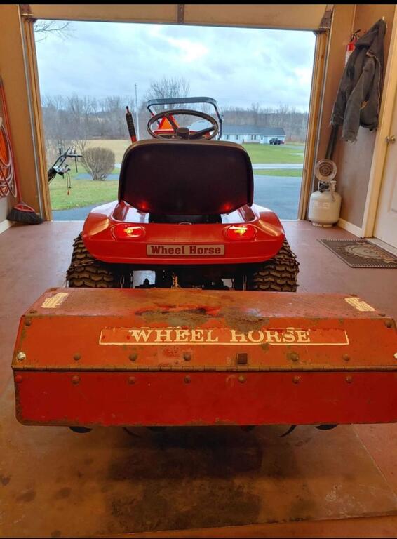

Mattryan624 24 #22 Posted July 8, 2022 On 7/6/2022 at 7:27 AM, ANTPER said: Would love see some pics of your tank. Almost forgot here she is. I love this tractor already, tillers not pretty but is rebuilt with new parts and functions flawlessly. Hope to repaint the tractor too. It should have the all red hood and will probably go back to that when I do paint it. The steering needs work , but works fine. Still not sure how I'm tackling that after reading about how difficult it is to remove the steering wheel. My ag tires came today I'm going to get them mounted up and bead blast my wheel weights and repaint them. Still hunting for a mower deck. Thank you all for the help so far. I gotta be careful though I already want to buy another one. 1 2 1 Share this post Link to post Share on other sites
rjg854 13,341 #23 Posted July 8, 2022 there are a few of us from your general area that are into 's. And yes they do like company, hope you have the room to keep them. Share this post Link to post Share on other sites
Jeff-C175 7,211 #24 Posted July 8, 2022 9 hours ago, Mattryan624 said: repaint the tractor I think it looks great! Not sure I would consider repainting that myself, but then I'm just a bit further away from it than you are! Share this post Link to post Share on other sites
