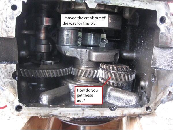

tim57chevy 12 #33 Posted July 8, 2022 (edited) OK so I was curious. I pulled the engine out of the C-120 and pulled the oil pan. Man these things hold a lot of oil even after draining them. So looked in the bottom and lo and behold the entire problem was the rod end nut fell off the connecting rod and the one was almost off. Every thing I can see in the block looks to be still good. I have a hone so I will cross hatch the cylinder prior to reinstall of new piston. What spec should I use for when the bore or crank needs to be redone. Engine was NOT smoking at all before this issue. I'm thinking just put a stock new set in and done.One other question. How the heck do you remove the Balance (Grenade) gears? I have seen several videos on You tube but they all show the gears after they are out of the engine. No help there. Edited July 8, 2022 by tim57chevy downsize pictures Share this post Link to post Share on other sites

squonk 46,834 #35 Posted July 8, 2022 That crank will need to be turned at minimum. the balance gears are held in with little snap rings. easy to get out once the crank is out. 3 Share this post Link to post Share on other sites
oliver2-44 11,515 #36 Posted July 8, 2022 To get the balance gears out you have to rotate the crank to find just the right spot to give you enough clearance to get them out. The lower one is easy, the upper one requires the crank in just the right spot. 1 Share this post Link to post Share on other sites

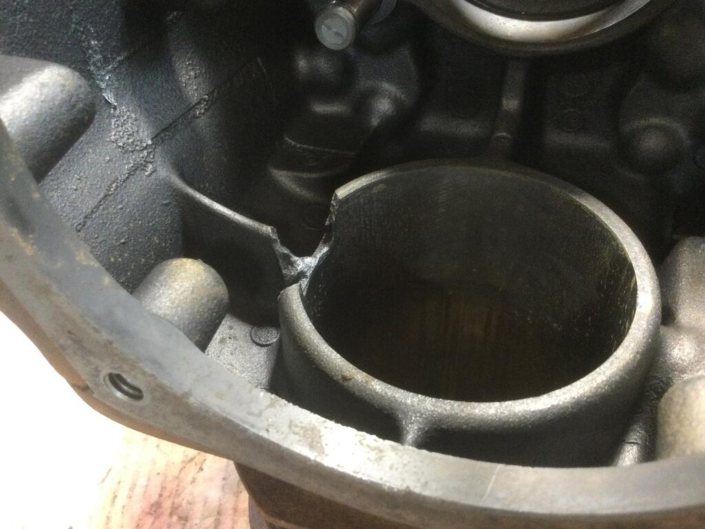

rmaynard 17,217 #39 Posted July 8, 2022 I bought a running K161 that apparently had a broken rod at one time. The only damage that I noted when I took the piston out was this: One side of the bottom of the cylinder is broken out, and the opposite side has a ding in it. No damage in the piston ring area. The rod was replaced with a STD (230519), and the crank journal looks good. I don't know if the crank was replaced or not, I doubt it. I'm going to Plastigage it and see what the clearance it. Not to try to get this thread off track, just wanted to say that sometimes a broken rod can be fixed simply without too much other part involvement. 1 1 Share this post Link to post Share on other sites

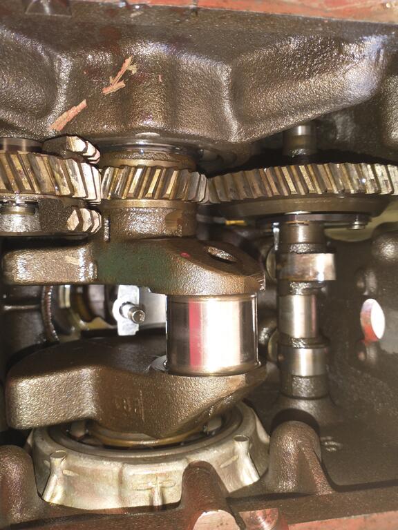

squonk 46,834 #41 Posted July 8, 2022 (edited) 8 minutes ago, rmaynard said: I bought a running K161 that apparently had a broken rod at one time. The only damage that I noted when I took the piston out was this: One side of the bottom of the cylinder is broken out, and the opposite side has a ding in it. No damage in the piston ring area. The rod was replaced with a STD (230519), and the crank journal looks good. I don't know if the crank was replaced or not, I doubt it. I'm going to Plastigage it and see what the clearance it. Not to try to get this thread off track, just wanted to say that sometimes a broken rod can be fixed simply without too much other part involvement. You have a lot of cylinder scoring on the left side. a new piston skirt will get torn up. Your rod broke high. When it comes apart at the crankshaft, usually the crank will need turning. Look at this picture. Crank looks real nice but it still needed turning. Edited July 8, 2022 by squonk 1 Share this post Link to post Share on other sites
Snoopy11 5,731 #42 Posted July 8, 2022 Yeah, that is what I am more used to seeing, little damage at sleeve area nearest crankcase... Seems like a much easier fix if the rod cap is the only problem... Don 1 Share this post Link to post Share on other sites

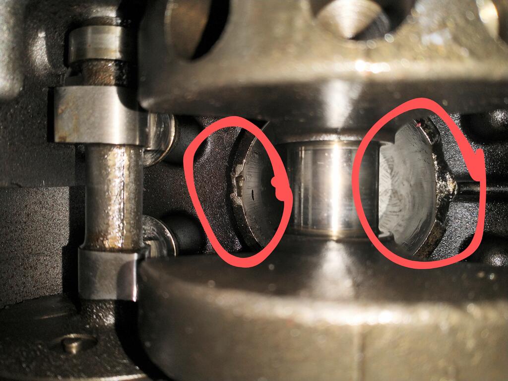

tim57chevy 12 #48 Posted July 9, 2022 Thanks Achto for the link to the Kohler manual. On the subject of the What is this in the picture above. It is a short tube. Is there something like that on one side of the connecting rod to keep the cap aligned? The connecting rod cap is the only thing I see damage on. Share this post Link to post Share on other sites
squonk 46,834 #49 Posted July 9, 2022 I see damage on the crank journal. 1 Share this post Link to post Share on other sites
