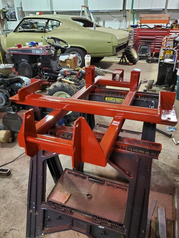

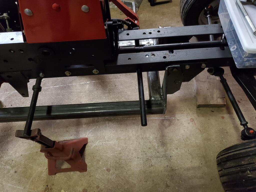

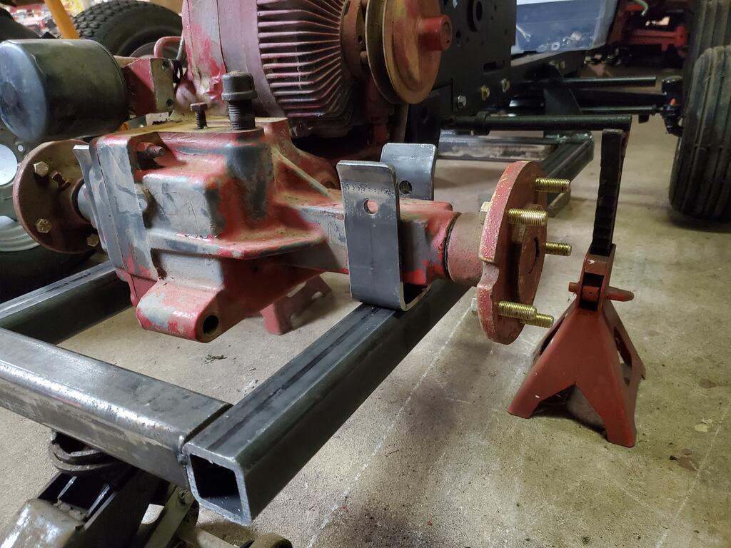

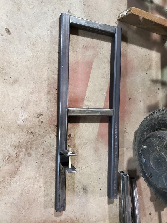

857lover 291 #31 Posted July 13, 2022 (edited) On 7/8/2022 at 2:20 AM, Thor27 said: Not a quick way, but same principle. Here are a few pics I took when building mine for an ARK. I tried to mimic the original as much as possible, I use the original front subframe, as well as the front hanger on this subframe. I used a disassembled tractor to mock it up and tac weld it together. If you want to take up welding, It would be a good project to learn on. Any questions just ask. I can get some measurements if helpful. Build the frame first, stick it in place and tac on the axle saddles, slide in the cross member and assemble the loader where it wants to sit, tack on the crossmember, remove and final weld. I plan to pull mine off for some tractor maintenance, when I do I will cut off the rear behind the axle so I can access the rear hitch pin and use a sleeve hitch again. I use a bolt instead of a pin above the axle, so there is a nut welded to the front uprights. Makes it easier to install with the wheels on. Don't see it here but there is a a 1/2" nut welded to the sadle for a tension bolt from underneath. I had set up a weight box to go in the receiver hitch, but it is a huge pita. I use loaded tires and inner outer weights instead as the weight box gets in the way and hangs up on stuff, but it would be nice to have the option, especially when you lift weight in front of the bucket.. I plan to make the box so I can lift it with the sleeve hitch so I can drop it on wheeled cart (think a steel furniture dolly) and roll it out of the way with out having to empty it. how long argue the two long peices that run the length of the frame ? just trying to figure out how many feet of squarestock i need and where did you get that clamp like thing that goes over the axel i asume you built it but hey worth the ask Edited July 13, 2022 by 857lover Share this post Link to post Share on other sites

Thor27 892 #34 Posted July 16, 2022 (edited) On 7/13/2022 at 3:08 PM, 857lover said: how long argue the two long peices that run the length of the frame ? just trying to figure out how many feet of squarestock i need and where did you get that clamp like thing that goes over the axel i asume you built it but hey worth the ask My front to back pieces are 2 x 2 x 1/4 and 43" long, but I do plan to cut 7" off the back. As mentioned before I want to be able to use a clevis hitch, but it would also be easier to install being shorter. The cross members are 11 1/2: the front drop plates appear to have been carved from 4 x 4 x 1/4 angle and they are 8" long. The clamp like thing on the axle was made from some 4 x 6 x 1/4 box tube cut to size and welded together draped over a wheel horse axle. (had to make them twice because I'd made the first set on an 8 speed axle). The crossmember the loader mounts to is 2 x 3 x 3/8 and 43 1/2" long. I know the wall thicknesses may be overkill, but I wanted the weight, as well as the rigidity. I would suggest you get the loader crossmember and uprights as far back as possible for a more stable tractor. (but pay attention to leave enough room for the hood to open some!) Edited July 16, 2022 by Thor27 correct typo Share this post Link to post Share on other sites
