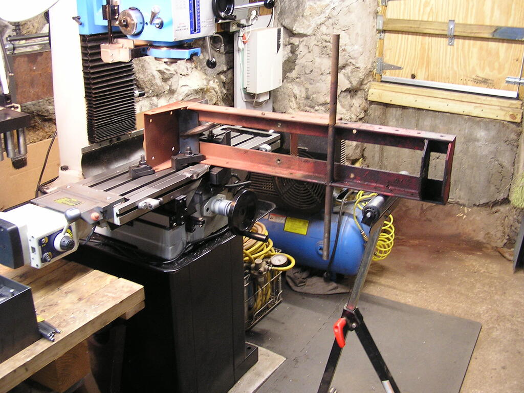

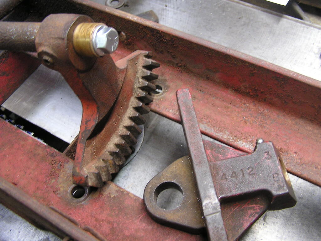

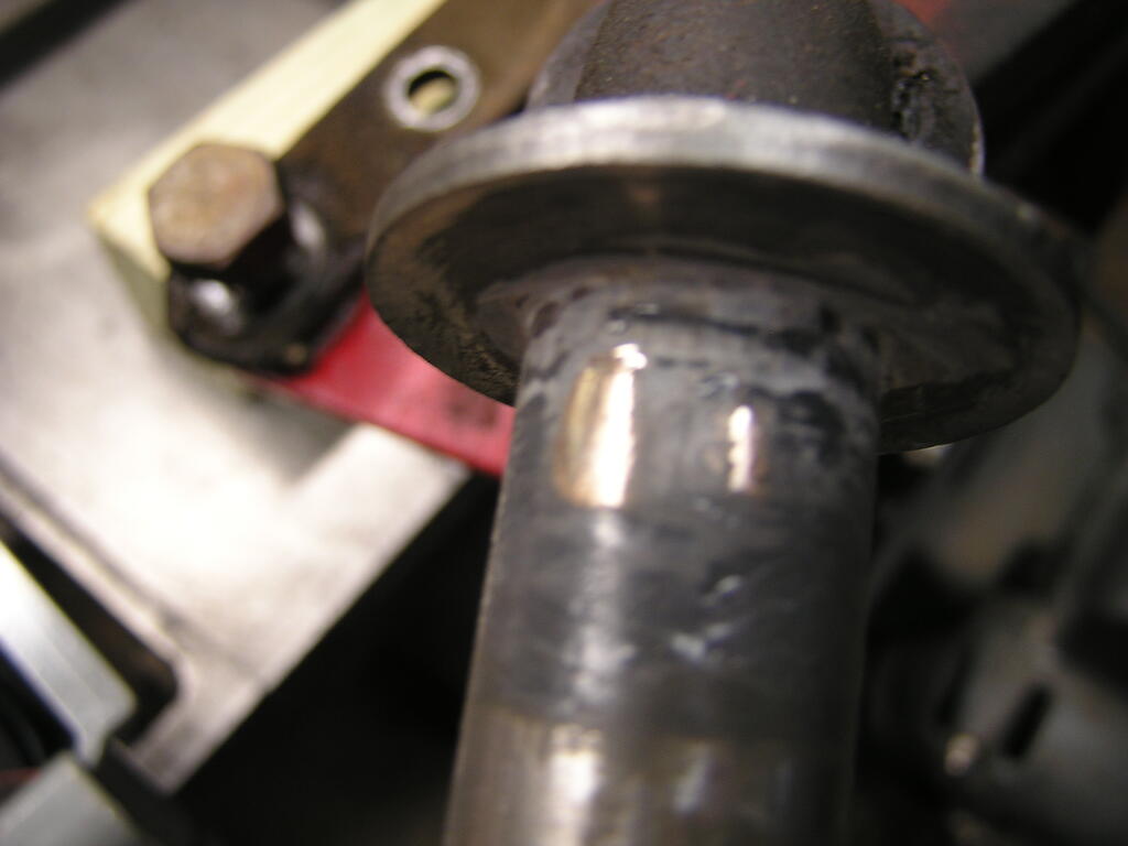

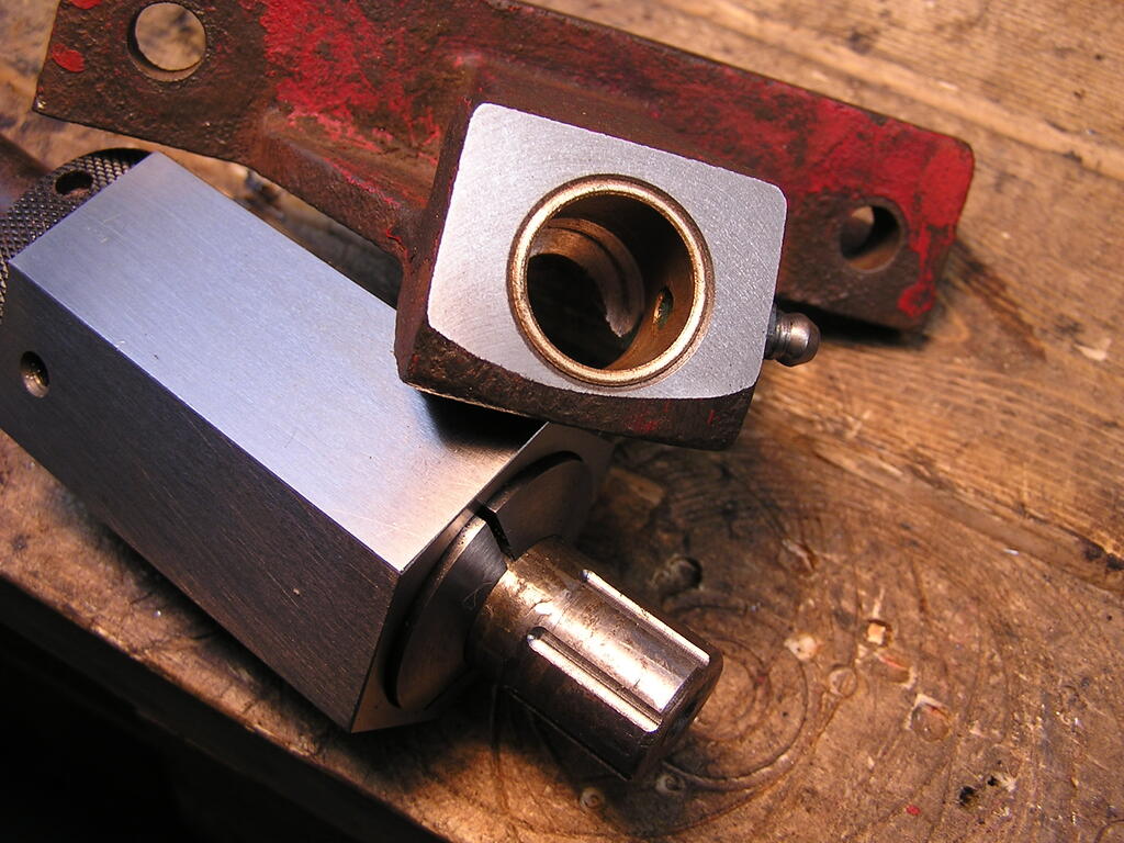

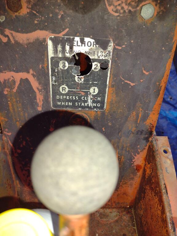

ri702bill 11,700 #6 Posted July 5, 2022 (edited) The placement of the shifter pattern / serial number is correct for a 502 - different location for the 552 and 702. I also am building a 502, and did several modifications to remove excess play in the steering. Machined the lower block, axle spindle bores, pivot bore, and lower steering shaft for bronze bushings. Did the same on the flat bar tie rod plate. Also added grooves in the lower shaft to hold grease. Had one spindle with excessive wear, that was TIG welded to build it up and hand filed to shape. Got rid of the wheel bushings, switched to the later style flanged ball bearings. Tapped the ends of the spindles for a retaining bolt - the inner races are now stationary, no longer spinning on the shaft. Pictures would be helpful - best of luck going forward. Bill Edited July 5, 2022 by ri702bill 2 1 1 Share this post Link to post Share on other sites

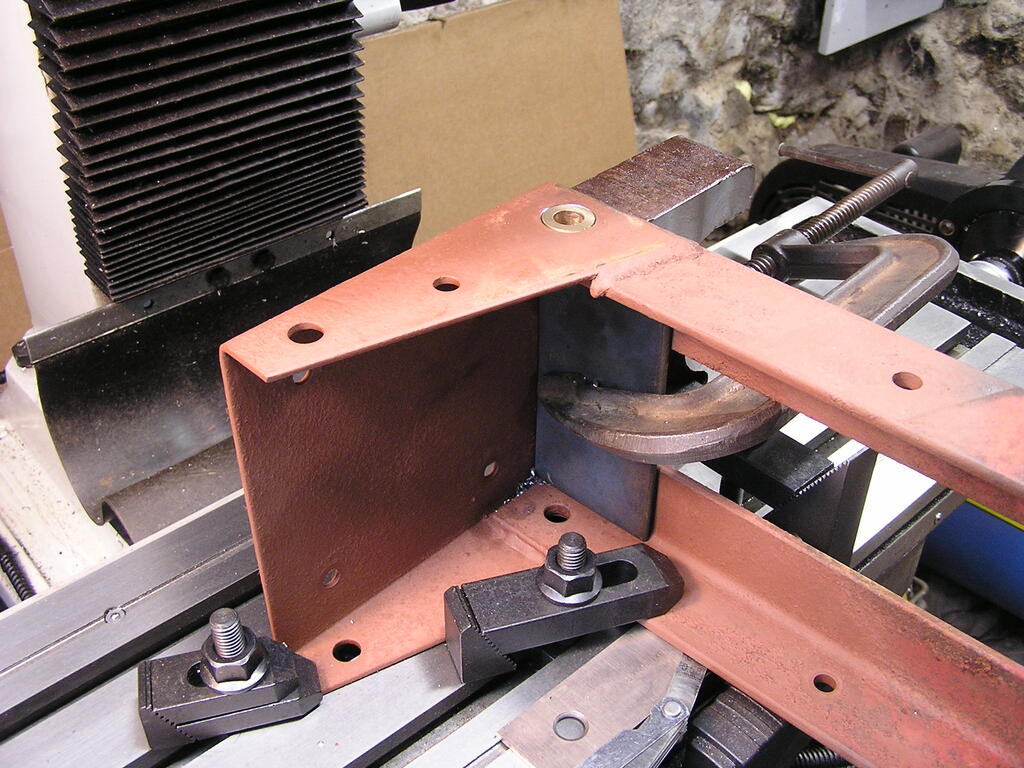

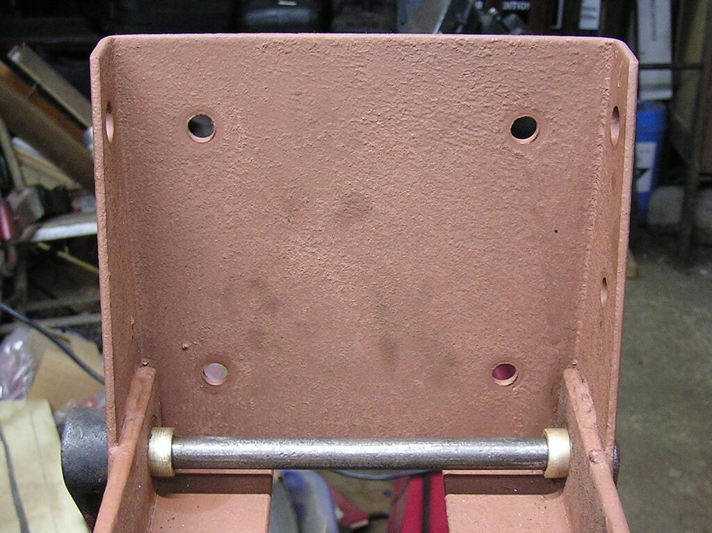

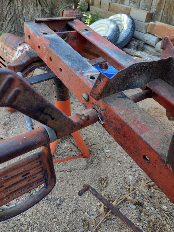

ri702bill 11,700 #7 Posted July 5, 2022 While you have things apart, you should check the condition of 2 items. There are no bushings in the rear of the frame where the clutch shaft goes thru and out the other side - just steel on steel with no grease fitting. I machined the frame to accept bronze flanged bushings. Others have done the same using a pistol drill with good success. Definetly check the condition of the flat plate (aka the F Plate) around the 4 bolt holes to attach the Unidrive for cracking. If it is cracked, it can be repaired and reinforced. The ugly picture is from a 854 parts tractor I bought that never cut grass, only used and abused for plowing - the 502 frame with the bushings added was just fine. Bill 1 Share this post Link to post Share on other sites

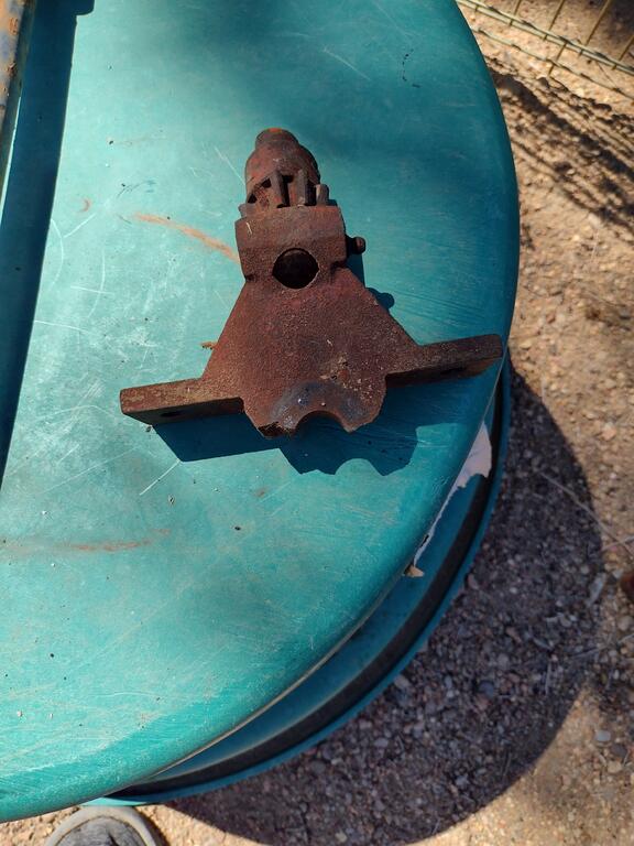

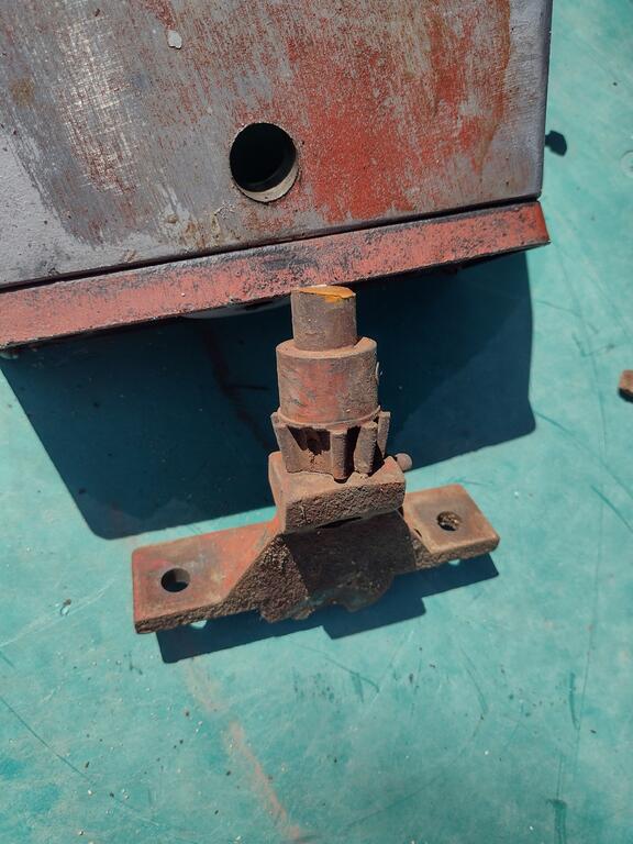

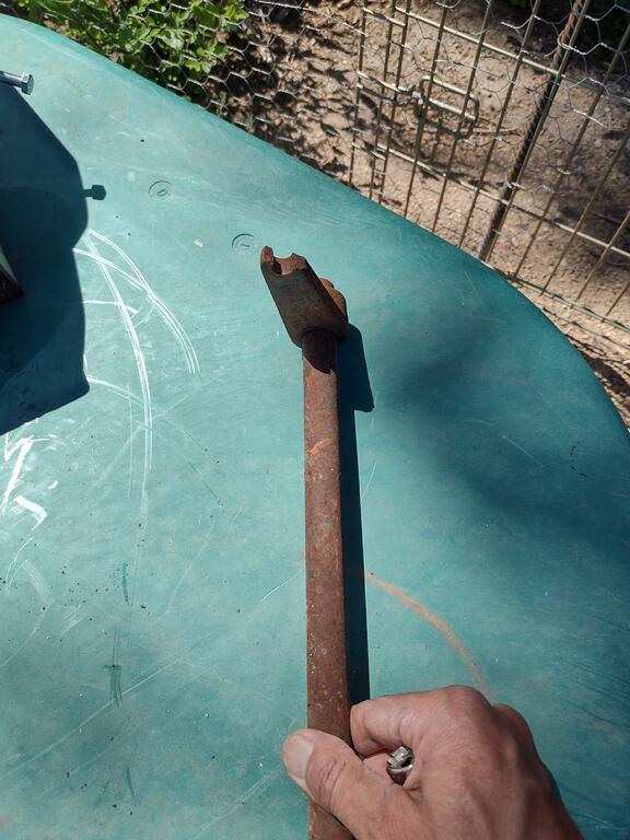

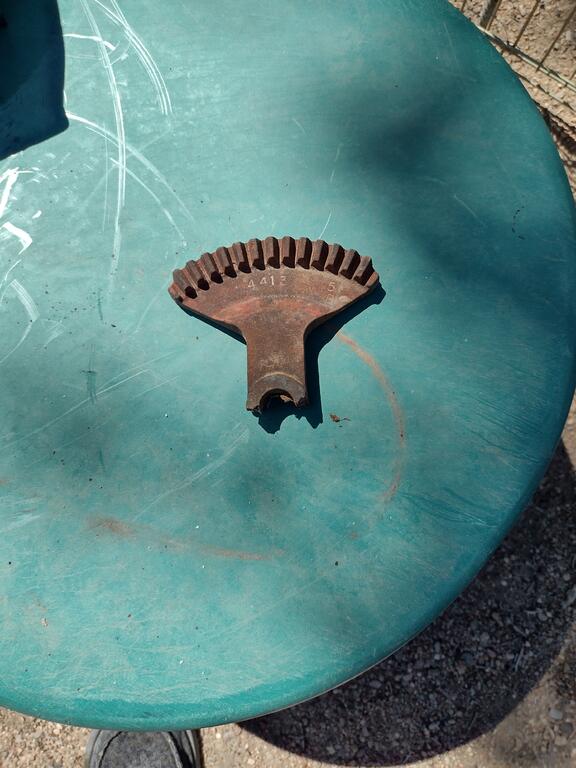

Vagabond surf 5 #9 Posted July 5, 2022 Part #. Description. 141/3917 Bevel pinion. 142/3918. Steering pivot 143/3919. Steering arm 187/4412. Bottom steering support 188/4413. Steering sector 199/4429. Clutch rod 200/4430. Clutch pedal So far these are the parts I need, as far as I can tell. As I take it apart for painting I am sure more parts will be needed. Share this post Link to post Share on other sites
Vagabond surf 5 #10 Posted July 5, 2022 Just now, Vagabond surf said: Part #. Description. 141/3917 Bevel pinion. 142/3918. Steering pivot 143/3919. Steering arm 187/4412. Bottom steering support 188/4413. Steering sector 199/4429. Clutch rod 200/4430. Clutch pedal So far these are the parts I need, as far as I can tell. As I take it apart for painting I am sure more parts will be needed. Share this post Link to post Share on other sites

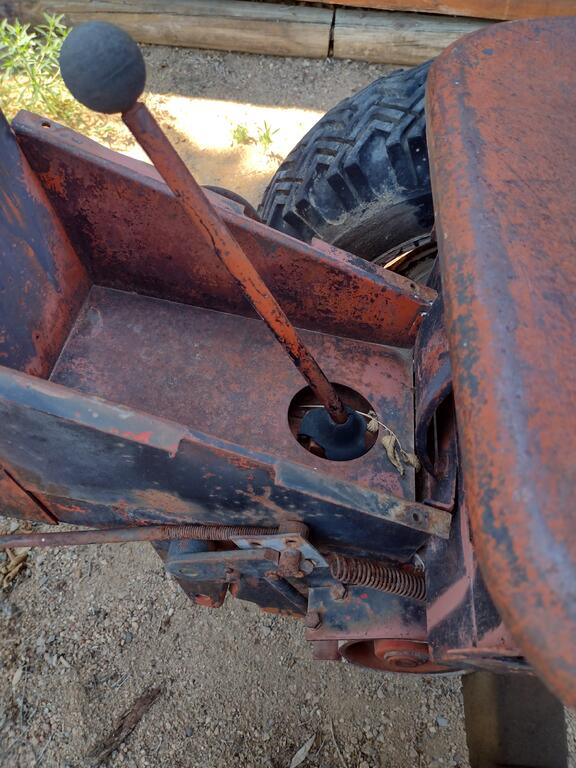

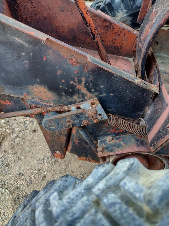

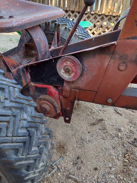

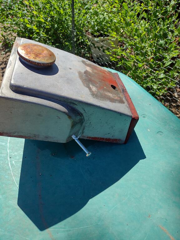

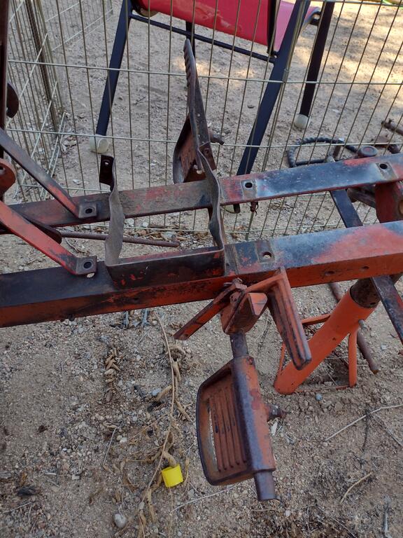

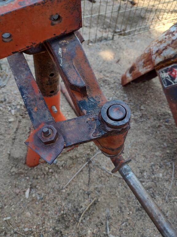

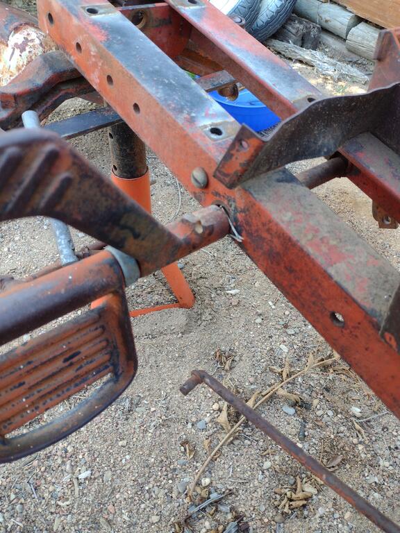

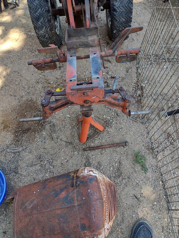

ri702bill 11,700 #15 Posted July 5, 2022 WOW! This one looks like either it fell off a tralier and got run over by a bus or a tree fell on it. Severe damage - you need to check if the frame is either bowed os twisted. I have encountered the repaired steering arm if someone spanked a stationary object at speed and the broken lower support, but never like that - one or both of the ears break from frame twist. Your gas tank is not 502 original - it is from a 702. It takes a LOT of force to twist up a welded-in-place battery box like that. So much damage - honestly, you may wish to consider this one a parts donor and start of with a better specimen that had a less eventfull life...... Bill 1 Share this post Link to post Share on other sites
