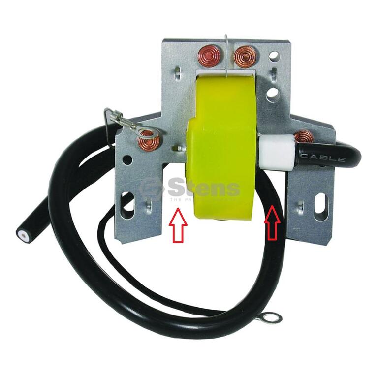

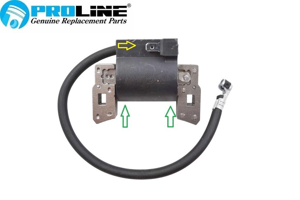

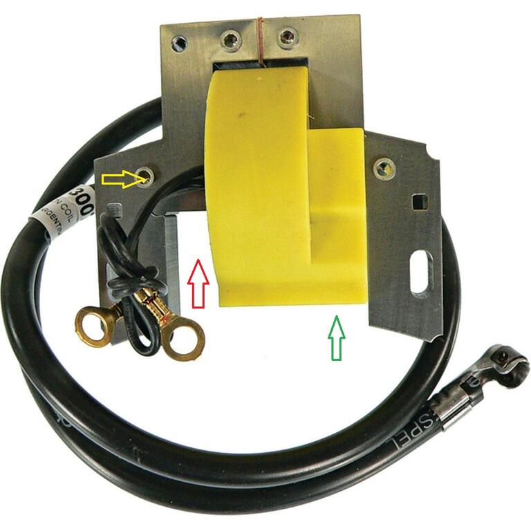

Achto 32,794 #18 Posted July 7, 2022 (edited) 17 hours ago, Brokeoldman said: Upon further inspection, I see two wires going up into the flywheel. Does that mean there is indeed points? The wires come from the starter and battery Those two wires are for the charging system. What's under the fly wheel on an aluminum block L-head Briggs? 1- If you have points, the points and condenser will be under the fly wheel. 2 - If you have a charging system, the alternator stator will be under the fly wheel. How to ID what type of coil that you have. The color of the coil it's self has no bearing on the type of coil. This picture is of a coil that requires points. Note the space between the coil and the pick up's. Red arrows show this space. These are solid state coils. Some have the space filled in on one side, some have the space filled in on both sides as pointed out by the green arrows. A solid state coil will only have a plug wire and a kill wire or a terminal for the kill wire. Kill wire is pointed out by the yellow arrows. To turn the engine off with either type of coil you simply ground out the coil or the points, depending on your system. With a solid state coil, if you unplug the kill wire and turn the engine over you should have spark. Providing 1 - You have a known good spark plug. 2 - There is no damage to the plug wire. 3 - The gap between the coil pick ups and the fly wheel is correct .010" to .015" at the magnets. A business card works well for this. 4 - The coil is on correctly. Should be marked indicating which side faces the engine block. May have "IN" or "OUT" marked on the body. 5 - The magnets on the fly wheel are good. If all of the above checks are correct and you do not have spark then replace the coil. Part number 398811 fits all single cylinder L-head Briggs 7-16hp A link for an aftermarket equivalent. https://www.amazon.com/Dalom-Ignition-Stratton-7HP-16HP-Horizontal/dp/B07FKFNZND/ref=asc_df_B07FKFNZND/?tag=hyprod-20&linkCode=df0&hvadid=309836003692&hvpos=&hvnetw=g&hvrand=5405297517136523208&hvpone=&hvptwo=&hvqmt=&hvdev=c&hvdvcmdl=&hvlocint=&hvlocphy=1016367&hvtargid=pla-580028557424&psc=1&tag=&ref=&adgrpid=67374862491&hvpone=&hvptwo=&hvadid=309836003692&hvpos=&hvnetw=g&hvrand=5405297517136523208&hvqmt=&hvdev=c&hvdvcmdl=&hvlocint=&hvlocphy=1016367&hvtargid=pla-580028557424 If by chance your engine does have points, I suggest replacing the original coil with a B&S 398811 or equivalent. Bolt on application, no more points to worry about. Edited July 7, 2022 by Achto 1 Share this post Link to post Share on other sites
Brokeoldman 2 #19 Posted July 10, 2022 On 7/7/2022 at 10:06 AM, Achto said: Those two wires are for the charging system. What's under the fly wheel on an aluminum block L-head Briggs? 1- If you have points, the points and condenser will be under the fly wheel. 2 - If you have a charging system, the alternator stator will be under the fly wheel. How to ID what type of coil that you have. The color of the coil it's self has no bearing on the type of coil. This picture is of a coil that requires points. Note the space between the coil and the pick up's. Red arrows show this space. These are solid state coils. Some have the space filled in on one side, some have the space filled in on both sides as pointed out by the green arrows. A solid state coil will only have a plug wire and a kill wire or a terminal for the kill wire. Kill wire is pointed out by the yellow arrows. To turn the engine off with either type of coil you simply ground out the coil or the points, depending on your system. With a solid state coil, if you unplug the kill wire and turn the engine over you should have spark. Providing 1 - You have a known good spark plug. 2 - There is no damage to the plug wire. 3 - The gap between the coil pick ups and the fly wheel is correct .010" to .015" at the magnets. A business card works well for this. 4 - The coil is on correctly. Should be marked indicating which side faces the engine block. May have "IN" or "OUT" marked on the body. 5 - The magnets on the fly wheel are good. If all of the above checks are correct and you do not have spark then replace the coil. Part number 398811 fits all single cylinder L-head Briggs 7-16hp A link for an aftermarket equivalent. https://www.amazon.com/Dalom-Ignition-Stratton-7HP-16HP-Horizontal/dp/B07FKFNZND/ref=asc_df_B07FKFNZND/?tag=hyprod-20&linkCode=df0&hvadid=309836003692&hvpos=&hvnetw=g&hvrand=5405297517136523208&hvpone=&hvptwo=&hvqmt=&hvdev=c&hvdvcmdl=&hvlocint=&hvlocphy=1016367&hvtargid=pla-580028557424&psc=1&tag=&ref=&adgrpid=67374862491&hvpone=&hvptwo=&hvadid=309836003692&hvpos=&hvnetw=g&hvrand=5405297517136523208&hvqmt=&hvdev=c&hvdvcmdl=&hvlocint=&hvlocphy=1016367&hvtargid=pla-580028557424 If by chance your engine does have points, I suggest replacing the original coil with a B&S 398811 or equivalent. Bolt on application, no more points to worry about. Ok, I installed new coil as suggested. Still won't start. Also have a new spark plug and fresh gas. Where do I go from here Share this post Link to post Share on other sites
