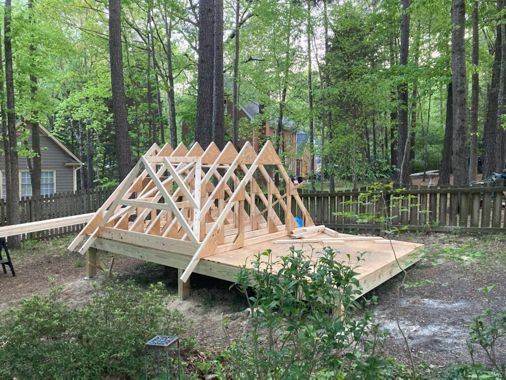

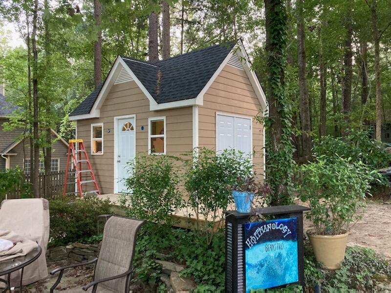

ineedanother 2,879 #1 Posted July 2, 2022 8ntruck asked about this in another forum but I didn't want to derail that one so thought I would start a new thread here. This was last year's project while we were locked down for COVID. I had about 40 sheets of 5/8" plywood and a bunch of recovered 2x4s and really needed something to help decompress the garage a bit. I have an HOA and not a lot of yard to work with and on top of that whatever I decided on needed to match the architecture and satisfy the bureaucracy...and the wife! I was pretty much relegated to a 10 x 16 footprint so I poured 6 footings with Simpson ties for the 4x6 posts so the wood and concrete would be separated. I laid two layers of 5/8 plywood on 2x8 on 16" centers. Stick built trusses to allow overhead access and an eave for aesthetics. Plywood gusset plates with construction adhesive and about 120 8d nails per truss. I framed it up on the deck and numbered everything so it could be disassembled and then reassembled more easily than doing all of that fitting up on ladders. 4 3 Share this post Link to post Share on other sites

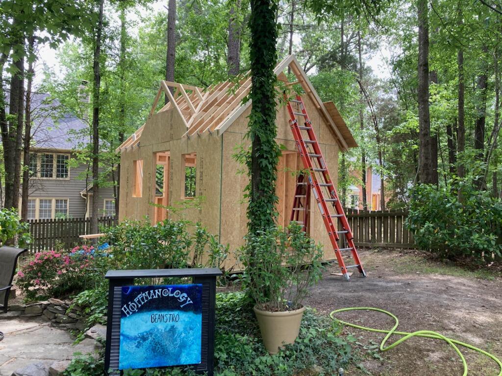

ineedanother 2,879 #2 Posted July 2, 2022 I went back and forth about the wall height. I wanted as much as possible but with the steep roof pitch I didn't want it to look like a tower. I considered a roll-up door but decided on a 5' outswing double door. Here it is framed up and ready for the roof sheathing. I was delayed a bit getting to this point because OSB was in short supply and up to $55/sheet and I just hadn't planned on lumber prices doing what they did. It was interesting adding the eave on the long side. It was all framed up and fitted so I ended up leaning an extension ladder and sliding it up the ladder into place. My wife was a little skeptical but she helped and it went on without any issues. 6 Share this post Link to post Share on other sites

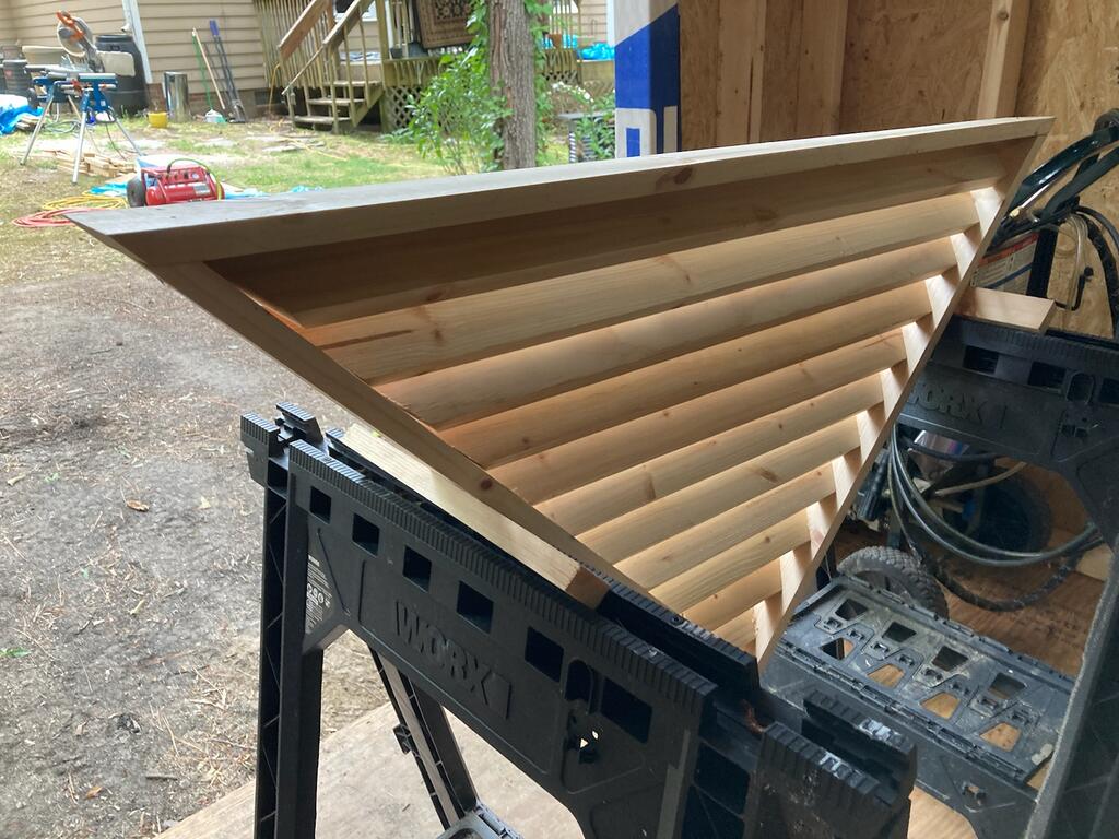

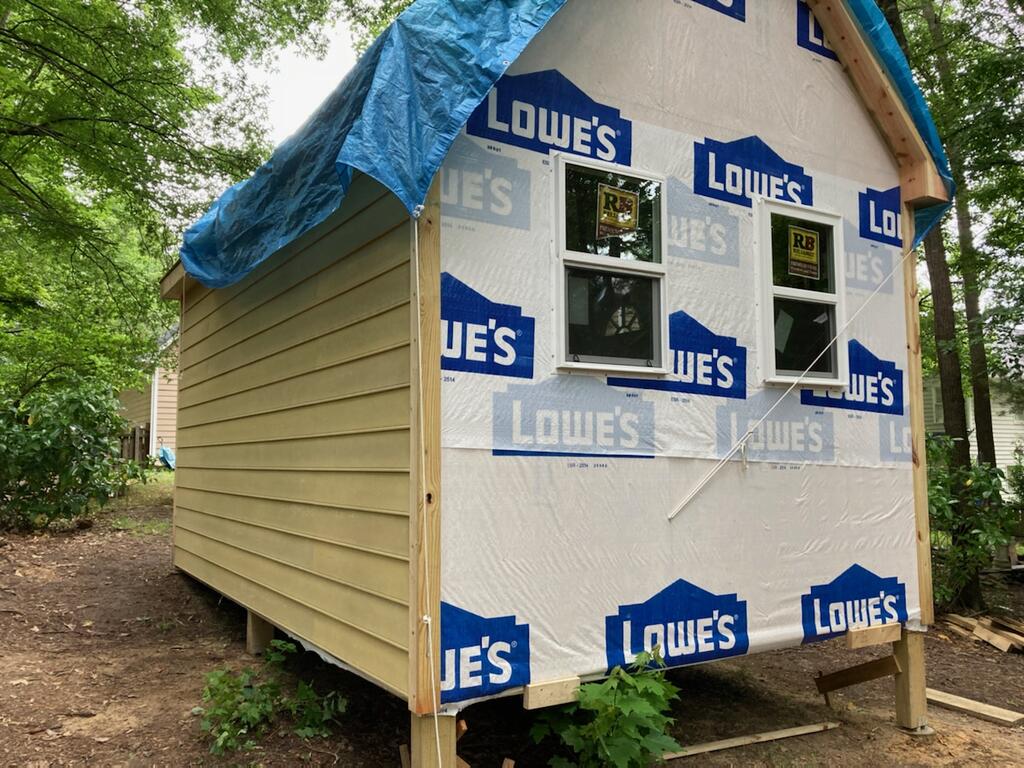

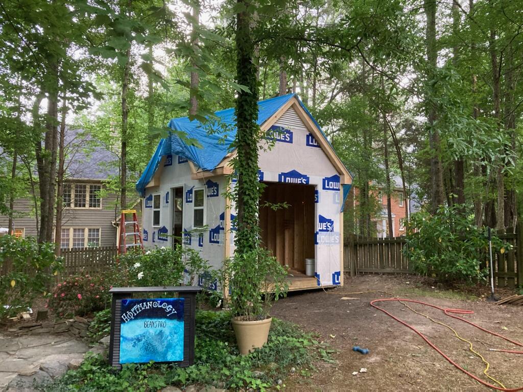

ineedanother 2,879 #3 Posted July 2, 2022 I got it all dried in and wrapped. I thought I would be able to buy louvers but ended up having to build a jig and make them myself. They turned out really nice and provide the right airflow to protect the shingles. At this point I was waiting on the large door so I installed the vinyl windows, pulled interior wiring and that goes with that. 4 3 Share this post Link to post Share on other sites

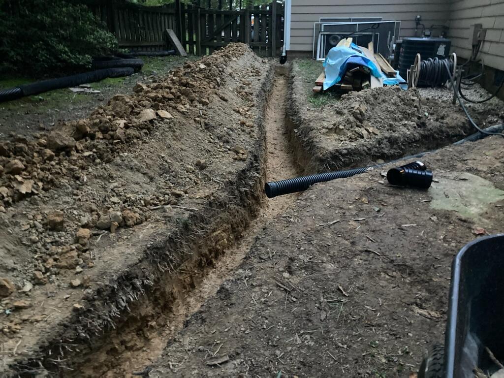

ineedanother 2,879 #4 Posted July 2, 2022 I wouldn't recommend trenching by hand in NC in July, but that's what I had to do. I can't get large equipment into my back yard but needed to bury a couple downspouts and run power from the main panel in the garage so it was time to knock the rust off of the pick axe. 18" wide, 24" deep, but thankfully only about 80' long. I buried 6 gauge wire in 1 1/2" conduit so I could run 50 amps of 240v out to a sub panel in the shed. 6 Share this post Link to post Share on other sites
ineedanother 2,879 #5 Posted July 2, 2022 I hadn't ever done much with Hardy plank siding but I have a 4" wet saw and bought a pair of electric shears which are the ticket! My neighbor convinced me to try his battery powered Milwaukee framing nailer and I was really surprised how well it did. It was nice to not deal with air hoses everywhere. 5 Share this post Link to post Share on other sites

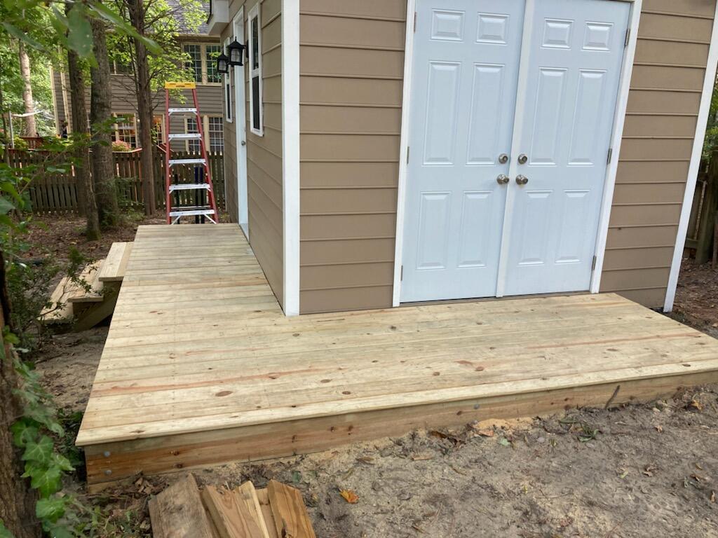

ineedanother 2,879 #6 Posted July 2, 2022 I added some decking, soffit and facia, shingles which were brutal on a 12/12 pitch, and got some paint on it. 7 2 Share this post Link to post Share on other sites

ineedanother 2,879 #9 Posted July 2, 2022 Thanks guys, For many years I could never afford to pay anyone to do anything for me around the property so I acquired tools as I could and learned how to do it myself. I insulated, drywalled, and trimmed the inside. I didn't insulate the floor figuring that critters would just tear it up from underneath. I had a couple pallets of commercial carpet tiles so those went in to help keep the chill off in winter. I'm able to keep it warm with just a small electric heater. I had a spare resin-top bench at work (weighs a ton!) so that went in with a couple cabinets and a small fridge so I'm in business! I wish it could have been bigger but just have to be efficient with the space. My extension ladder usually hangs over the door but it's out right now. You can see in this pic that there are sliding access doors to the overhead storage which really helps. The lighting is all LED to conserve power but I can run my compressor and saws without issue. I was able to distribute some GFCI power to the back yard while I was at it so it's really been a valuable project. 5 Share this post Link to post Share on other sites
8ntruck 9,328 #10 Posted July 2, 2022 Nice building. I'm impressed with the louvers. Bet a chop saw with compound angle capability came in real handy for those. 3 Share this post Link to post Share on other sites
ineedanother 2,879 #11 Posted July 2, 2022 1 hour ago, 8ntruck said: Nice building. I'm impressed with the louvers. Bet a chop saw with compound angle capability came in real handy for those. Absolutely. I have a 12" Rigid compound miter on a HF stand that made the job doable. Folks bust on HF but their Hercules and US General lines are tough to beat. Pennies on the dollar compared to big name brands. I made the frames, set the angles and cut all of the louvers pretty quickly. I tacked them in with a 16g pneumatic nailer and it wasn't difficult. A hammer and nails would have been really frustrating but having them custom made would have been a deal breaker from a budget standpoint. 3 Share this post Link to post Share on other sites

ohiofarmer 3,504 #21 Posted April 12, 2023 (edited) I was just referred to this thread from another thread, and I must say that you approached building that roof exactly as I would have. It all fits together and any mistakes are corrected from a comfortable height Cut all the sheathing on the ground as well and fit o the ground as well. One small suggestion that pays off in safety would either be to rent scaffolding for that very steep roof and/or some adjustable roofing jacks. I have a couple 16 foot rated walk planks as well as a 24 foot, but some hasty scaffolds can be constructed and nailed up on the walls and very easily done so just by securing them across the building and temporarily fastening to the wall studs. Back in the day when board sheeting was used in place of plywood, it may have been more common to skip a wall sheathing board to set a scaffold shelf, but it is still doable even with plywood sheathing A few 16 foot 2x4s nailed at a handy height maybe three feet below the top plate would give you a three foot pike on either side of the wall. lay a few boards on them and proceed in comfort and safety. Edited April 12, 2023 by ohiofarmer 2 Share this post Link to post Share on other sites
