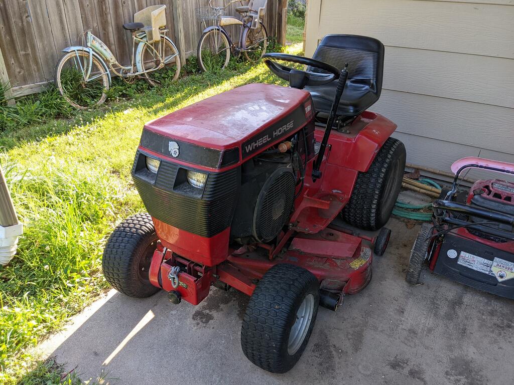

Krivman65 1 #1 Posted June 30, 2022 Hi all, I have a 1995 Wheelhorse with a 42" recycling, rear discharge deck and have always had issues with it leaving windrows. Well, come to find out that the blades are super short. Has anyone else ran into this? I haven't had a chance to measure a blade yet, but everything I am reading says that it originally would have come with 14.5" blades. What length should I buy to fix this problem? Thanks!!!! 1 Share this post Link to post Share on other sites

Krivman65 1 #5 Posted June 30, 2022 Thank you! I am unfortunately leaving strips of uncut grass. That's why I am hoping that someone has a longer blade length that works with this deck. Share this post Link to post Share on other sites

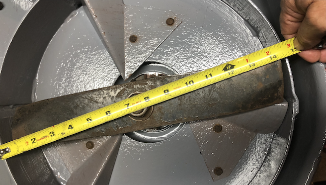

Handy Don 17,382 #8 Posted July 1, 2022 @Krivman65 @Jeff-C175 has you covered. According to the manual, 14.5" (measured diagonally at the corners of the cutting edge. Also, the blade ends should rotate quite close to the cylindrical walls of the recycler insert. Those blades must be sharp, sharp, sharp and have the cutting edge be squared at the end (i.e. not rounded). Lastly, the correct blades have a somewhat larger "wing" that other standard blades that introduces a lot of up airflow at the edges to stand up the grass as it enters and so the mulched grass exits mainly downward at the center. Lots of engineering in that unit. Share this post Link to post Share on other sites

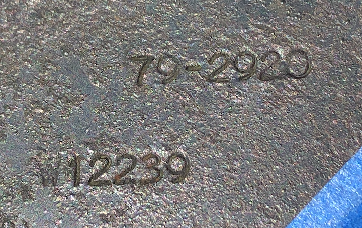

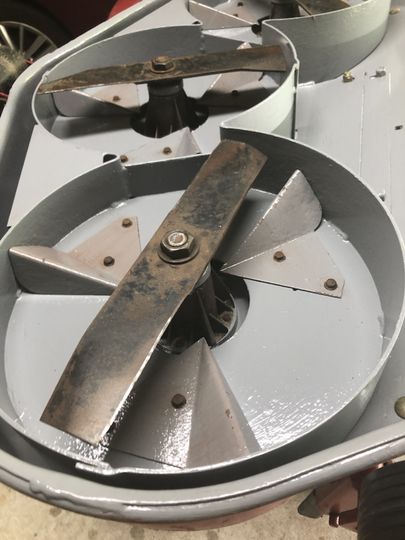

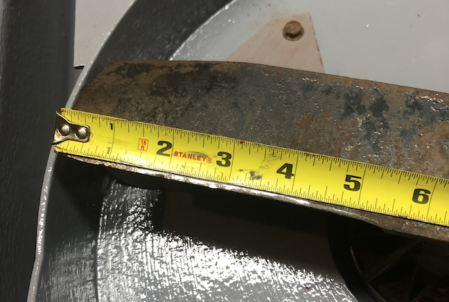

Handy Don 17,382 #10 Posted July 1, 2022 (edited) Just putting this out there for anyone searching for 42 inch RD Recycler mower deck info These are the Toro numbers stamped on my blades - 79-2920 is the current part number. I believe W12239 is the number for a 3-blade kit. This is the general layout of the insert and blades. Blade end-to-insert clearance is about ½+" laterally and about ¼" vertically below the rim of the insert (upward in this image because the deck is upside down!) Blade is still above the lower front lip of the deck shell, but not buy much. If the lip hits something, the blade is likely to hit it too. 14.5" diagonally 5+ inches of cutting edge (Many after market blades have 3½ to 4" here. The mulching function wants the extra cutting edge to work well! This blade end is starting to be a bit worn at the end but not too bad yet. It's important to realize that the "open" decks can eject sticks and small rocks pretty easily without excessive damage. On a recycler, though, something wedged between the blade and the insert wall or one of the baffles can cause noticeable damage to the blade or deck. Similarly, an overloaded (too much grass too quickly) recycler will stall more easily than an "open" deck. These decks must run at full speed to be effective. Edited July 1, 2022 by Handy Don Share this post Link to post Share on other sites
