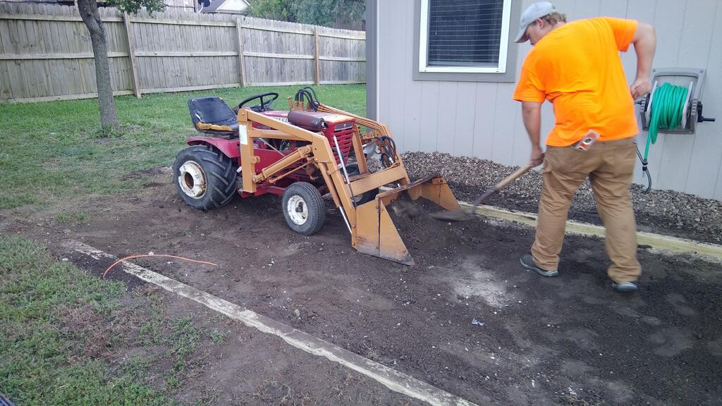

RandyLittrell 3,944 #1 Posted June 30, 2022 I need to pull the two bucket cylinders off and send them to Lowell to get rebuilt. Can I just hook the two hoses together on each cylinder so I can still lift the loader arm up and down and move around? It's a johnson 10 if that is any help. Share this post Link to post Share on other sites
Handy Don 16,948 #2 Posted June 30, 2022 Coupling the extend/retract hoses together is ok and protects the system from contamination. A couple of quick activations of the control will purge any air that got in there. Of course, be sure there is no pressure in the system before unhooking any hose! Plugging them securely is also ok, but if you absent-mindedly activate that control, you'll hear the screech of the pressure relief valve since nothin' will be movin'. 4 Share this post Link to post Share on other sites
RandyLittrell 3,944 #3 Posted June 30, 2022 47 minutes ago, Handy Don said: Coupling the extend/retract hoses together is ok and protects the system from contamination. A couple of quick activations of the control will purge any air that got in there. Of course, be sure there is no pressure in the system before unhooking any hose! Plugging them securely is also ok, but if you absent-mindedly activate that control, you'll hear the screech of the pressure relief valve since nothin' will be movin'. Thank you Don! I thought that was the answer on both counts, but I really know nothing about hydraulics so thought it best to ask the experts here!! Randy Share this post Link to post Share on other sites
