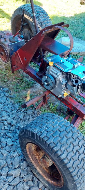

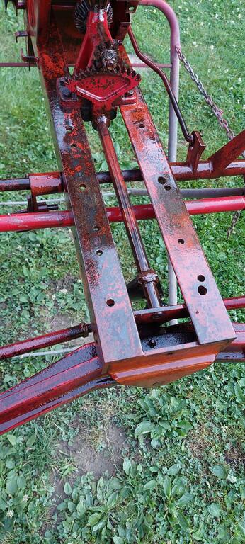

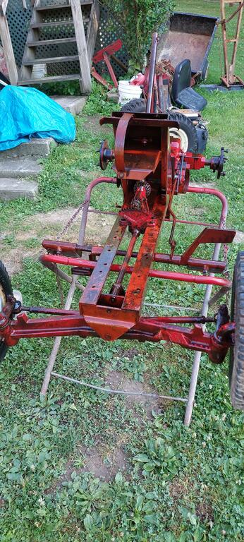

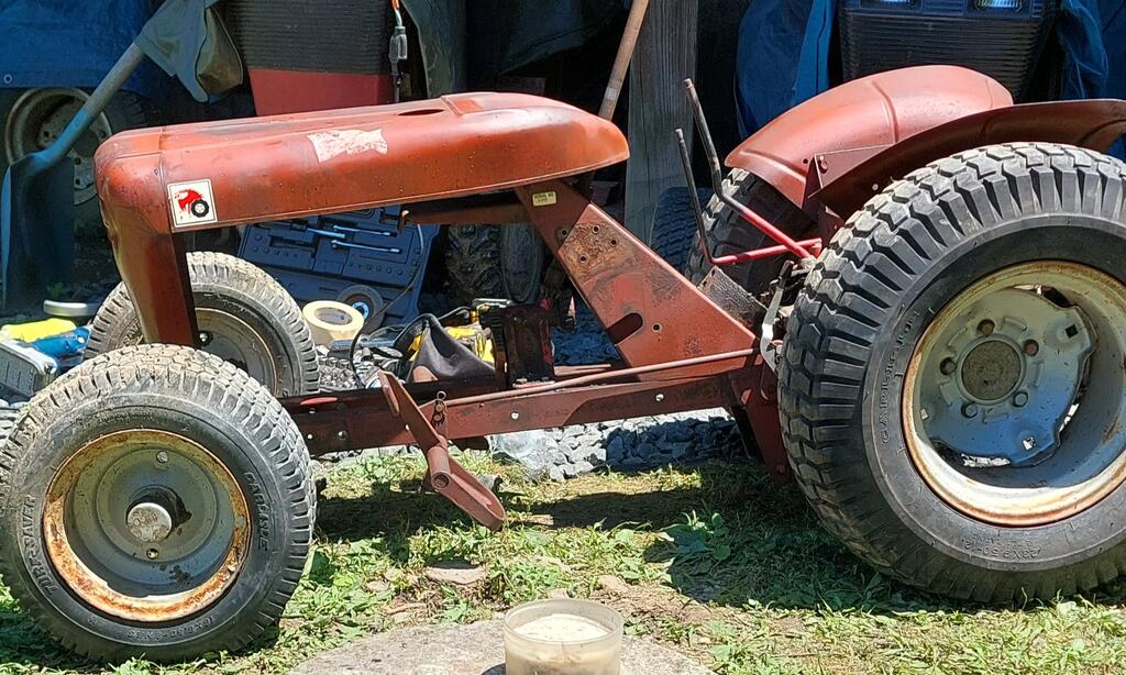

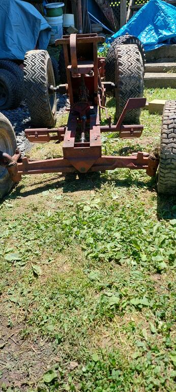

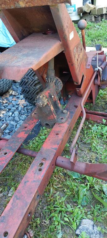

fast88pu 3,402 #27 Posted July 10, 2022 Transmission drop bracket made. 5 Share this post Link to post Share on other sites

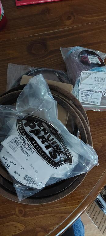

fast88pu 3,402 #29 Posted July 15, 2022 More goods showed up today Share this post Link to post Share on other sites

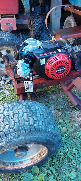

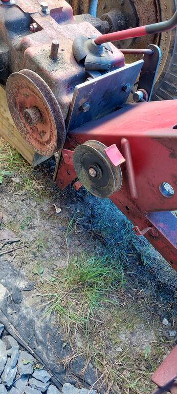

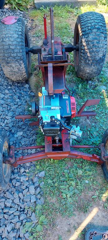

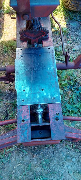

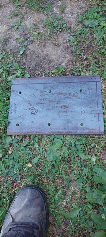

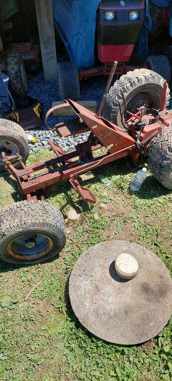

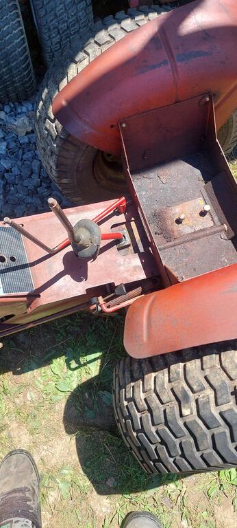

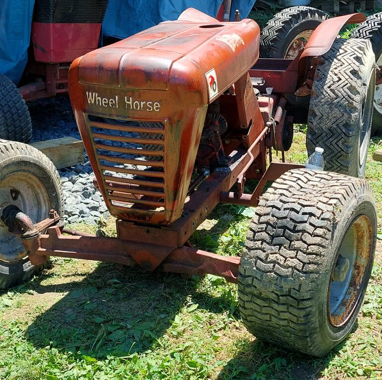

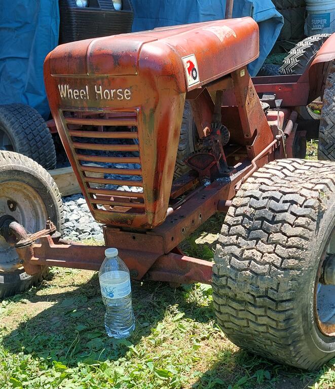

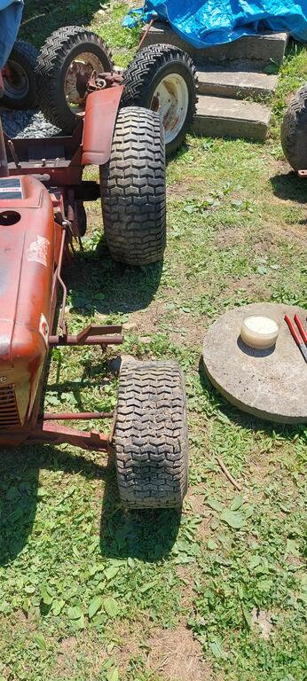

fast88pu 3,402 #30 Posted July 17, 2022 I made the engine mounting plate today and positioned the engine where it will rest. 2 3 Share this post Link to post Share on other sites

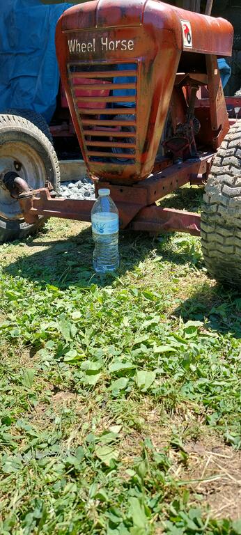

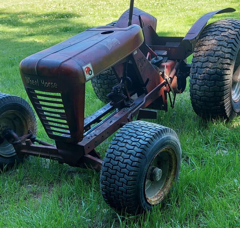

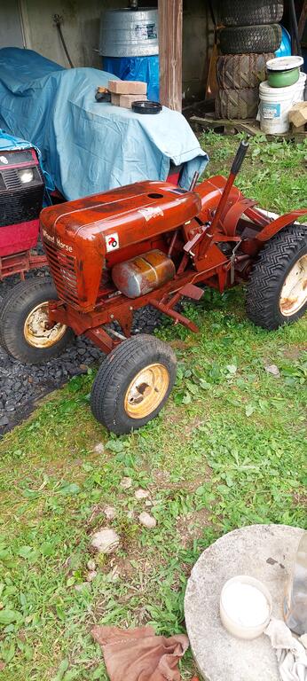

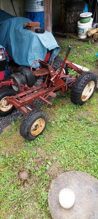

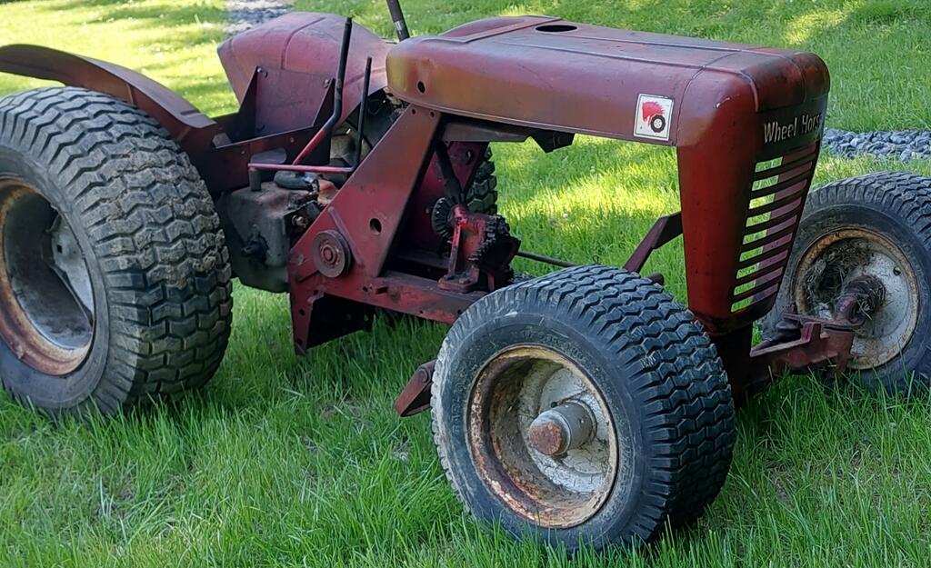

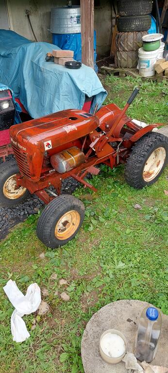

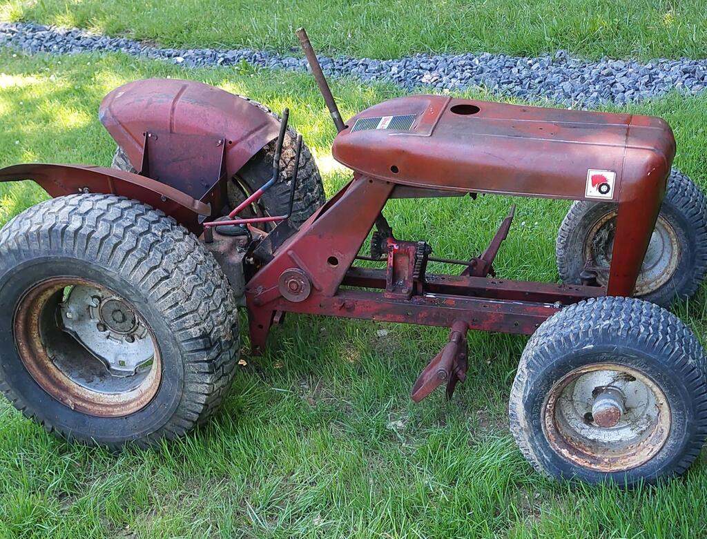

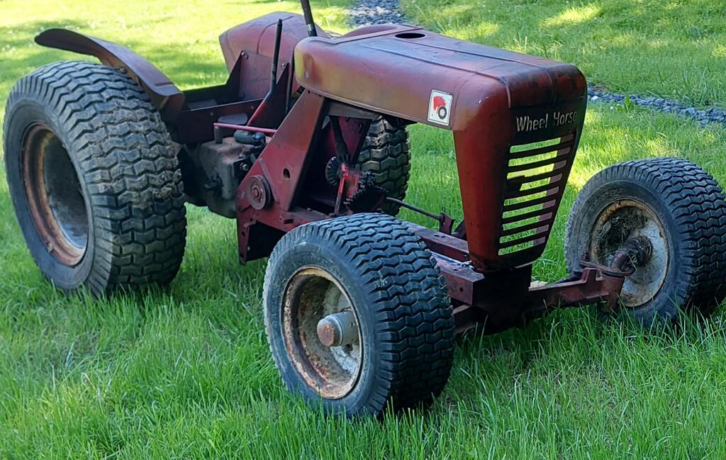

fast88pu 3,402 #31 Posted July 17, 2022 And for those that got butt hurt over me sandblasting this perfect patina machine (stevebo). Here are the real photos of it. 1 4 1 Share this post Link to post Share on other sites

fast88pu 3,402 #34 Posted July 17, 2022 Clutch and brake layed out. Clutch parts off a 416-8 3 Share this post Link to post Share on other sites
Jeff-C175 7,212 #35 Posted July 17, 2022 40 minutes ago, fast88pu said: brake Looks like a few thousand left on that brake lining! 1 Share this post Link to post Share on other sites
fast88pu 3,402 #36 Posted July 17, 2022 16 minutes ago, Jeff-C175 said: Looks like a few thousand left on that brake lining! Gonna replace it but at $90 it hurts to buy a new one 1 Share this post Link to post Share on other sites
Jeff-C175 7,212 #37 Posted July 18, 2022 3 hours ago, fast88pu said: Gonna replace it but at $90 it hurts to buy a new one You can reline that. I think Bob @rmaynard sells the lining material. 1 1 Share this post Link to post Share on other sites
fast88pu 3,402 #38 Posted July 18, 2022 26 minutes ago, Jeff-C175 said: You can reline that. I think Bob @rmaynard sells the lining material. Yes Bob does but this band is too bent up to save. Share this post Link to post Share on other sites
rmaynard 17,659 #39 Posted July 18, 2022 Just tap it straight with a hammer. The band will straighten more when you glue the lining to it. You should be fine. Another shameless plug for my brake linings. 3 2 2 Share this post Link to post Share on other sites
fast88pu 3,402 #40 Posted July 18, 2022 6 minutes ago, rmaynard said: Just tap it straight with a hammer. The band will straighten more when you glue the lining to it. You should be fine. Another shameless plug for my brake linings. Have you ever pondered making complete new ones ? Share this post Link to post Share on other sites
rmaynard 17,659 #41 Posted July 18, 2022 5 minutes ago, fast88pu said: Have you ever pondered making complete new ones ? Yes, but at this point in my life, and at my age, I really don't want to get into a new project. One of our vendors restores used brake bands and puts my linings in them. See: K&B Horse Parts 2 1 Share this post Link to post Share on other sites

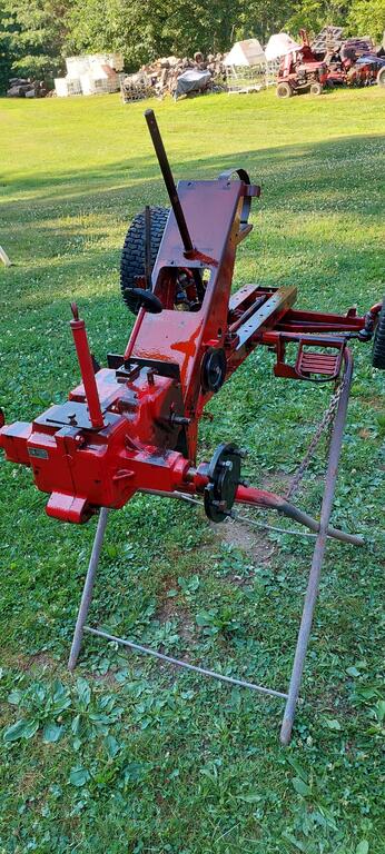

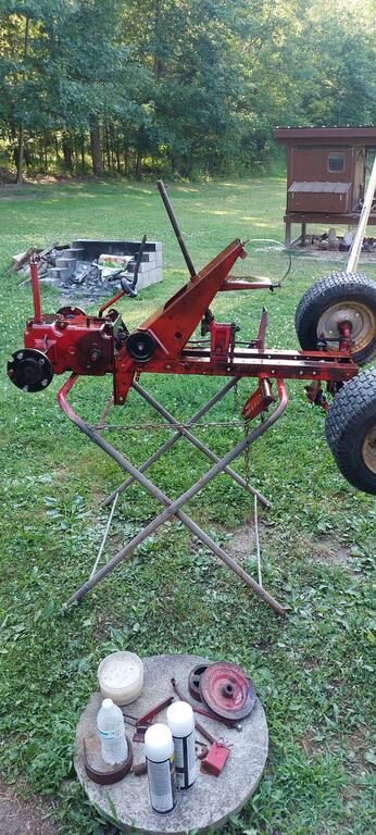

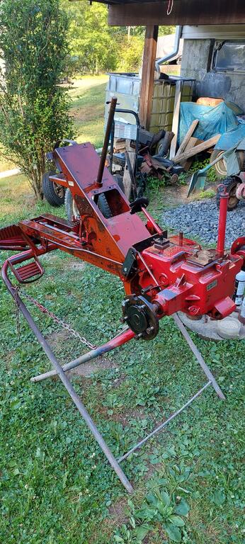

fast88pu 3,402 #42 Posted July 20, 2022 All degreased and cleaned. Then prepped it for clear to maintain the patina 5 2 Share this post Link to post Share on other sites
Jeff-C175 7,212 #43 Posted July 20, 2022 34 minutes ago, fast88pu said: All Now where is the missus gonna dry her nylons? 1 Share this post Link to post Share on other sites
fast88pu 3,402 #44 Posted July 20, 2022 29 minutes ago, Jeff-C175 said: Now where is the missus gonna dry her nylons? Lol it's a saw horse for a body shop 1 Share this post Link to post Share on other sites

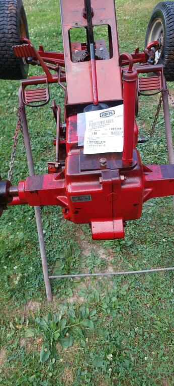

fast88pu 3,402 #45 Posted July 22, 2022 Nothing like some new seals on the 8 speed 2 Share this post Link to post Share on other sites
wallfish 20,744 #46 Posted July 22, 2022 On 7/17/2022 at 5:09 PM, fast88pu said: Gonna replace it but at $90 it hurts to buy a new one Those thin ones are much easier to straighten than those earlier thick bands. Take it off, get it close then put it back on and use the drum as the dolly to tap hammer it. It should end up pretty good. Then epoxy the new lining on and clamp it to the drum for the epoxy to dry. 3 Share this post Link to post Share on other sites
953 nut 70,666 #47 Posted July 22, 2022 27 minutes ago, wallfish said: Then epoxy the new lining on and clamp it to the drum for the epoxy to dry. The way I have installed brake band linings is to set the parking brake while the adhesive sets up, pretty much the same idea. 3 Share this post Link to post Share on other sites

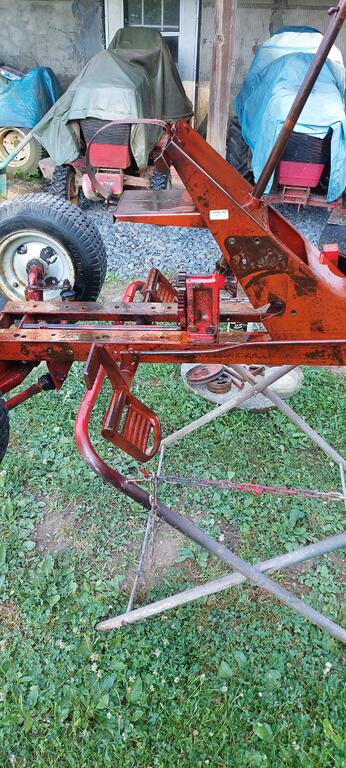

fast88pu 3,402 #48 Posted July 23, 2022 Early morning sandblasting in prep for paint 1 Share this post Link to post Share on other sites

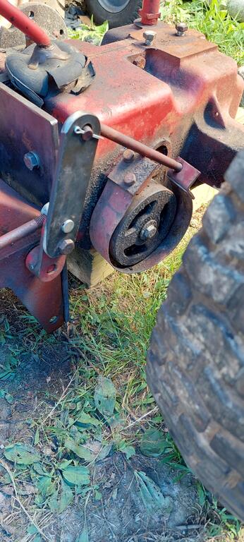

peter lena 10,127 #49 Posted July 23, 2022 @fast88pu nice clean up on that , noting your drive belt idler pulley , known for problems , with bearing lubrication failures and related linkage points , rusty / binding , do a thorough function check , for smooth / easy engagement , pete 1 1 Share this post Link to post Share on other sites
fast88pu 3,402 #50 Posted July 23, 2022 4 hours ago, peter lena said: @fast88pu nice clean up on that , noting your drive belt idler pulley , known for problems , with bearing lubrication failures and related linkage points , rusty / binding , do a thorough function check , for smooth / easy engagement , pete Waiting on new idler pulley and I had it all apart, cleaned and lubed 1 1 Share this post Link to post Share on other sites
