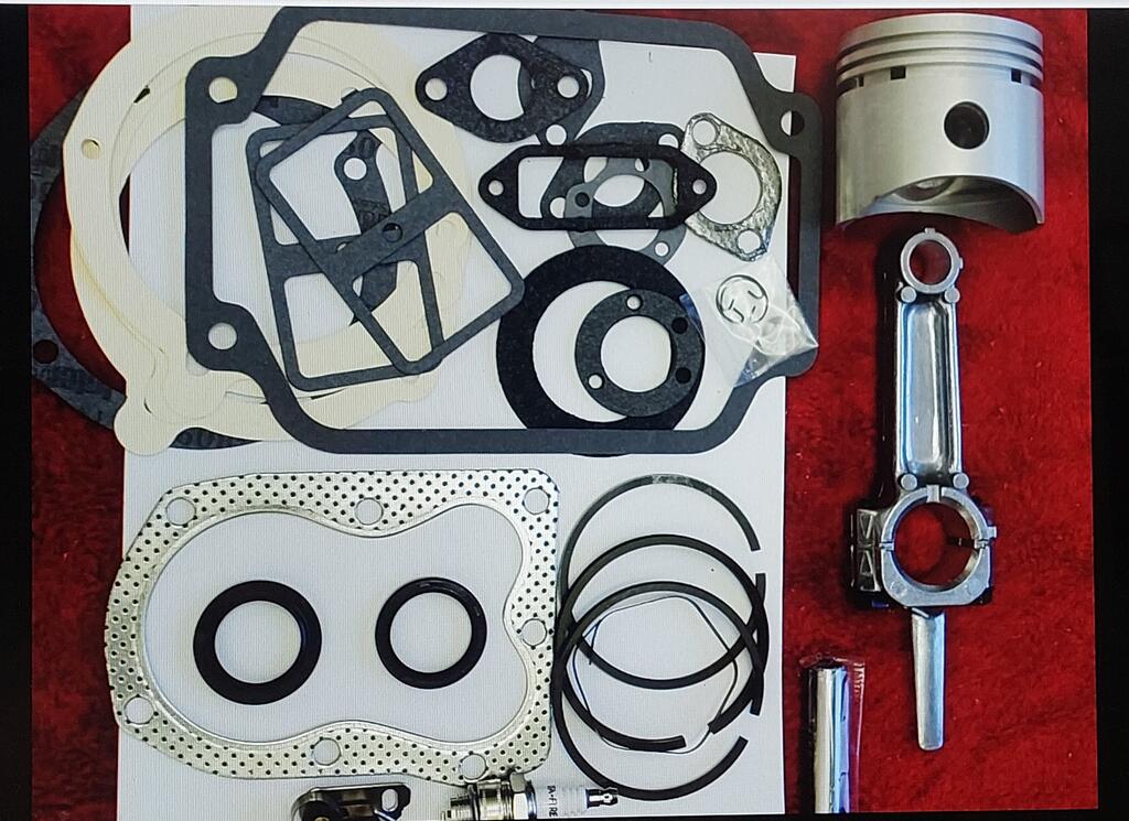

dmoore 1,042 #1 Posted June 29, 2022 Does Kohler still sell an overhaul kit for the K181? And if so where do you guy's buy em? Share this post Link to post Share on other sites
stevasaurus 23,884 #2 Posted June 29, 2022 That is a loaded question. What are you looking to do?? I rebuilt two K-181's a couple of years a go. I got my parts off E-Bay, but I got my small engine work done at a small engine shop. Machined the crank, cylinder, did the valves on one of them. Ordered pistons, rod, etc from E-=Bay...put them together and they run great. An over-haul kit, what do you think that includes??? Just asking. 1 Share this post Link to post Share on other sites
dmoore 1,042 #3 Posted June 30, 2022 Everything you see here. This guy is in Wauseon, Wi. and sells on eBay for $89.99. The short time I had this 854 running after years of being idle it smoked a little on acceleration and deceleration. No noises, ran great, just little smoke. I figured now is the time to do it while it's being restored. It's standard bore and probably onley needs homing and rings. Share this post Link to post Share on other sites
WH nut 553 #4 Posted July 9, 2022 On 6/29/2022 at 10:50 PM, dmoore said: Everything you see here. This guy is in Wauseon, Wi. and sells on eBay for $89.99. The short time I had this 854 running after years of being idle it smoked a little on acceleration and deceleration. No noises, ran great, just little smoke. I figured now is the time to do it while it's being restored. It's standard bore and probably onley needs homing and rings. I have used aftermarket like that with no problems. 1 Share this post Link to post Share on other sites
