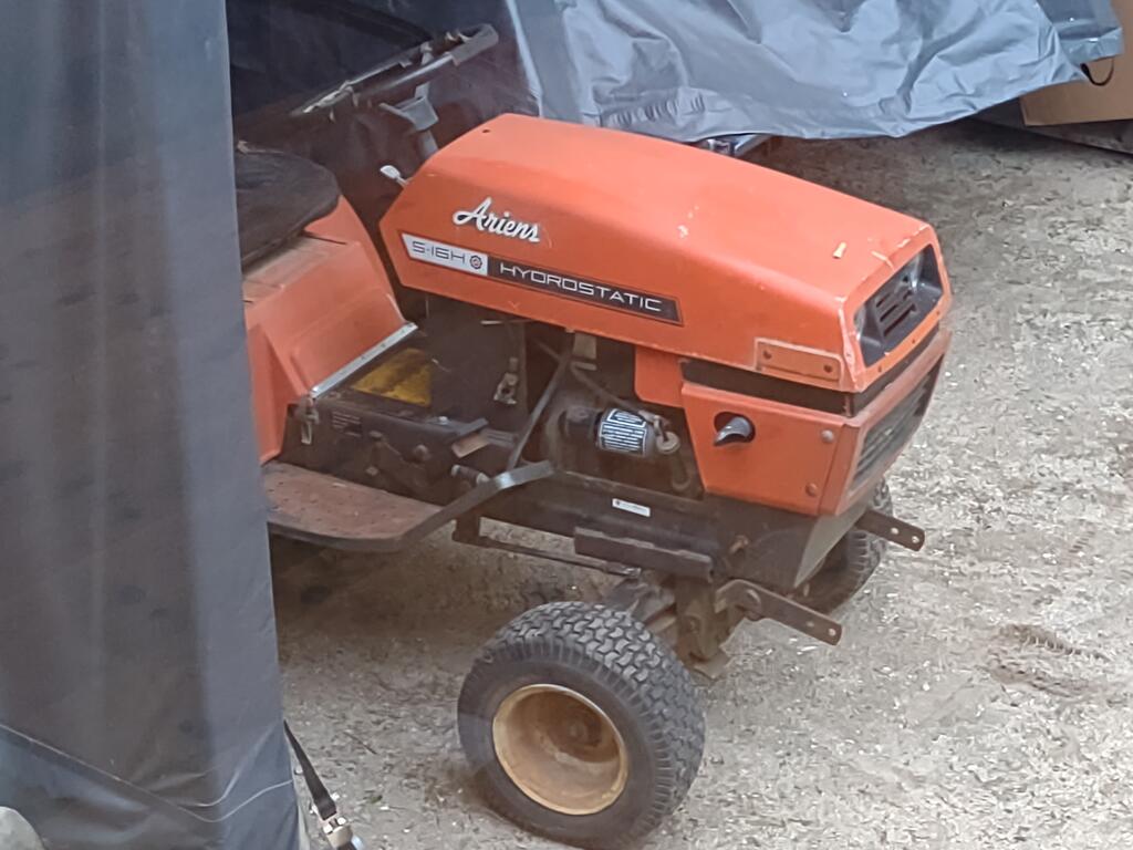

ebinmaine 80,103 #1 Posted June 29, 2022 Looking at this later today. I was thinking of using it as an engine donor but it's quite a beast. Does not run yet. Starter is stuck "out" with a greasy dirty Bendix gear visible. Could be starter, could be something further down the line holding the engine from moving. Anything to look for specifically? Are they known as decent rigs? If it runs and drives should I use it as a whole or part it out? 2 Share this post Link to post Share on other sites
sjoemie himself 3,158 #2 Posted June 29, 2022 I'm not a 'part-it-out' kinda guy because I see potential in everything A quick Giggle search taught me there are plenty of attachments like tillers, snowploughs, snowaugers etc. for this machine, so apparantly they can do some real work. Even comes with a front splined shaft PTO by the looks of it. There's a nice thread on the mytractorforum about such a machine. Giggle should take you there.. 2 1 Share this post Link to post Share on other sites

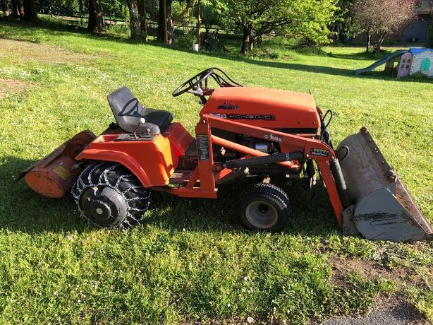

sjoemie himself 3,158 #4 Posted June 29, 2022 14 minutes ago, ebinmaine said: platform for a front end loader. That seems to be an option.. possibly even from factory? (Pic borrowed from interweb) 1 1 Share this post Link to post Share on other sites
JoeM 10,122 #5 Posted June 29, 2022 2 hours ago, ebinmaine said: maybe a platform for a front end loader If it has power steering....your good to go. If not you will be disappointed. Especially in your terrain. Ariens owns Gravely. So parts should not be a problem. 2 Share this post Link to post Share on other sites
sergeant 350 #6 Posted June 29, 2022 (edited) 11 hours ago, sjoemie himself said: That seems to be an option.. possibly even from factory? (Pic borrowed from interweb) Loaders & Backhoes for Ariens Tractors were Made By Brantly and Kwik-way & Johnson. The Factory Option shown Is the 34-inch frame Mounted Tiller. There was also a 48-inch Cat 0 3point Mounted Tiller available as well Basically, Sperry-New Holland sold its Lawn & Garden tractor Line to Ariens and that Became the Ariens Garden tractor Line. Ariens Basically updated the Tractor for a Number of Years Until a Slight Redesign with the Grand Sierra Before they Dropped there Garden Tractor Line in 2003 Edited June 29, 2022 by sergeant 4 Share this post Link to post Share on other sites

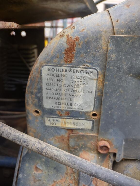

gwest_ca-(File Mod) 12,418 #7 Posted June 29, 2022 Kohler serial 8118218 was made in 1977 1 Share this post Link to post Share on other sites
ebinmaine 80,103 #8 Posted June 30, 2022 Got it delivered yesterday evening. I set it half undercover so the seat is out of a straight falling rain at least. I will say this tractor has a nice wide long stable feel to it. At first glance I can see that the starter needs to be removed and cleaned as mentioned above and also, the fuel line is literally rotted off at the fuel pump. I'm pretty sure that causes a gas flow issue. 3 1 Share this post Link to post Share on other sites

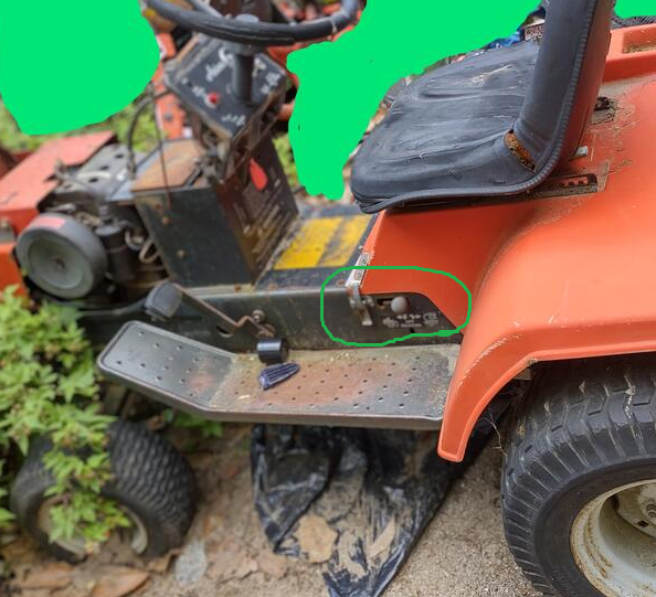

sergeant 350 #13 Posted June 30, 2022 (edited) They are a Great Garden tractor, I think the Long warranty(6 years) while Great selling feature. People that Bought them didn't seem to trade up as often compared to some Other Manufacturers with the shorter 2 year Industry standard Warranty during the 1980s & 1990s The Other Nice thing about the Later Model of the GT series was the Three PTO Locations were standard when Most Manufacturers You Had to add that as an Option The Cat 0 3 Point and Sleeve Hitch used the same Rocker shaft as well, That was another nice Feature of the Ariens Garden tractor The One feature I always Like about Ariens Garden tractors was You could switch Between front and Rear Hydraulic control (Lever circled In Green) and You used One Hydraulic Lever One thing I wish Deere would Have Incorporated In their later Garden Tractors Instead of More Mechanical stops to Hold the 3point In Place while using front Implements Once Deere went away from the 3 Lever Hydraulic system Edited June 30, 2022 by sergeant 1 1 Share this post Link to post Share on other sites
