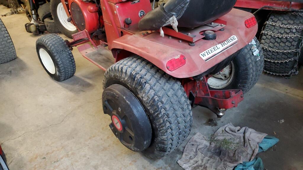

Kevin Bowley 140 #1 Posted June 27, 2022 (edited) I have a few c-series tractors, on my C-121, which I u for grading my long gravel drive, I had some great Goodyear turf tires, size 23x8x12, with heavy duty chains. Those tires finally split wide open and the tube was riding on the ground. So, I purchased some new Trac-Gard N766 23x8.50x12 tires. I am unable to put the chains on because they rub on the left side brake drum? I also tried to put them on my C-161 and the same issue occurs. So, what gives? Do I remove the brake drum? wheel spacers? wimpy chains? Has anyone else run into this issue? Here is My driveway And my Heavy Duty chains Edited June 27, 2022 by kbowley Share this post Link to post Share on other sites

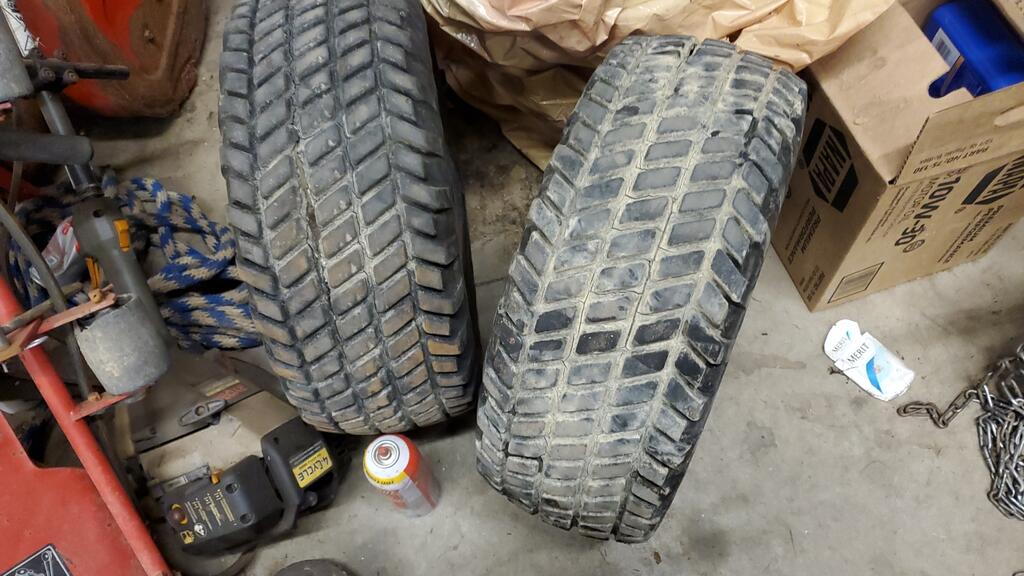

Kevin Bowley 140 #5 Posted June 27, 2022 I found some 1/2" spacers on eBay. I think that will give me enough room. Two inch seems like it would be rough for the axle and hubs? Plus, where would I find lug nuts for those? I just find it unusual that the clearance is very tight. I certainly see tons of them with chains. I wish I could find those Goodyear Turf tires. Anyone know of a source for those. Here's a picture of the ones that failed and the new Trac-gard's I bought from Amazon for 57.00 each with 2 day free shipping. 1 Share this post Link to post Share on other sites

Kevin Bowley 140 #14 Posted June 28, 2022 3 hours ago, Jeff-C175 said: I wonder if your chains are the issue? Is the ACTUAL width of the old tires greater than the new ones? Did the side chains ride higher on the sidewalls? Maybe the crosschains could be shortened by a few links? The old tires were 23×8.00x12 and the new ones are 23x8.50x12 so 1/2" wider which brings the tire just 1/4" closer so the chains just barely rub as I rotate the tire. I tried moving them both lower and higher on the inside but no go. I am almost sure that a 1/2" inch spacer will be plenty because they just barely hit. Also, I have enough length with the current lug nuts. I just found it's strange that Wheel Horse didn't configure it to have enough clearance for chains. But there are a few things that make me question what the engineering team was smoking at the time 😕 1 Share this post Link to post Share on other sites

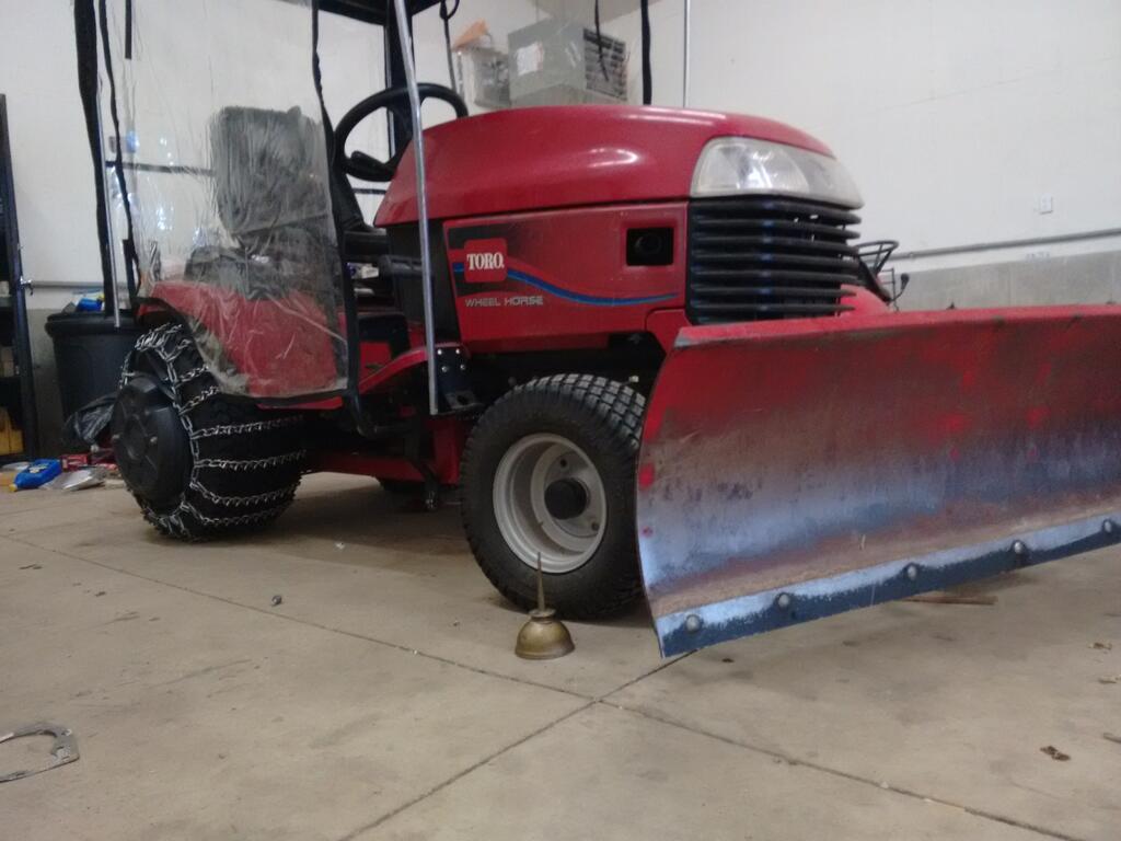

Jeff-C175 7,209 #16 Posted June 28, 2022 24 minutes ago, kbowley said: 23x8.50x12 Which is what I'm running on both my C-125 and C-175 and there is no issue with chain clearance on either machine. The side chains are no more than 2" down on the side wall of the tires. (Carlisle Turf Masters on one, and Turf Savers on the other) I understand it's a different machine... but looking at your pics of the tires with chains on them it really looks to me as if the cross chains are too long and the side chain is way low on the side wall, almost to the wheel weights, and probably the same on the inside. 1 Share this post Link to post Share on other sites
JoeM 10,092 #17 Posted June 28, 2022 5 hours ago, Jeff-C175 said: looking at your pics of the tires with chains on them it really looks to me as if the cross chains are too long Probably for 10.50 tires they do come down and look like they touch the weights? 6 hours ago, kbowley said: I just found it's strange that Wheel Horse didn't configure it to have enough clearance for chain I figured they did, but they had to satisfy a another issue with small decks having to clear the deck gauge wheels at the tires when raised. Remember this is the era of smaller decks and just starting to transition to the wider stuff. Horse Power was lower, decks smaller, and tires were narrow too. And who knows what all gets switched around over the years. 1 1 Share this post Link to post Share on other sites

Kevin Bowley 140 #21 Posted June 28, 2022 12 hours ago, ebinmaine said: Verify the ACTUAL measurement of the new and old tires. You may need spacers. I measured the tires' actual width; the old Goodyear's measured roughly 7.8 inches across the tread, and the new ones are 8.50 on the money. Here are the spacers I found on eBay, and I think I will get them. I am very confident that they will give me enough space. I bought those chains from TireChains.com. I also purchased the Heavy-duty V-bar chains for my 522-XI, my main plow tractor in the winter, and those babies have some traction, but they are expensive. Worth every penny when it takes me 4-5 hours of plowing with the big D-Series 56" blade on it (plus Ya got to love that power steering). Here are the chains I purchased for the 522XI. These are the ones that I got for the C-121. I bought those back around 2010 and wished I had purchased the V-Bars because those babies have some serious traction, even on glare ice. Anyway, I agree they are too wide for the tires, but when I purchased them, they listed for sizes 23x8.50, 9.50, and 10.50. Now they have more precise sizing. Comparing these to the typical eBay "peerless" cheapies, the links are at least twice as heavy. The links appear to be about 1/4" steel. Awesome chains that, even after 15 yrs. of use, still shine like new with virtually zero wear. Regarding pulling 20 links apart to shorten, that would be a task considering how difficult they are to bend, plus it would limit their flexibility to use on, say, my 520 with the 10.50 width tires. However, it would likely work well, but I would purchase new chains before taking that task on. 3 Share this post Link to post Share on other sites
