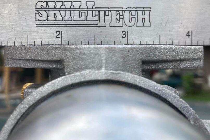

creighton trimble 8 #7 Posted July 2, 2022 Hmmm, I am running one of there carbs on my k241 and couldn't be happier. It would be interesting to see what the issue is with the carb, take a straight edge to the mounting surface. Please, keep us informed what you find. Share this post Link to post Share on other sites
"Manic-Mechanic" 1,486 #8 Posted July 2, 2022 (edited) 9 hours ago, creighton trimble said: Hmmm, I am running one of there carbs on my k241 and couldn't be happier. It would be interesting to see what the issue is with the carb, take a straight edge to the mounting surface. Please, keep us informed what cyou find. Yes, here is a good picture, it is beautiful. I mean it sealed, no vacuum leaks, no fuel leaks. Looks excellent inside. The company was going back and forth with me, all the usual trouble-shooting, even offered a return for refund. I had this stored away new since last July 1st, their product never has failed me, ever! So I just got tired of everyone saying to do this or that to my engine. Engine is fine as the video can attest to...Mystery, welcome any new ideas related to the carburetor. I will get into this carburetor, find whatever issue may be present as time permits, just no longer a priority as the original is back on. Whatever I find, I'll be sure and post. Edited July 3, 2022 by "Manic-Mechanic" 1 Share this post Link to post Share on other sites
