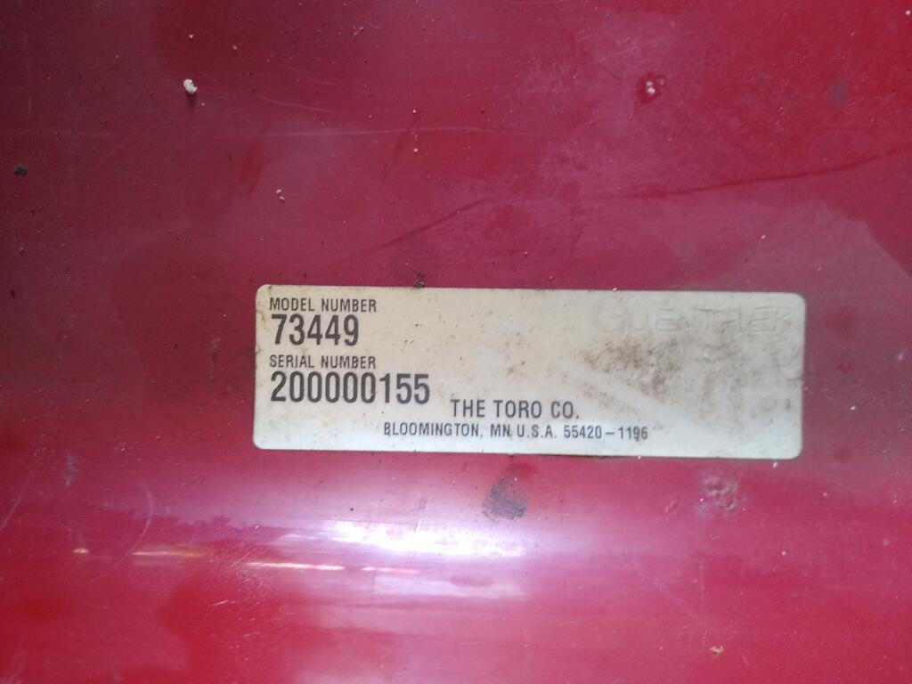

Applejuice 4 #1 Posted June 26, 2022 I'm sure this has been covered in another thread but I need a bit of help I bought her used off a fella for 150$ and she is in pretty decent shape other then a tune up and new fuel pump and solonoid now she fires up and well when you go to put her in a gear and move the lever just a hair she dies so I'm assuming it's a switch. The seat switch was wired back on itself and it has the stupid turn the seat key for reverse option. I added a serial# tag pic. Any help would be great thanks in advance Share this post Link to post Share on other sites
953 nut 64,647 #2 Posted June 26, 2022 Here is a list of topics for your model number, https://www.wheelhorseforum.com/search/?q=73449&quick=1&type=downloads_file According to your wiring diagram if the PTO is on and the neutral safety switch is not in neutral it will activate the KILL RELAY. The wiring on these newer models is rather complicated, take a look at the diagram (first listing) and If you need further help let us know. 1 Share this post Link to post Share on other sites

Capespencer68 3 #19 Posted July 19, 2022 On 6/26/2022 at 1:06 PM, Applejuice said: I'm sure this has been covered in another thread but I need a bit of help I bought her used off a fella for 150$ and she is in pretty decent shape other then a tune up and new fuel pump and solonoid now she fires up and well when you go to put her in a gear and move the lever just a hair she dies so I'm assuming it's a switch. The seat switch was wired back on itself and it has the stupid turn the seat key for reverse option. I added a serial# tag pic. Any help would be great thanks in advance Out of curiosity what year is this 214-8 ? 1 Share this post Link to post Share on other sites
Applejuice 4 #20 Posted July 20, 2022 It's a 314-8 and I would guess 96 or 97 Share this post Link to post Share on other sites
