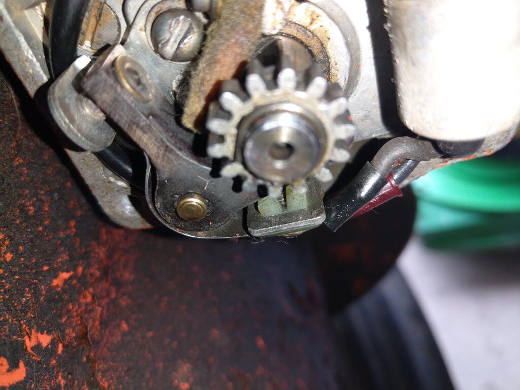

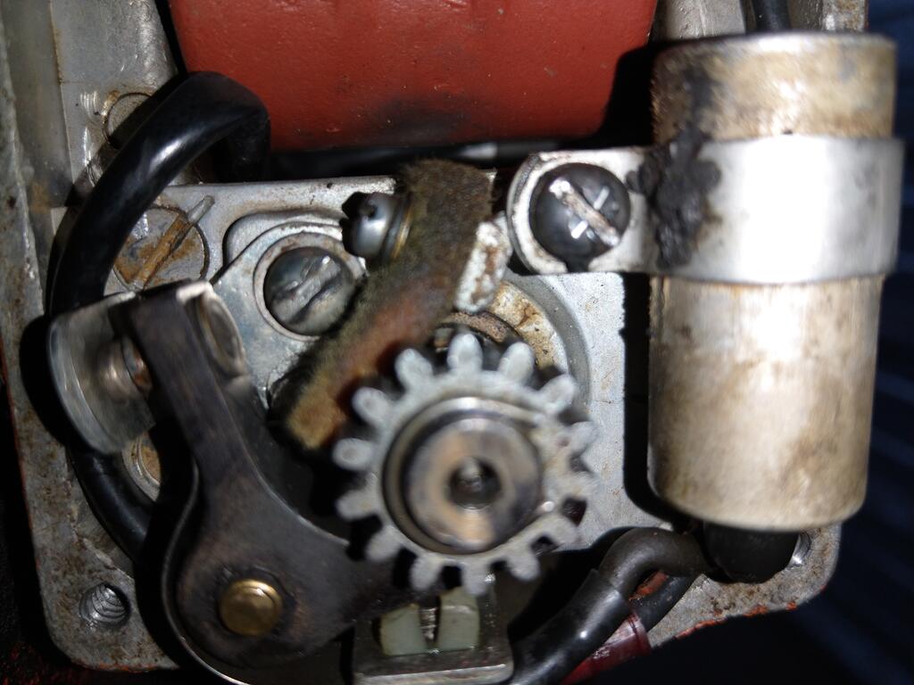

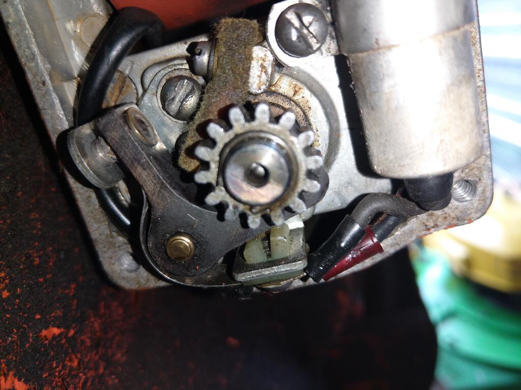

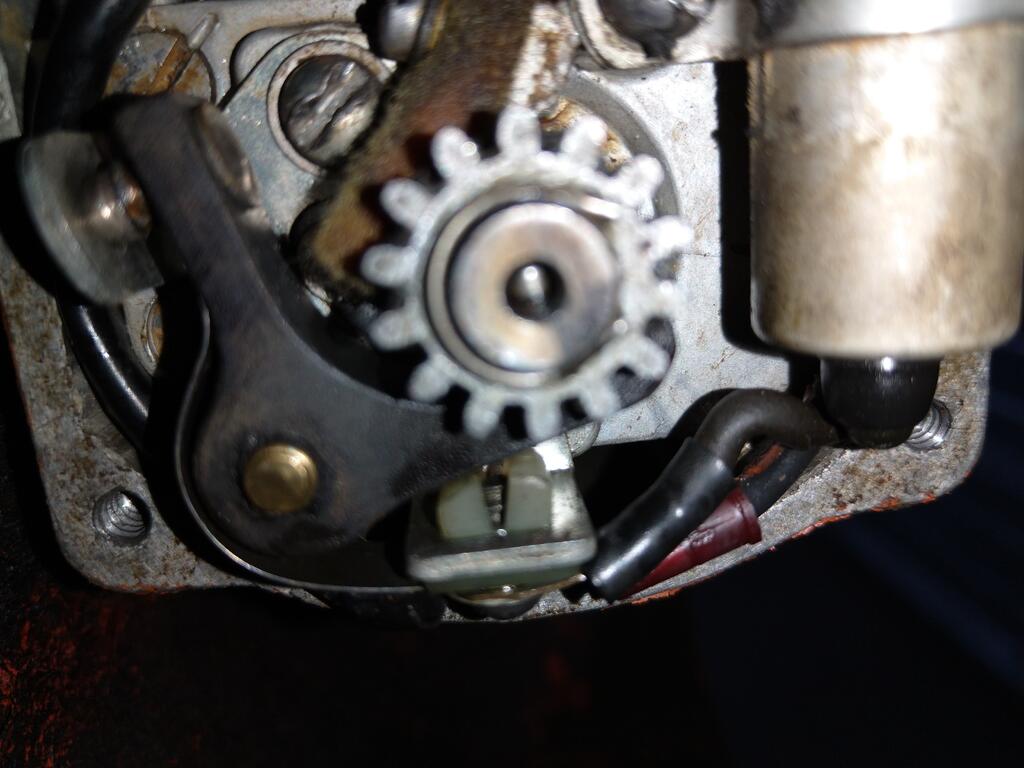

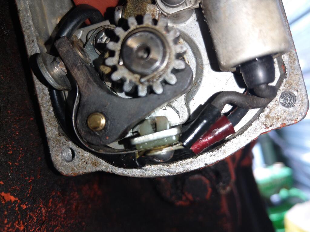

BPEisenhower 553 #1 Posted June 23, 2022 Greetings all! Hopefully someone out there in this vast expanse can be my eyes. Mine are not good at the moment and can't focus on much and need a hand. After figuring out the magneto wasn't timed properly I decided to investigate further. Upon doing so, I can not find a dot, paint mark or the elusive beveled gear that is supposed to be visible. Can anyone else find it and if so, where exactly is it? Thank you all so much and be blessed all of you! BTW, I would try to circle which one is my pick but don't know how to use the phone that well... Share this post Link to post Share on other sites
sjoemie himself 3,106 #2 Posted June 24, 2022 Seems there are multiple dots on the gear but that's probably just dirt? Could you take pictures from another angle and maybe one or two where the gear is in focus? It's all kinda blurry right now.. 1 Share this post Link to post Share on other sites
ACman 7,722 #3 Posted June 24, 2022 Has the gear been off before and put on backwards ? Very hard to tell with the gear out of focus. Just stick your pinky finger in the #1 spark plug hole and give that gear a spin. Let us know what happens when you find it ….. 1 Share this post Link to post Share on other sites
BPEisenhower 553 #4 Posted June 24, 2022 (edited) Finally got a few different pictures and I think it's the smaller discoloration tooth and has a little dirty dot.... At the opening of the retainer ring Just a little history on this tractor is it was sitting 23 years in a garage with a concrete floor. Engine was stuck I believe on one cylinder since only one spark plug was rusty. After soaking for a day, it broke free. Starter does work but lagging. Hand cranking shows compression. Coil has been replaced with the plastic version but spark is intermittent. Probably need to file more and spray electric cleaner again Edited June 25, 2022 by BPEisenhower 1 Share this post Link to post Share on other sites
ACman 7,722 #5 Posted June 27, 2022 Middle picture I can make out a dot about the 6:15 position. If my dad could figure out his smart phone he’d know . If you want I can pm you the number to his store. If he’s there ( he’s 79 ) he’ll pick up. There’s a treasure trove of AC knowledge locked away in his head . Share this post Link to post Share on other sites
BPEisenhower 553 #6 Posted June 27, 2022 Thank you for the eyes! Wasn't sure about the dot and will have to paint it bright for future reference. If I can't get it, a call to your father maybe necessary since mine is 95 and told me I can fix it myself if I can take it apart..... I might have to switch a few plug wires around on a few of his or take the rotor out as an example. Ha ha. Appreciate the help and will get motor spun backwards until dot is at noon position Share this post Link to post Share on other sites
