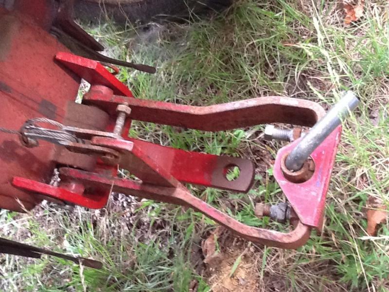

mrharris12 37 #1 Posted June 22, 2022 I think I have seen the answer/post before but am having trouble finding it... My dad wants to keep the clevis hitch on his 414 but he wants to be able to move the trailer he has that takes a 2.25 or whatever it is. He cant use the trailer hitch receiver with the clevis because it seems it will affect the motion of the clevis hitch when he uses the plow and all that. Is there some sort of trailer ball adapter that can essentially be inserted onto the clevis hitch and then taken off when not in use? 1 Share this post Link to post Share on other sites

kpinnc 18,884 #5 Posted June 22, 2022 (edited) Why not use the drawbar hitch (came standard) in conjunction with the clevis? I bored the tongue out from 1/2 to 3/4 on mine and put a ball on it, but it won't interfere with Clevis operation. The pic below isn't mine, but shows how they can mount together. Edited June 22, 2022 by kpinnc 2 Share this post Link to post Share on other sites

mrharris12 37 #7 Posted June 22, 2022 1 hour ago, kpinnc said: Why not use the drawbar hitch (came standard) in conjunction with the clevis? I bored the tongue out from 1/2 to 3/4 on mine and put a ball on it, but it won't interfere with Clevis operation. The pic below isn't mine, but shows how they can mount together. over time that standard bar was bent from the trailer, which was just a 6x10' or around that size 1 Share this post Link to post Share on other sites

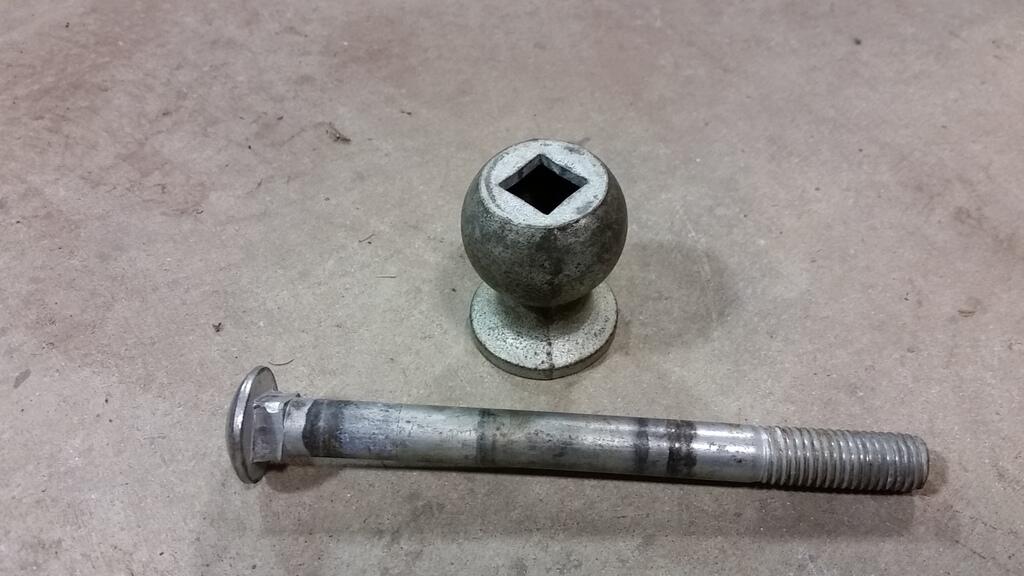

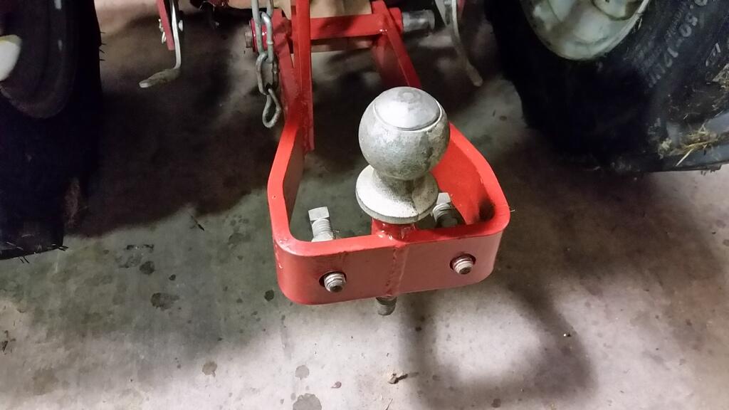

lynnmor 9,009 #9 Posted June 22, 2022 I made a riser for the ball and added a link to the top transmission bolt to take much of the weight. 3 3 Share this post Link to post Share on other sites
war eagle 80 #10 Posted June 22, 2022 (edited) 19 hours ago, kpinnc said: Why not use the drawbar hitch (came standard) in conjunction with the clevis? I bored the tongue out from 1/2 to 3/4 on mine and put a ball on it, but it won't interfere with Clevis operation. The pic below isn't mine, but shows how they can mount together. That wont work without some sort of riser for the ball....trust me. Tailor ball is to low and tailor tongue is interfered with by the clevis hitch. The adapter keeps it simple, just pop it on the clevis hitch when you need a ball or pin hitch. Edited June 23, 2022 by war eagle Share this post Link to post Share on other sites
kpinnc 18,884 #11 Posted June 23, 2022 5 hours ago, lynnmor said: I made a riser for the ball and added a link to the top transmission bolt to take much of the weight. There ya go! I typically add a wider "foot" to the end of the drawbar (like a 3 inch square of 1/4 plate) that pushes up on the underside of the tranny case. If you ever drop a heavy load into the hitch it will spread the load instead of busting the bottom out of the transmission. I've seen several broken that way. 2 Share this post Link to post Share on other sites
lynnmor 9,009 #12 Posted June 23, 2022 11 hours ago, kpinnc said: There ya go! I typically add a wider "foot" to the end of the drawbar (like a 3 inch square of 1/4 plate) that pushes up on the underside of the tranny case. If you ever drop a heavy load into the hitch it will spread the load instead of busting the bottom out of the transmission. I've seen several broken that way. That single point of contact pushing up from the bottom is a real risk, good idea to spread the load. As you can see, I elected to hang weight on the top bolt and it has worked well despite towing way too much weight. Share this post Link to post Share on other sites
kpinnc 18,884 #13 Posted June 23, 2022 45 minutes ago, lynnmor said: That single point of contact pushing up from the bottom is a real risk, good idea to spread the load. As you can see, I elected to hang weight on the top bolt and it has worked well despite towing way too much weight. Smart. Share this post Link to post Share on other sites
