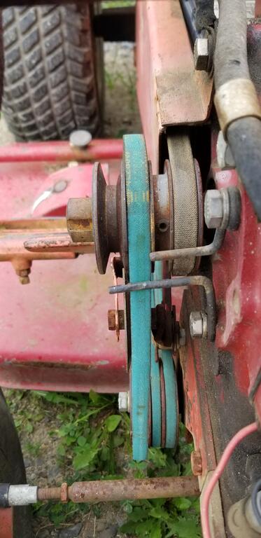

biscuit1088 9 #1 Posted June 21, 2022 hey fellas, i have an 855 that i got without and engine. i put one of them little chinese diesels in but now i dont know what size pulleys the original engine had on it. im getting ready to start making a new pulley on my lathe, does anyone have a picture of what the original engine pulley looks like and maybe some measurements? Thanks in advance Share this post Link to post Share on other sites
953 nut 68,519 #2 Posted June 21, 2022 I'm not sure of the diameter but the inner pully is a 4L and the two outer ones are 3L Share this post Link to post Share on other sites

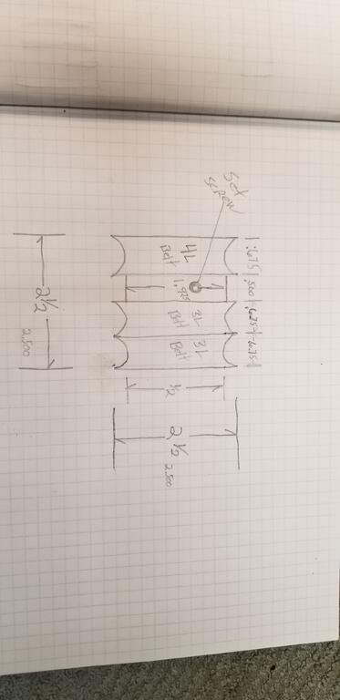

gt14rider 1,278 #3 Posted June 21, 2022 Here's a what I got on my 856, hard to get good measurements on th tractor. Need any more measurements let me know Share this post Link to post Share on other sites
