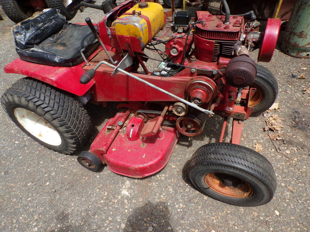

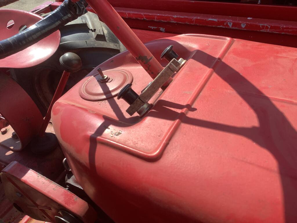

GaryRat 31 #8 Posted June 21, 2022 (edited) Thanks for the replies! I seem to have a poorly adjusted throttle linkage and it is hard to control engine speed precisely. Perhaps there is a tutorial on this website for adjusting the linkage? Also, I'm pretty sure that blade rotation is correct and that the blades cutting edge is correct for the rotation. The beveled side of the edge is on the top side of the blade when mounted. The rear of the deck is open to allow for discharge and the blade spinning in the directions they are would facilitate rear discharge. This machine has a gear driven deck so only one belt from the PTO to the deck. Perhaps it shouldn't have a gear driven deck but it does and it seems that is proper for this machine based on the pulley arrangement and all. I'll get some pictures up today. Edited June 21, 2022 by GaryRat Share this post Link to post Share on other sites
Pullstart 71,366 #9 Posted June 21, 2022 I found a picture from one of your earlier posts. Normally they had a larger belt driven deck. It would be nice to see the other side of the tractor… Share this post Link to post Share on other sites

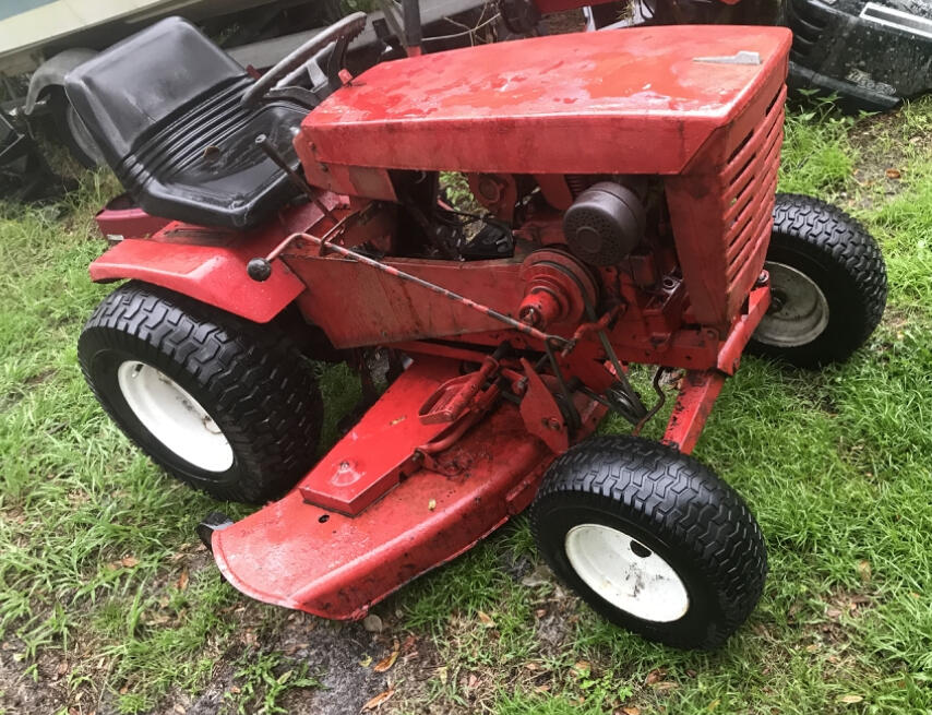

Pullstart 71,366 #10 Posted June 21, 2022 This is a picture of what deck was typically on your machine… Share this post Link to post Share on other sites

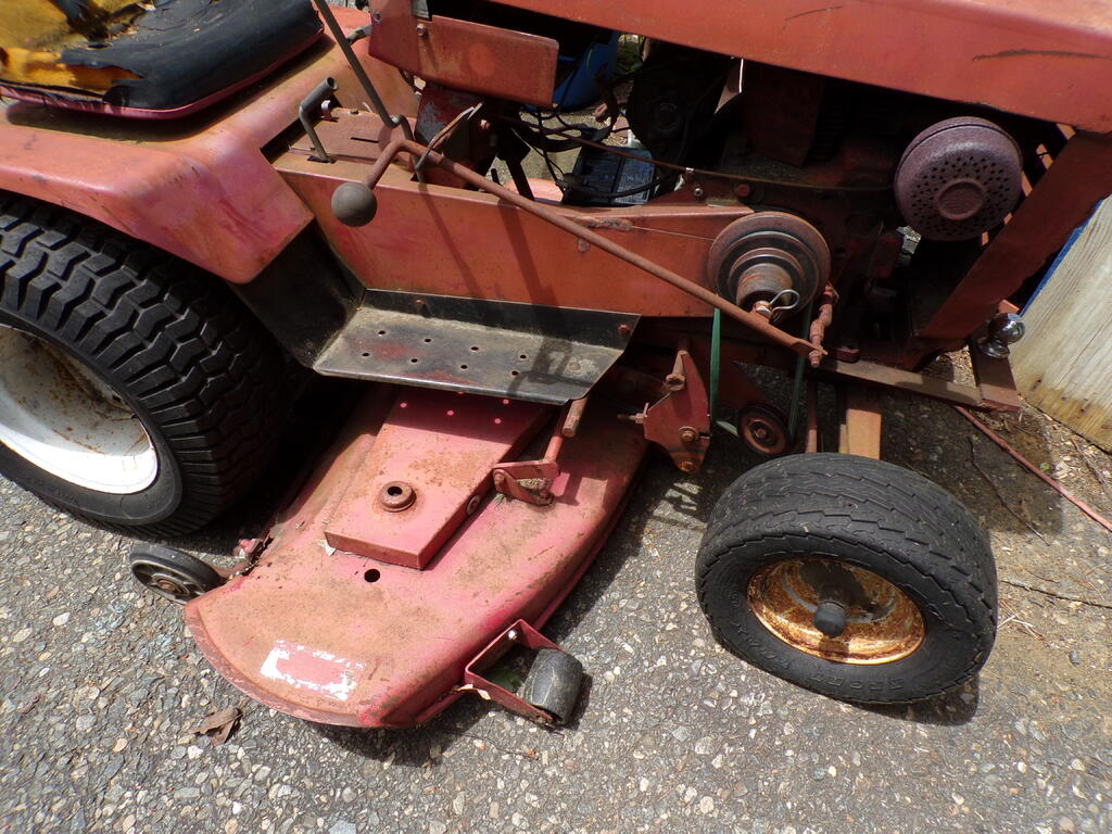

GaryRat 31 #16 Posted June 21, 2022 Pullstart, that is the deck on my 1968 Charger 12. It is in rough shape and needs straightening, welding and new spindles. It is why I snagged the 1277 as it was in overall better shape. First two pictures are of the 1277 (at least that is what the decal on the hood says) the third pic is of the Charger 12 deck/pulley arrangement. 1 Share this post Link to post Share on other sites
Pullstart 71,366 #17 Posted June 21, 2022 The pulley setup on the first two pictures @GaryRat are custom for sure! I bet that deck is zinging blade top speed though at WOT! The drive pulley in a normal gear drive deck is about 2” so you’re right around double! Share this post Link to post Share on other sites

GaryRat 31 #19 Posted June 21, 2022 Nothing on the 1277 looks custom to me. All the brackets shafts etc. look like factory made stuff to me. If they are "zinging" why don't they cut? As far as custom stuff goes, I like the floorboards the Charger 12 has and would like to fabricate something similar for the 1277, if I can get it to cut. Share this post Link to post Share on other sites
Handy Don 17,562 #20 Posted June 21, 2022 15 minutes ago, GaryRat said: Nothing on the 1277 looks custom to me. All the brackets shafts etc. look like factory made stuff to me. If they are "zinging" why don't they cut? As far as custom stuff goes, I like the floorboards the Charger 12 has and would like to fabricate something similar for the 1277, if I can get it to cut. The 3-blade, belted deck was available on late short frame tractors with an optional kit to use the "bell" PTO. Looks like you have one of those! Share this post Link to post Share on other sites

GaryRat 31 #22 Posted June 26, 2022 Tried mowing today with the rpms up and maybe a slight improvement in cutting but still not good. The comment about my blades zinging along because of the large pulley actually points out what may be the problem. The six inch pulley that is on there now would mean the blades were spinning much slower than they should if the correct pulley was indeed smaller. The way it is now I am essentially 1:1 Motor rpm = blade rpm. Do I need a smaller pulley? Share this post Link to post Share on other sites
Handy Don 17,562 #23 Posted June 26, 2022 (edited) On 6/21/2022 at 12:06 PM, GaryRat said: . Is this the setup that is misbehaving? Those 2-blade, geared decks would normally be driven from a 2.5" engine pulley to the 3" outer groove of a 3-groove pulley. So 2.5:3 is a slight step down. The other two grooves look like 3.25 and match the 3.25 on the deck drive shaft so 1:1 there. It looks like the extra large pulley on the deck input shaft is there to provide the same step down but from the larger (4"?) PTO bell pulley. To get the same ratio the lower pulley should be 1.2x the upper pulley (4 x 1.2 = 4.8"). If you have a 6" pulley, the blades are turning about 20% slower than they should. Edited June 26, 2022 by Handy Don Share this post Link to post Share on other sites
